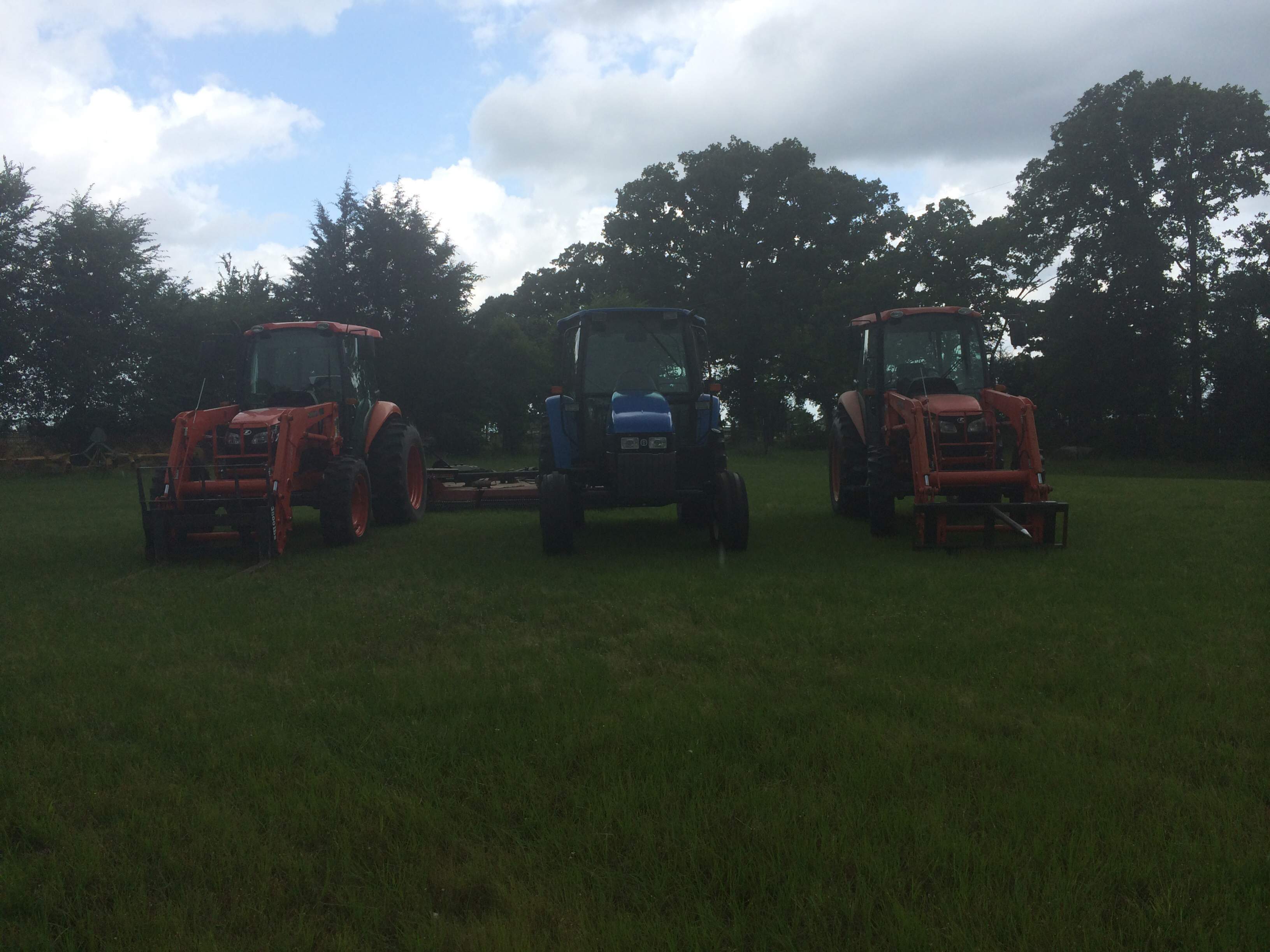

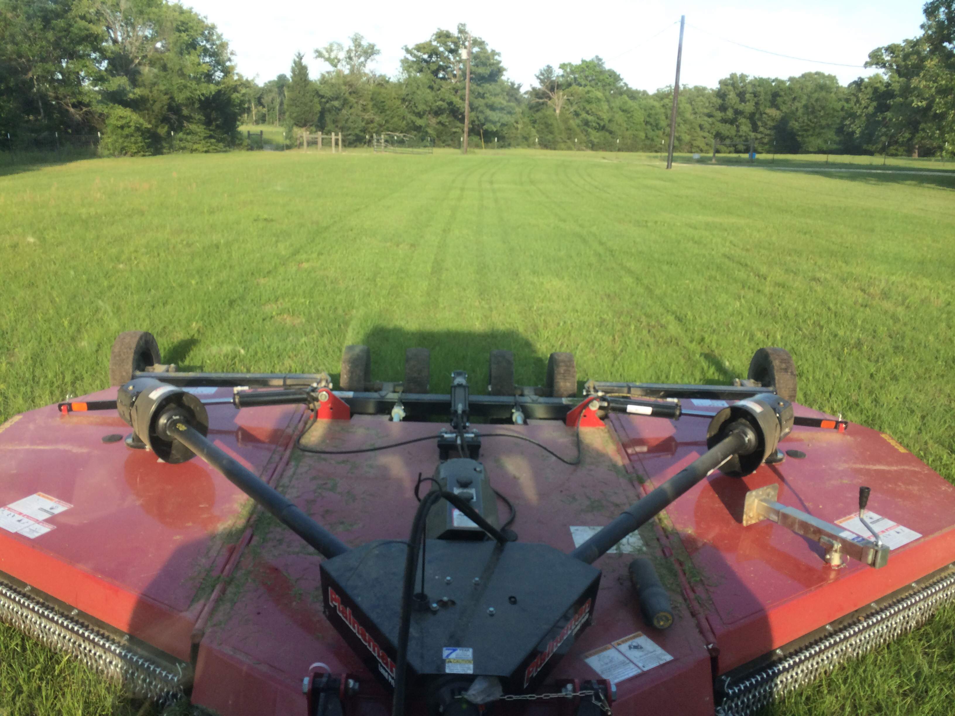

I think I weight somewhere around 8000 lbs(on Kubota)with fluid in tires and loader on. image.jpg I just bought the NH TL100(weight on it closer to 11,000lbs with front weights)to do the mowing and pull baler.
