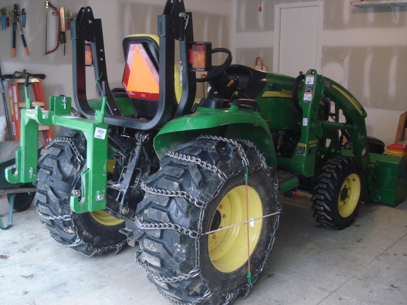

I said that chains were in my future ---- I got them just in time for the winter that never was to be over! I did rotate the rear wheels to the wide position, and the chains still need a little adjusting and tightening -- but I think they will make a big difference.

Nice set of chains. Should make a huge difference in clearing snow. If even more traction is needed you can add weight to the wheels, add fluid to the tires or both (if you haven't already). Or, then again, you could cut the blade to shorter length. At any rate you have a good rig to move snow and it could be made better if necessary. :thumbsup:

Thanks Sunnyside360! Ballast hasn't generally been a big issue -- my only traction problem was on the steep gravel slippery drive -- the one time. Part of that may have been because the rear blade I was using wasn't as heavy as my ballast box.
