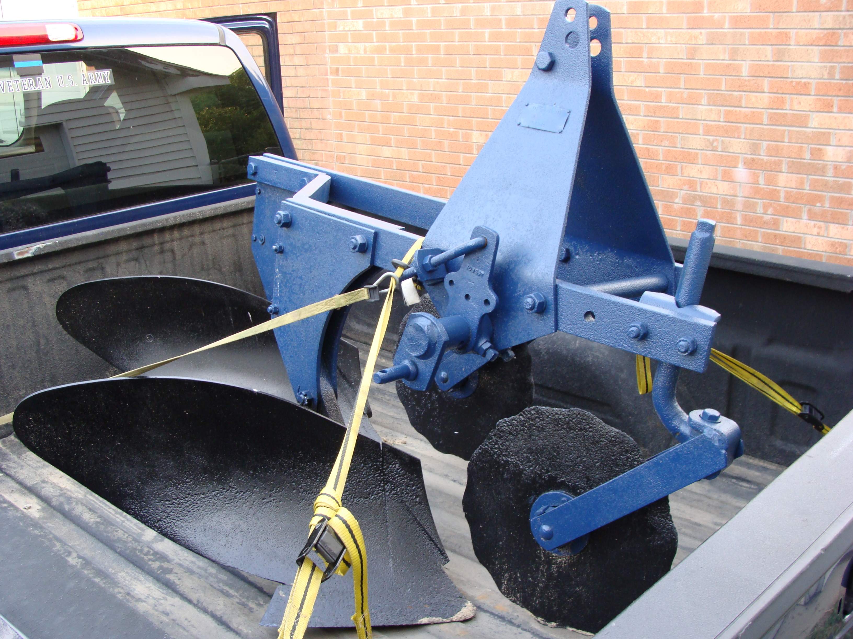

I got the plow Friday and tried it out yesterday (see photo).
I'm sure they painted over all the rust but it looks nice.
I think it's a 12 inch; haven't measured.
I had no problems pulling the plow through the clay.
There was no tire slippage with the R4's but the plow wasn't going as deep as it should.
It would lay the grass over but I couldn't get it to go any deeper.

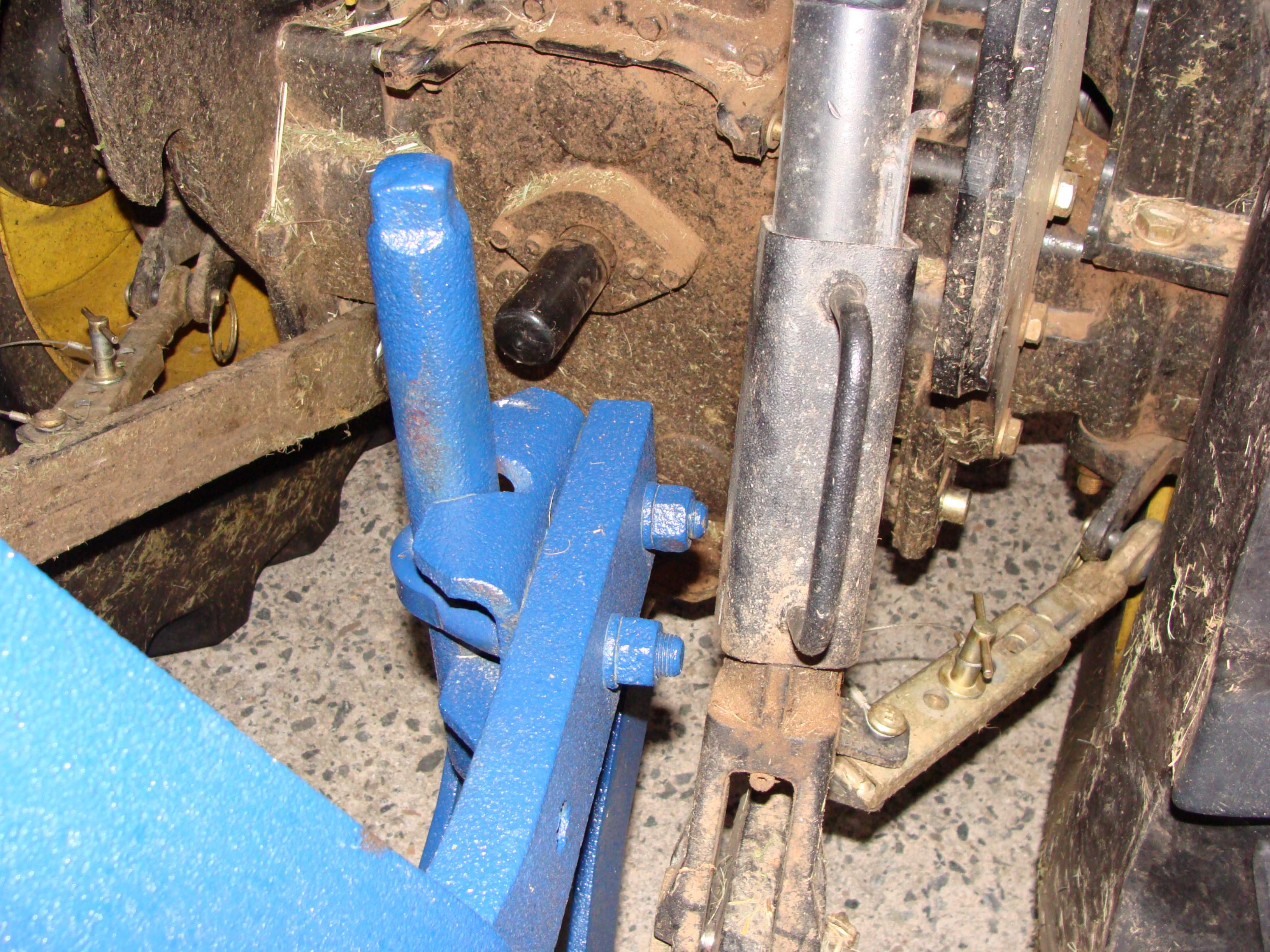

I do have an adjustment issue as Cowboy had with his Dearborn; the bolts for the front coulter hit the right arm; so I tinkered with the adjustments and have it just clearing the arm (see photo). I had to remove the PTO shroud for clearance also.

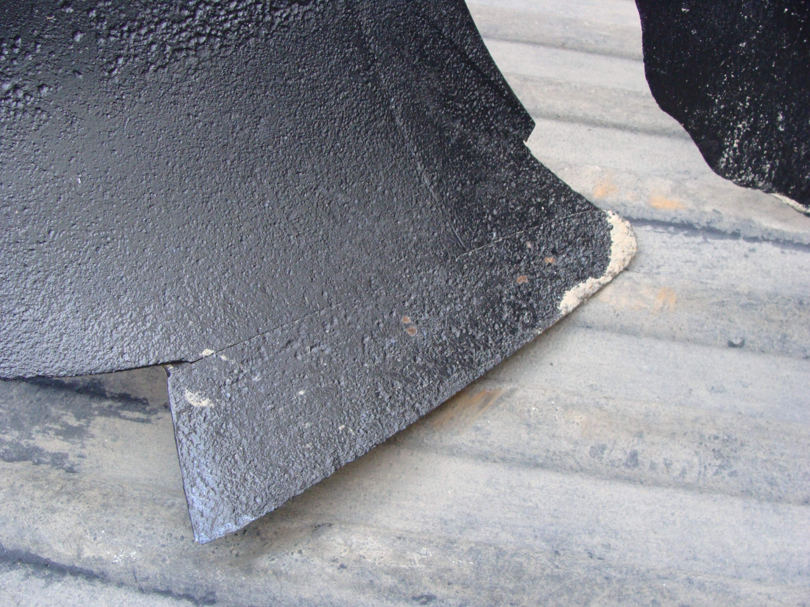

I think I'm going to need new shares (see photo). Would that help with cutting into the ground deeper?

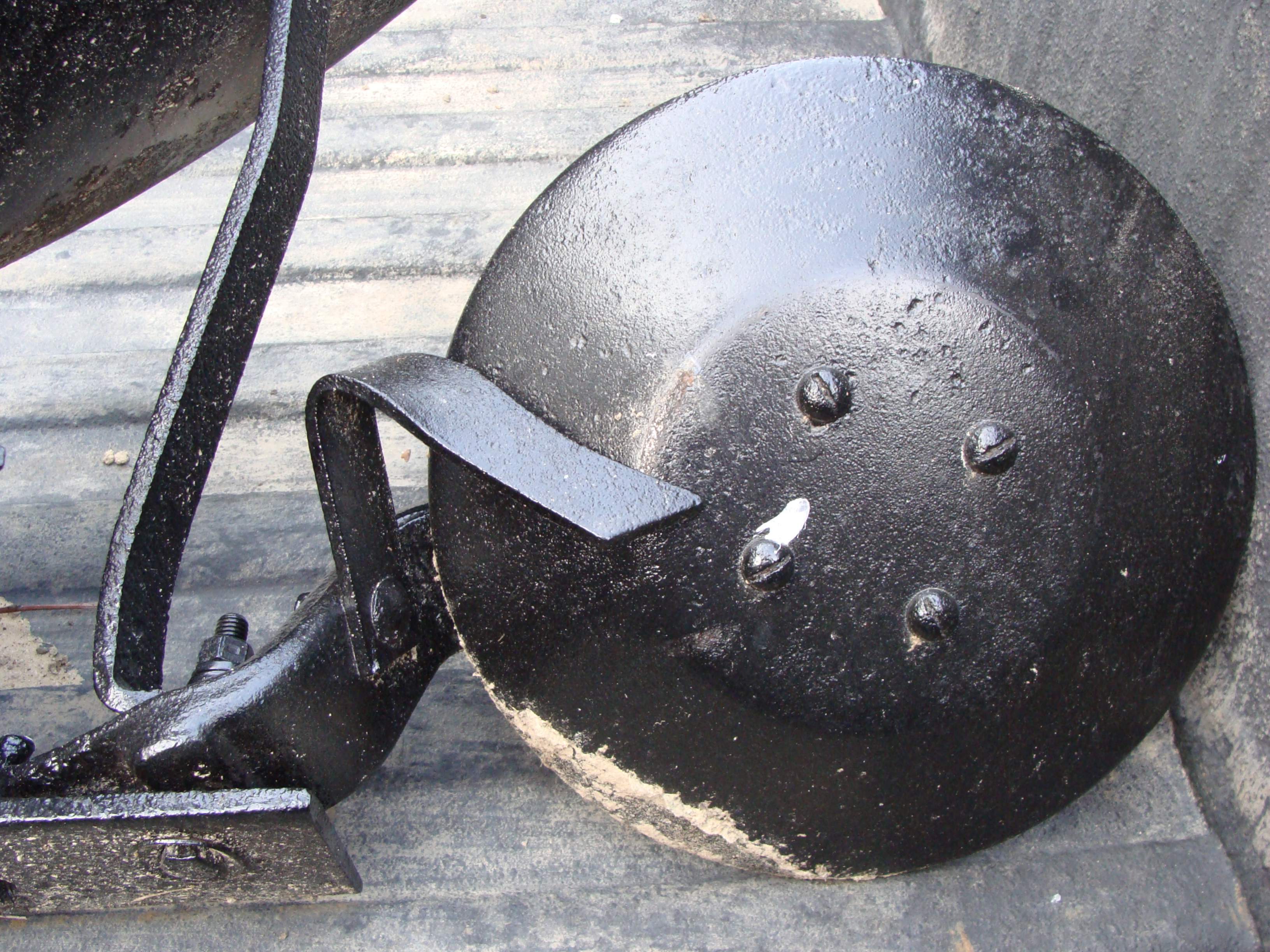

And what is that round disc in the back of the plow supposed to do (see photo)?

The round disk in the back is the leveler. It's used to help set the depth of the furrow. It should be adjustable up/down. These are common on the older plows since many of the older tractors didn't have draft control. If you have draft control, you really don't need the leveler. The round disks in front of the moldboards are coulters. These cut the soil to help the moldboard turn a clean furrow.
