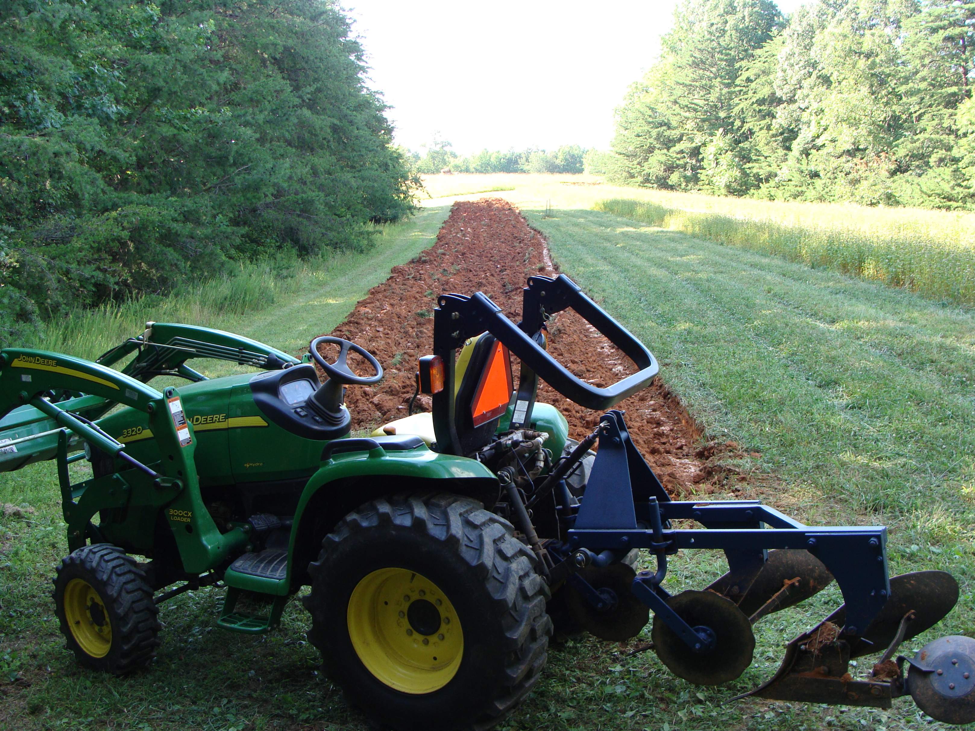

Here is the results of the new plow shares and shins.
Hopefully the video works.
YouTube - MOV00834.MPG
It's a neat thing to watch the grass get rolled right over and disappear underneath all that dirt when things are hooked up and set right. It took a bit of playing with all the adjustments but I think I'm pretty close. If the audio works the squeeking sound you hear is the rolling land slide actually working.
There's nothing like working in the dirt!!

Beautiful.
