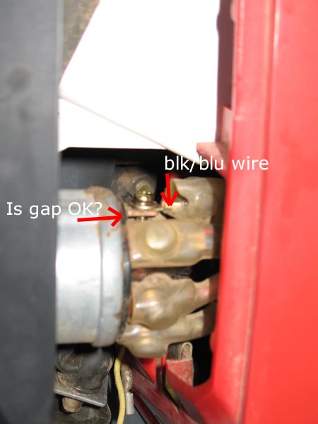

   / Can an old lady get her MF1250 to start? #139
Isn't the gap on the ignition switch terminal caused by the screw being loose? I would tighten the screw and see if it starts.
I think she means there's a gap between the terminal and switch. The angle of the picture makes it hard to tell what's on there.

:cool2::cool2::cool2:IT WORKED!!!!!!!!!!!!!:cool2::cool2::cool2:
I ran a wire from the solenoid to the blk/blu ignition terminal (kept the original wire on the terminal). And...wait for it....
IT STARTED WITH THE KEY!!!!!!!!!!!!!!!!
How happy is this old broad? Can we say ECSTATIC!!!!
:yes: :jump: :cheerful: :dance1: :laughing:
The wire isn't routed yet and there are things to put back together, so I can't drive it. But, until I get the service manual and figure out where and how to get to the safety relay, this fix is awesome!!
