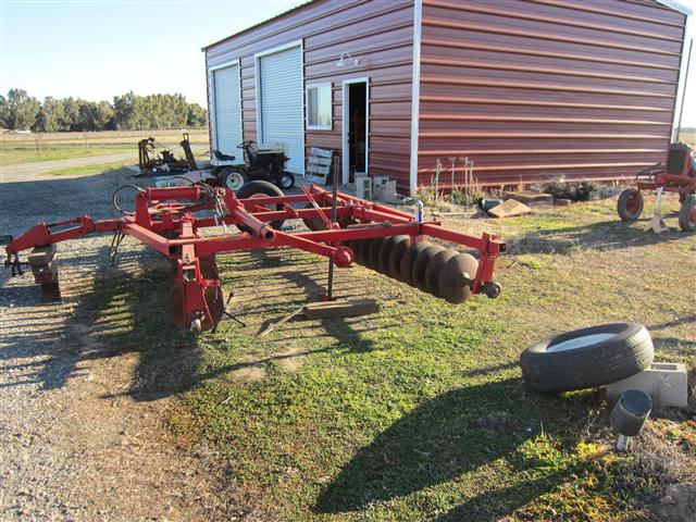

There is no simple answer. Is the disc a three point hitch model or a tow behind with hydraulics. Is your tractor four wheel drive? How heavy is your tractor? Are your rear tires loaded? Are your tires good? How wet is the soil? Disking is affected by all these. I pull a big offset disc 20 x 22” , with my 70 horse 4wd Kubota, that weighs 4000 pounds. It works great, but it’s all my tractor can handle if the soil is wet. But I can raise it (to decrease depth of cut) to compensate if it starts to bog down. Of course removing a couple of discs will reduce resistance. So most likely, you’ll be ok. Nothing is worse than a too light disc on hard ground. It just won’t “bite” and it takes multiple passes. As another said, many people have to add weight to make a cheaper, lighter disc cut. I had a 20 x 20” three point hitch model that weighed about 800 pounds, and it was not very effective on ground that had not been plowed.
With my big disc, plowing is not necessary. It will break up hard ground. I only bog down if it’s too wet. IMG_0144.JPGIMG_0150.JPG

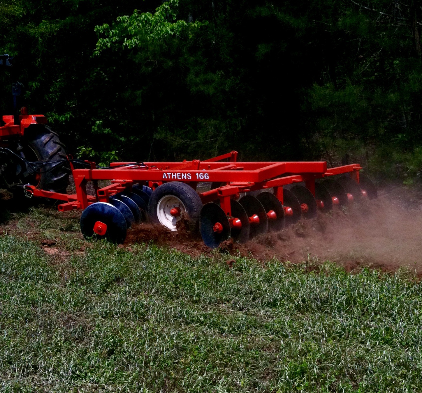

Newbie here. Bought a second hand 75hp. I reckon I should be getting a 16 x 24 disc harrow.
There is a great deal on a 20x24 second hand which I know is too much.
Any experience or recommendation if I can get the big harrow and remove 2 discs each row (one on both sides)? Thanks in advance.
Sure you can. I modified a 12-ft wide wheel disc to about 9-ft wide by removing the two outer discs on each axle.
Good luck
