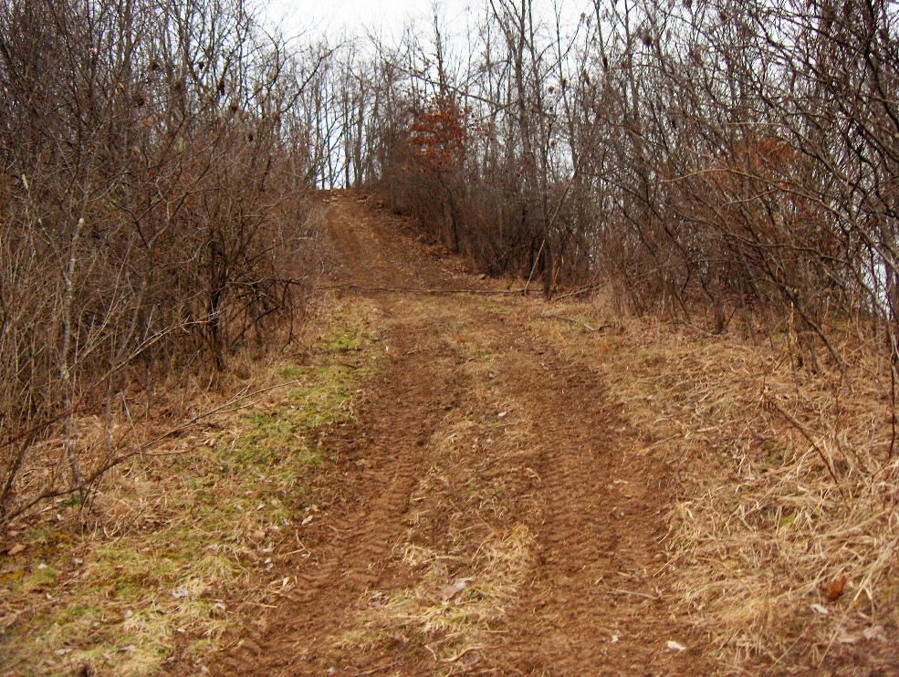

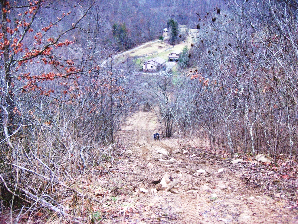

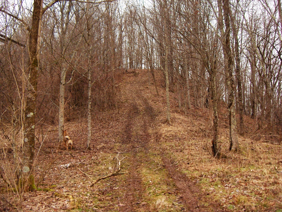

I took the L4400HST With the 7'BB and the FEL on up the steeper trail I use to access the ridge and I measured the slope it was 27 degrees at the steepest with the majority being 25 degrees and I used a magnetic base angle finder. Here are a few pics of the hills. The first is looking down, the 25 degree and 2nd is looking up the 27 degree, the 3rdis looking up the 25 degree. The hills have very little grass and I grip decent but if it were steeper I would have chains on all four tires.

So I used these 3 instruments to meassure the inclination:
The angle where the 4700 was parked in those inital pics was 22 degrees.
I took about 10 meassurements from that position to the bottom of the hill, and they were all in the range of 30 - 36 degrees, generally getting steeper the further down I went.
So not quite the 40 degrees I guesstimated, but pretty darn close!
