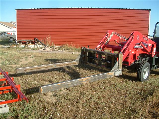

45 acres is a nice size hayfield. If you drop the bales on the ground, then you'll need to find a bale stacker or some kind of bale accumulator/bale grapple to get them onto flatbeds.

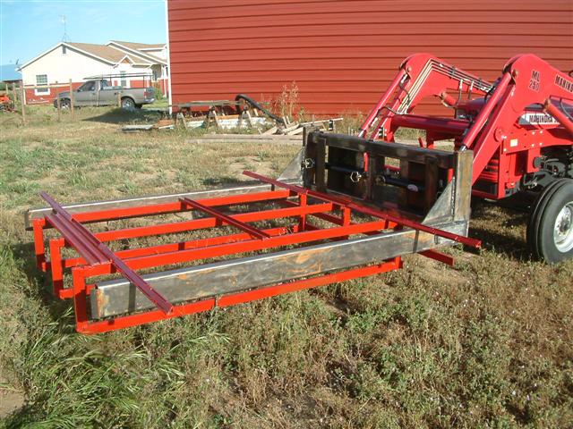

For my 10-acres (6 acres in oat hay), I built a combination accumulator/squeeze for my Mahindra 5525 (54 hp engine, 45 hp pto, 2WD, gear tranny) to round up small squares from my MF124 baler.
It was a winter welding project (just to see if I could fabricate something like this)--about $1.5K invested in steel and hydraulic parts.
For your 45 acres, I'd look for a used self-propelled New Holland bale staker.

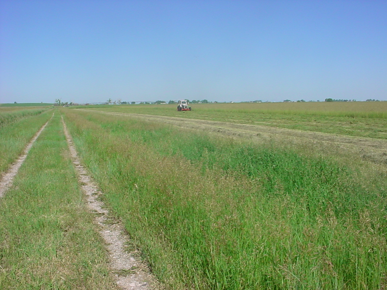

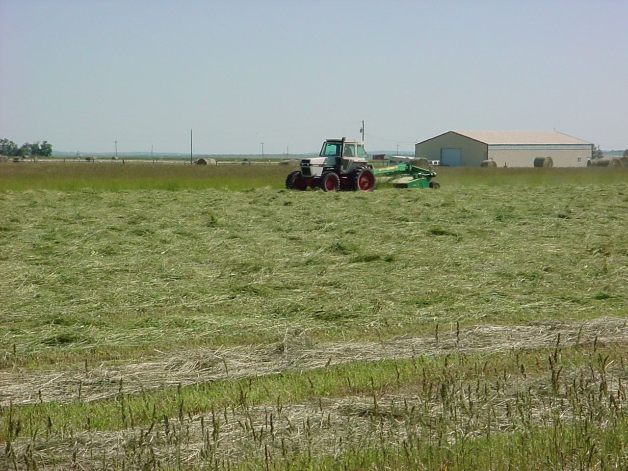

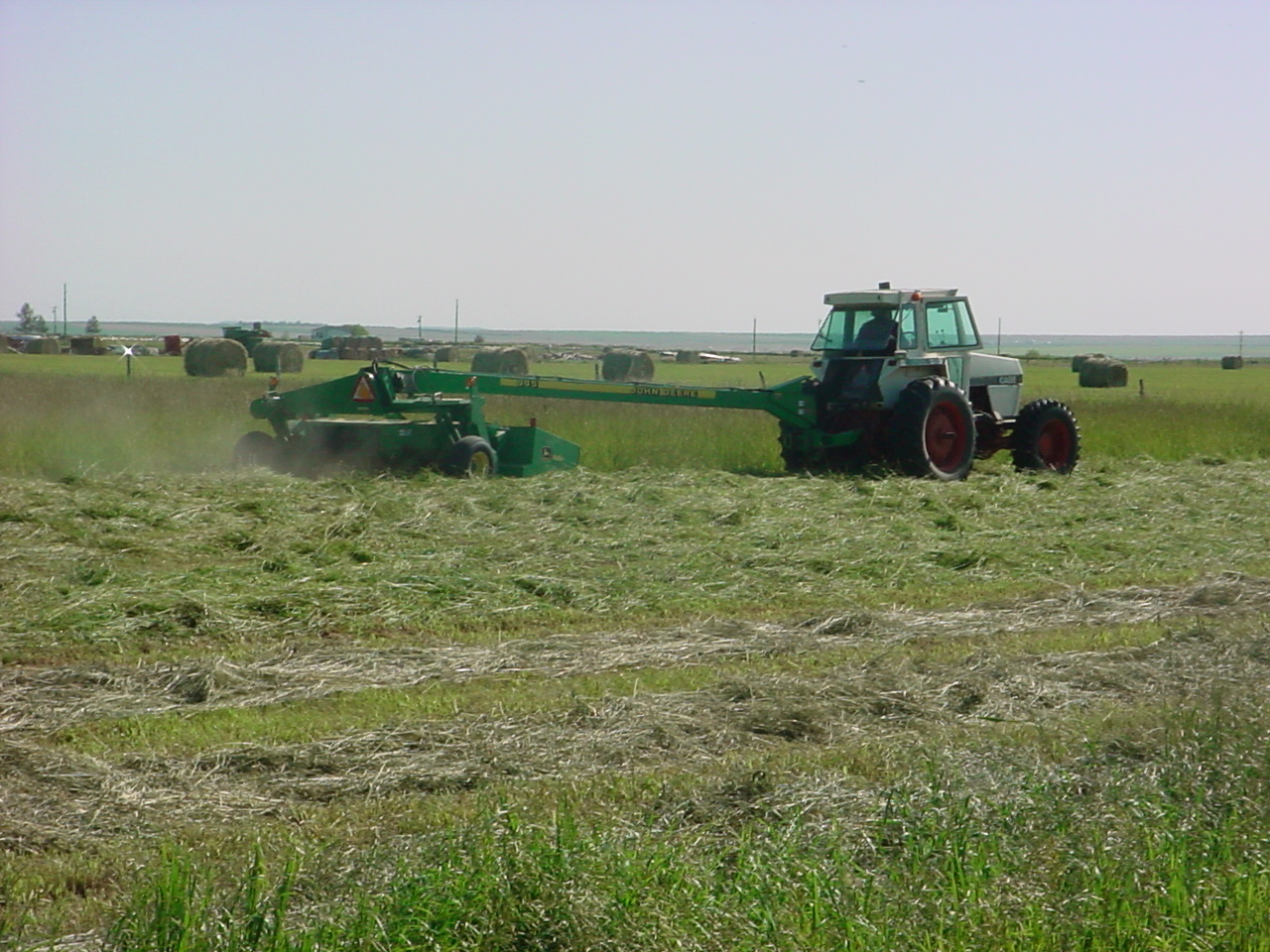

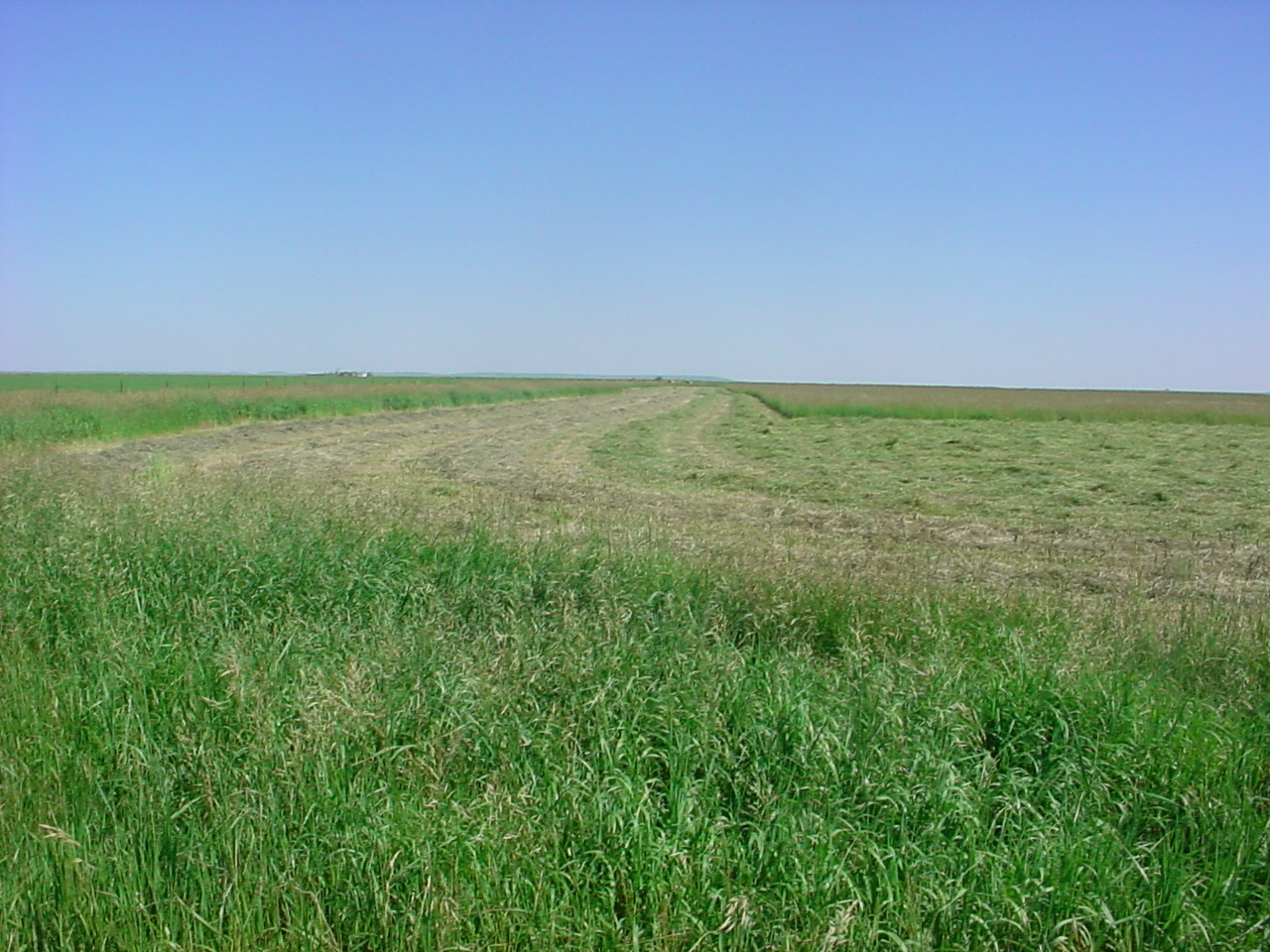

Sorry it took me so long to get back to you guys on this topic. Just wanted to let you all know I found my best solution for the time being. I found a guy to cut and bale for me on 50/50 share. Until I am ready to go with a bigger tractor I will be doing this.
I would rather do it this way for now than to put so much wear on my small unit. I don't mind working it hard but I think I would be putting way too much work on it with the amount of hay I am doing. This field will produce close to 3000 75lb square bales and even more after I redo the field in a few years.

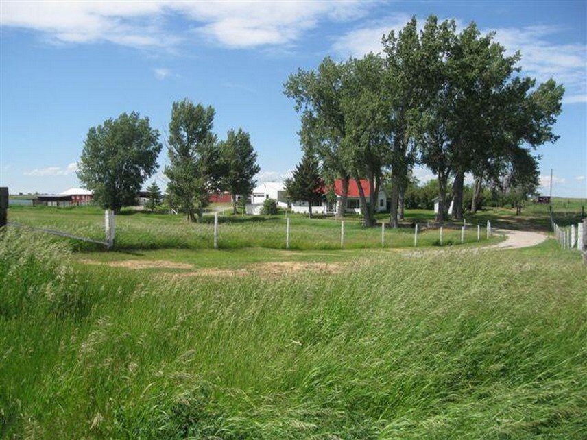

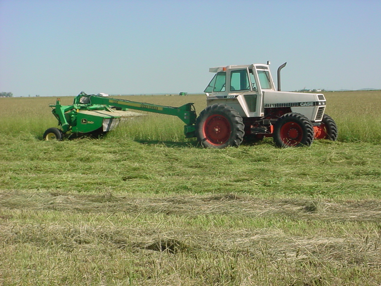

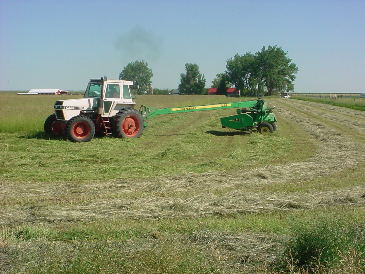

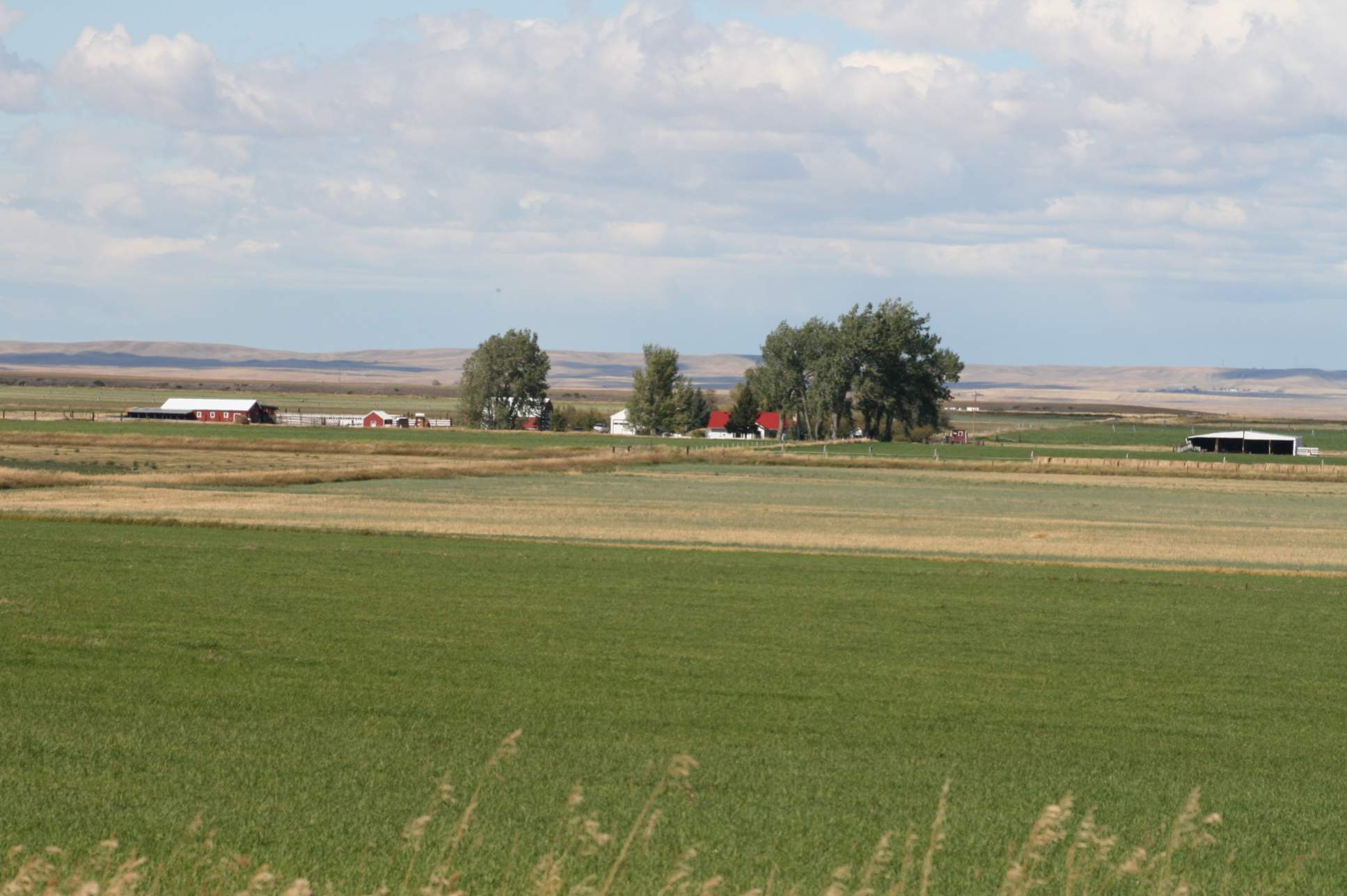

Below is pictures of the guy cutting my field and a few bonus pics of my place. We will be baling it today or tomorrow . Thanks for all your suggestions and opinions. By the way , the tractor is a Case 2290 with a John Deere 945 Pull Behind Cutter . He just rebuilt the JD 945 and he says he's very pleased with it. It really made easy work of my field , that's for sure.

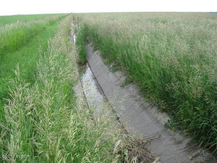

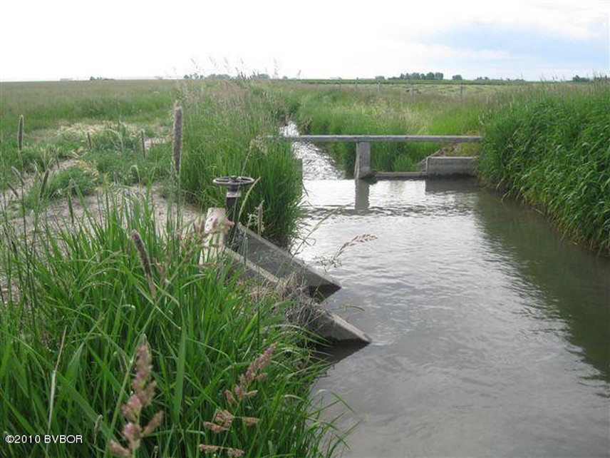

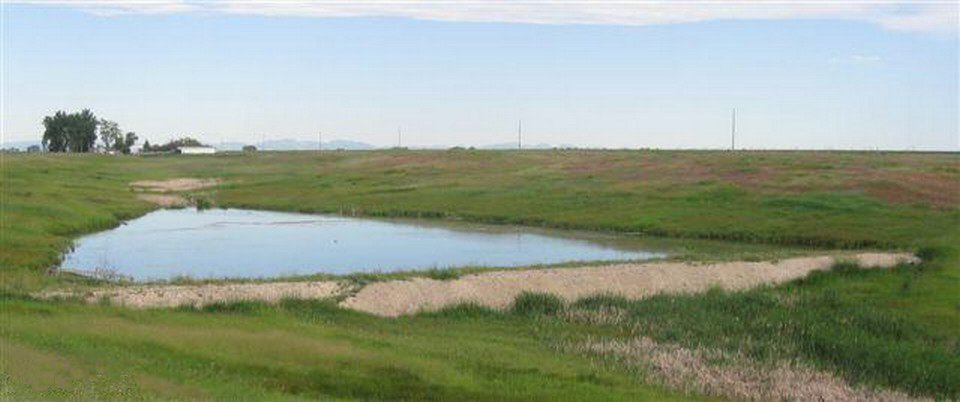

My field has concrete flood irrigation with about a dozen water release gates. Combination of Orchard Grass and Alfalfa . My place has 75 acres total with the 45 acre hay field, 4 grazing pastures, including a natural spring feeding a man made pond. We are adding a new 90'L X 65'W Barn with 5 Stalls and Tack Room and the rest will be open for Hay storage. I am running 28 head of horses with 6 new foals this year . Enjoy the pics guys.

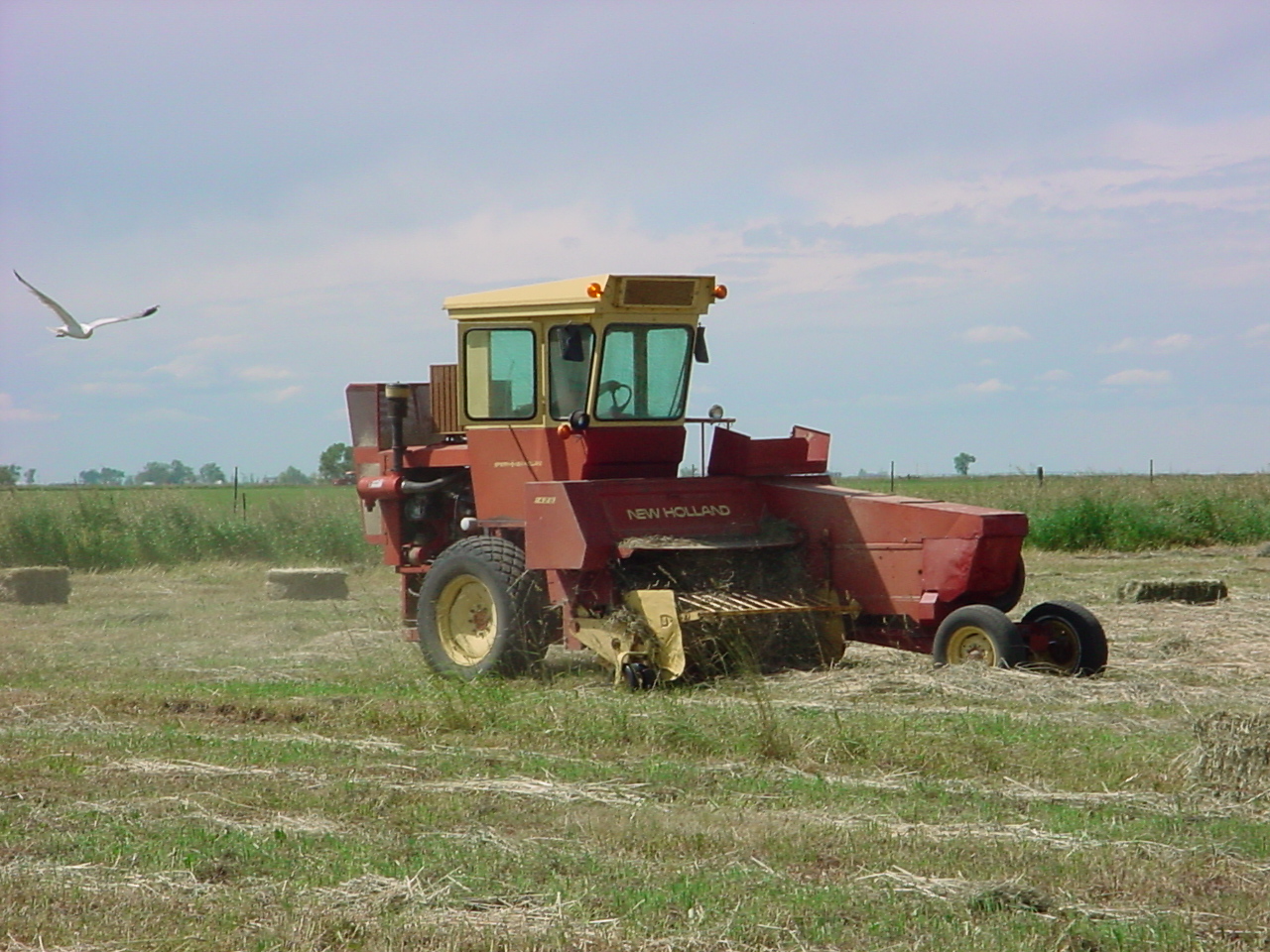

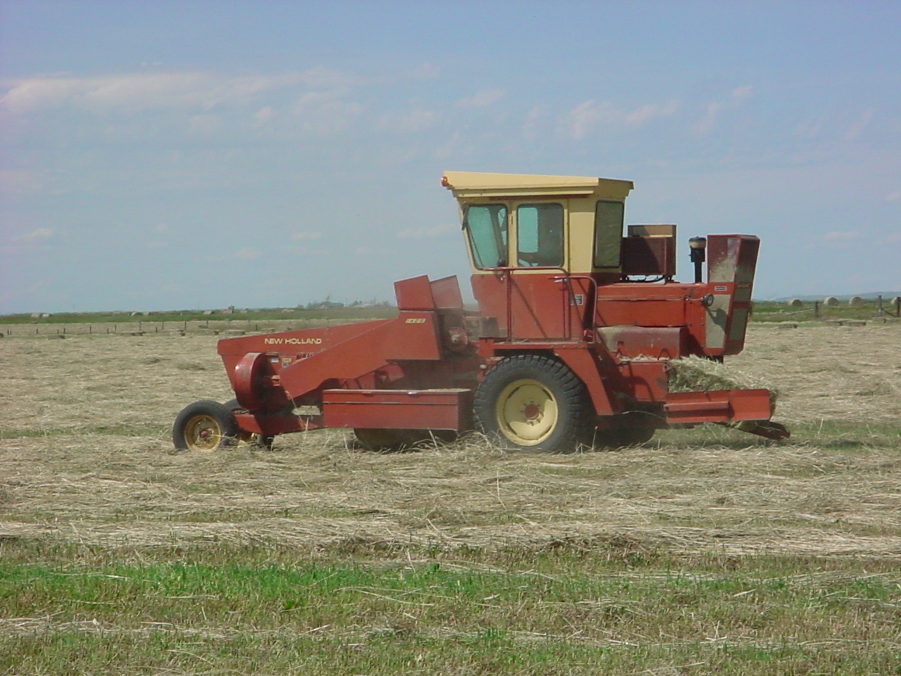

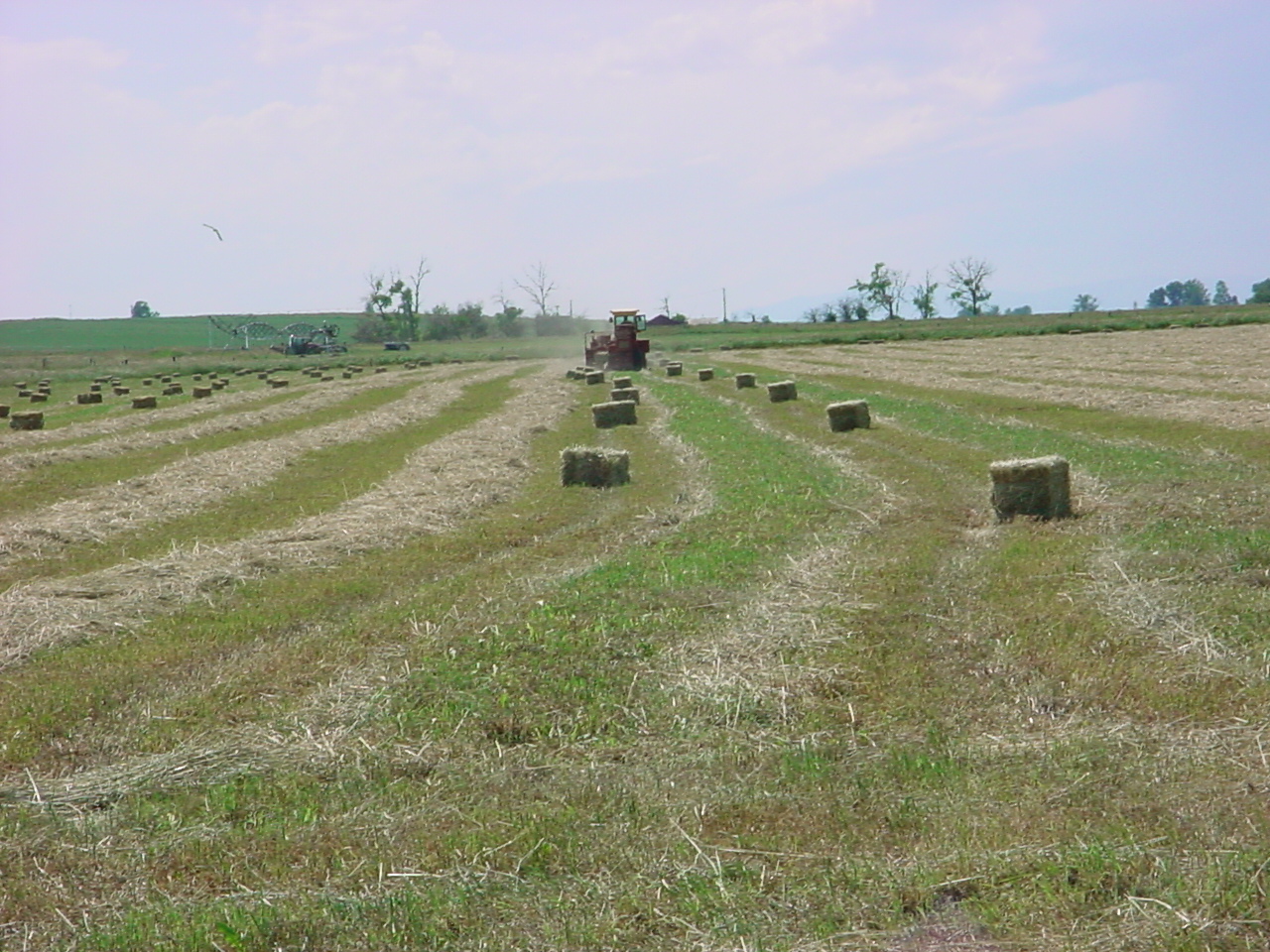

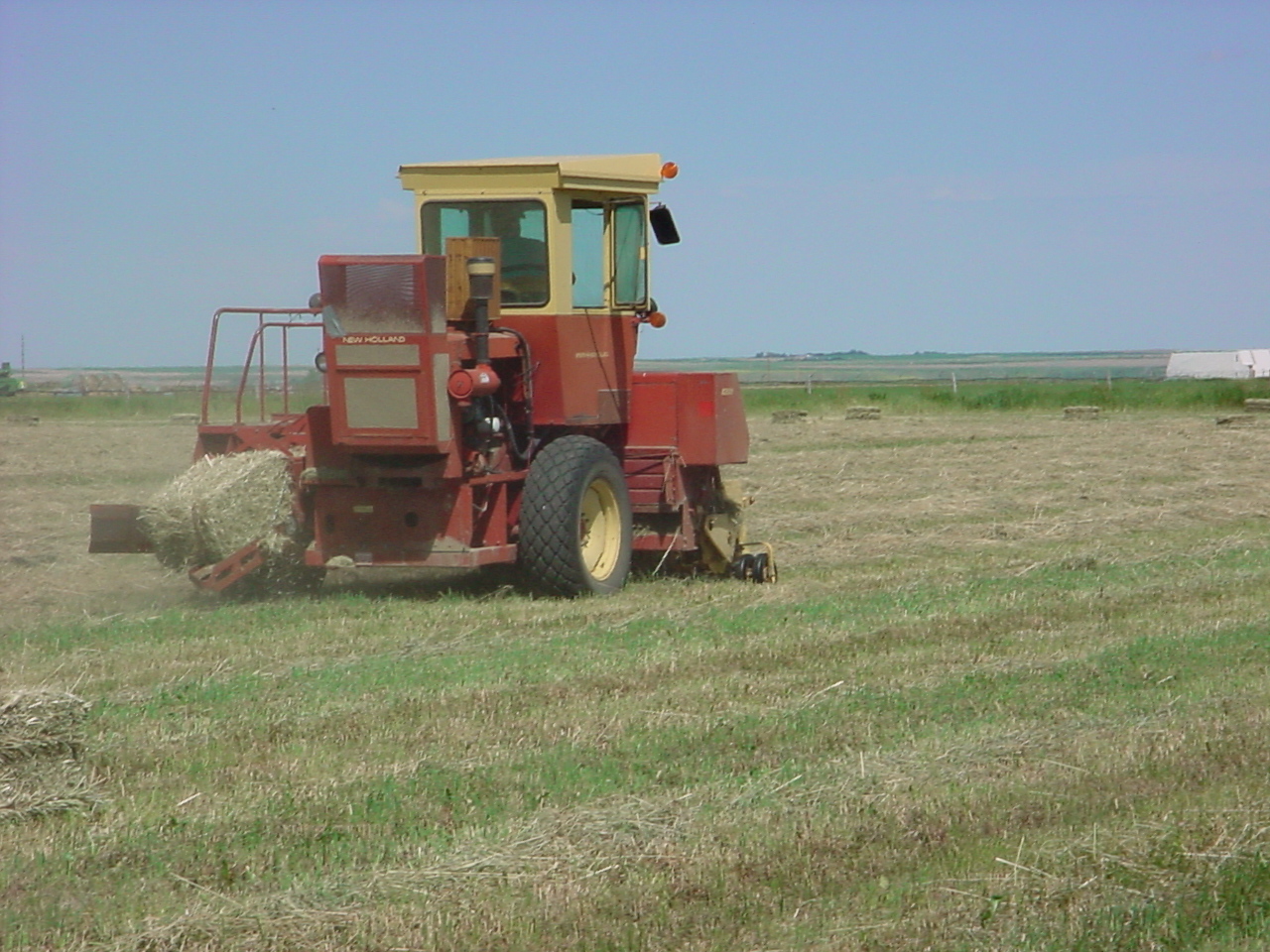

Anyway , we started baling the field now and it will be done tomorrow. After getting it up we will get on to flood irrigating for our 2nd cutting. Should be interesting working with the irrigating. I can't wait to get started on that. Below are a few picks of my hay guy baling with his New Holland Baler. It's an older baler (I think 1980ish) I think a model 1440 and it's doing a pretty good job. Not bad for a $700,00 Baler.
Our hay guy buys mostly older equipment and fixes it up and he is really good in all aspects on mechanics. I hope to learn quite a bit from him. Anyway, here are the pics. Enjoy! :thumbsup:
