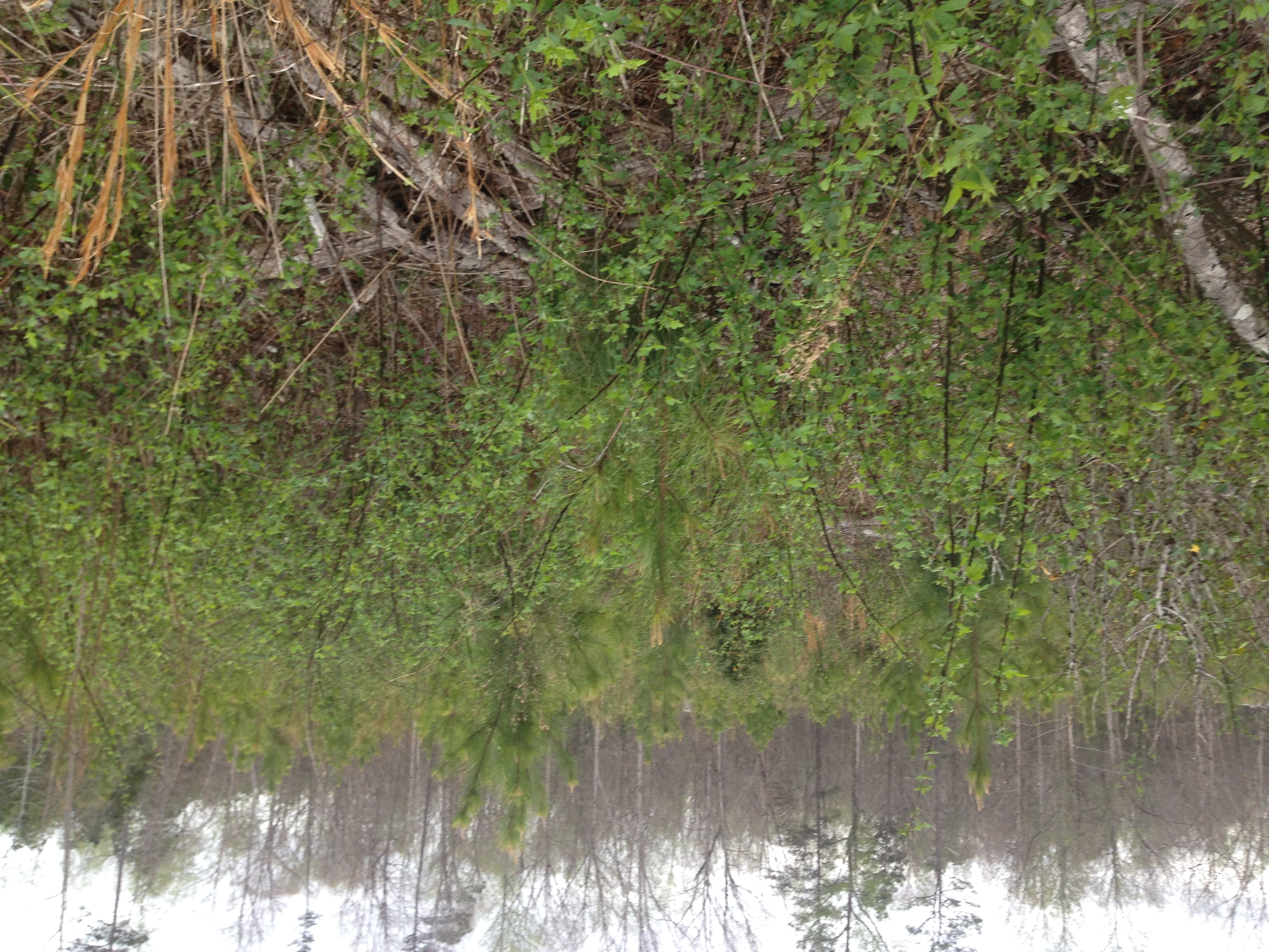

That is a very nice rotary cutter! Have you ever had any issues cutting through thick brush?
I bought it to use on some land I have that has loblolly pines and briars growing in it. I have been running over 6 foot pine saplings, brush and 8 foot briars with it. Cuts it and nothing is left. I run it in low range and take my time in the real thick stuff. This is a picture of the land I have been cutting with it.

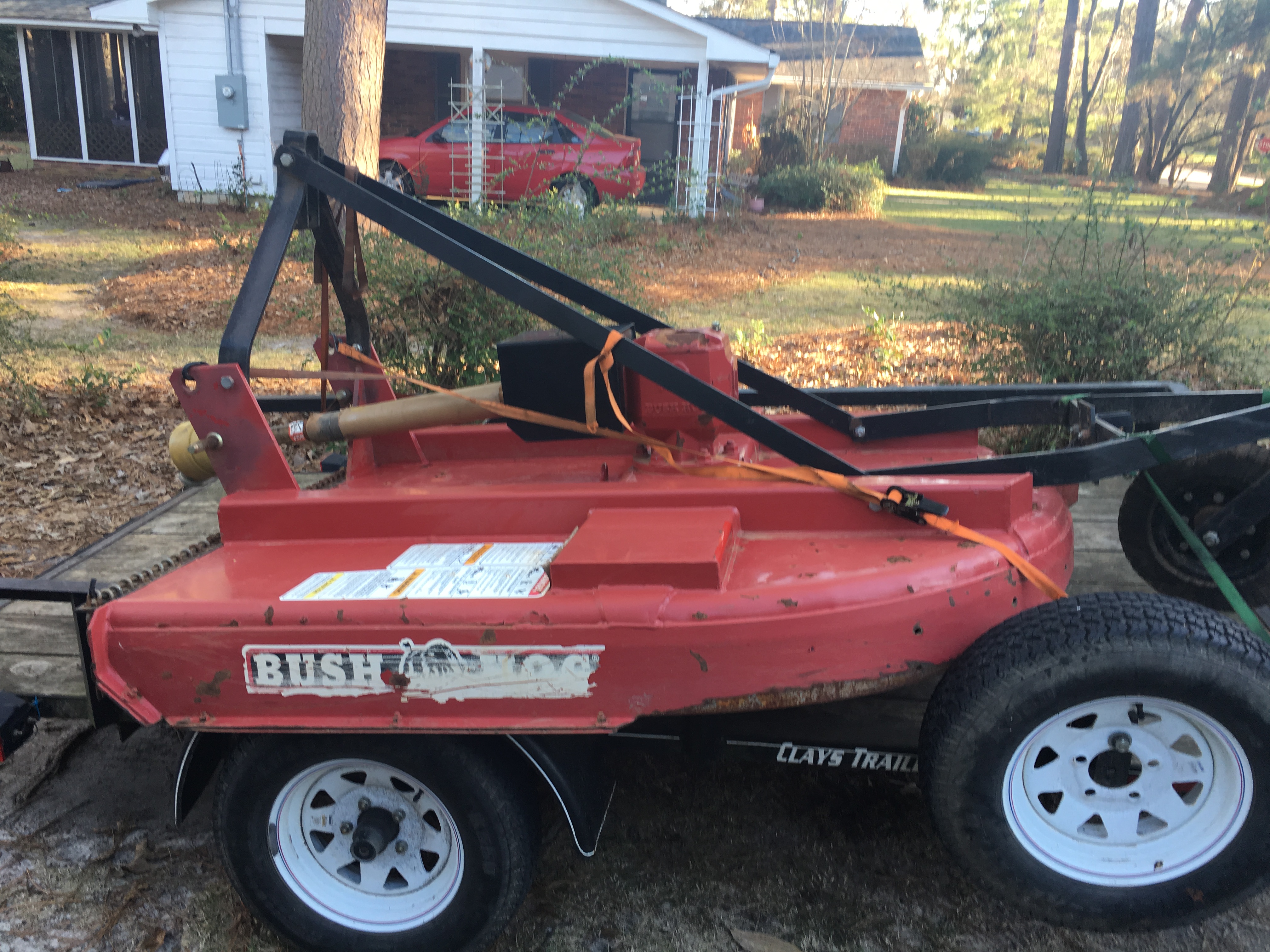

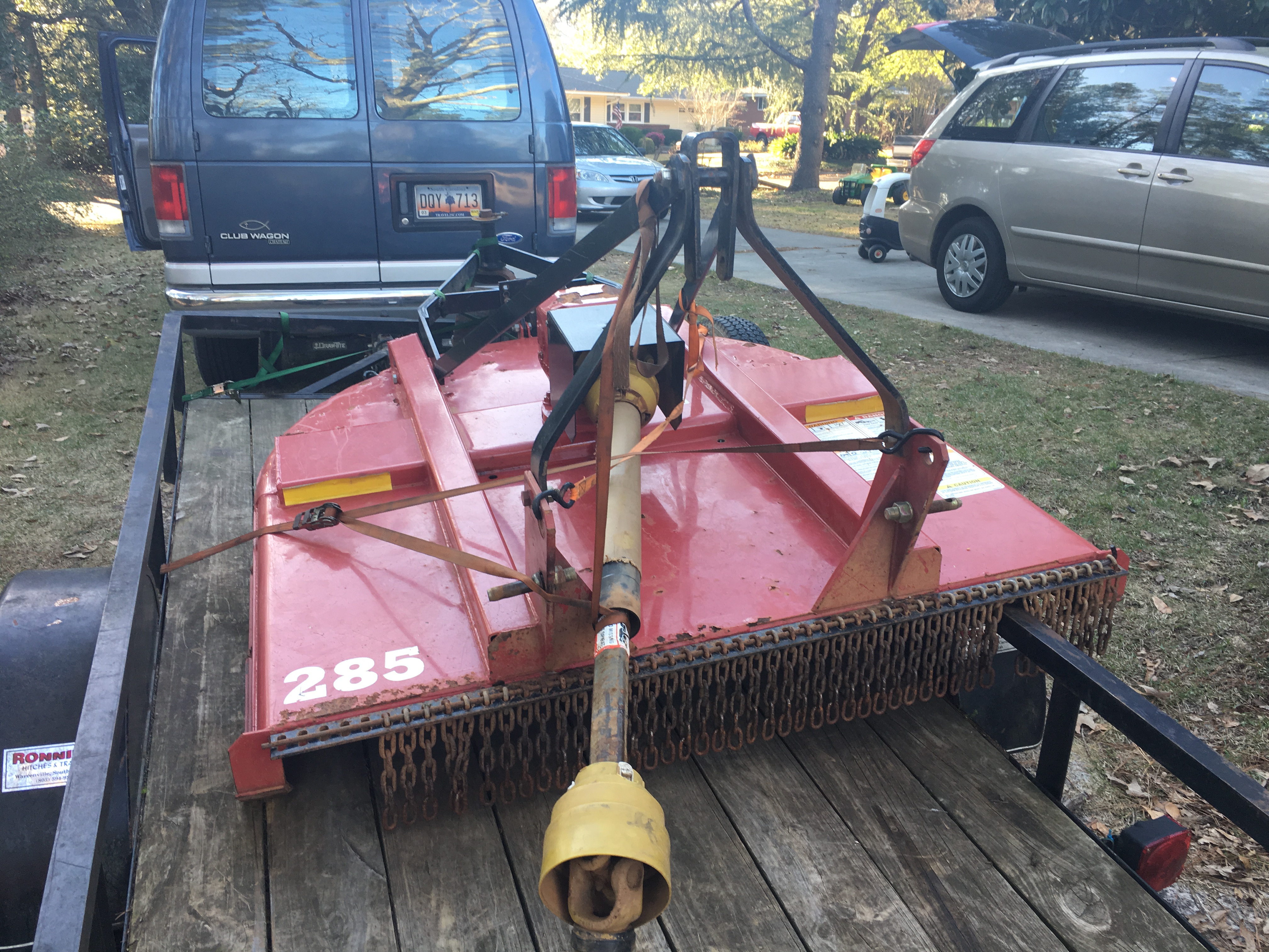

UPDATE
I bought my first rotary cutter!
I appreciate everyones advice and first hand experience. I decided to spend the extra money and pick up a Bush Hog 285. I was blessed enough to find a real nice one on Craigs list.
Time to get to work!

   / Can my tractor haul a large rotary cutter? #57
That is a nice cutter. You did well. I predict you will be as pleased with it's performance as I am with my Brown 472.
   / Can my tractor haul a large rotary cutter? #58
That should do just fine. Great choice.
   / Can my tractor haul a large rotary cutter? #60
UPDATE
Good Pick! It should work well for what you plan to do.
I ran a Brushog SQ172 behind my old L3430 HST (27 PTO HP) with no problems. I just slowed down for the gnarly stuff. The salesman said not to worry about the 30HP minimum.
If I might ask, what did you pay for the 285? I'm thinking of selling my SQ172 and I'd like to get an idea of what it's worth.
