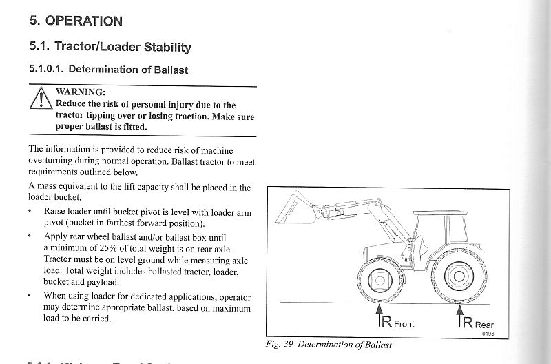

First, I really appreciate all the advice. Thank you all. I guess the question now is how much ballast to have. I have researched this without clear answers but what I learned is that some is better than having none, the owners manuals no longer give that info for many manufacturers of tractors, and some people say to use a weight equal to your maximum front loader capacity.

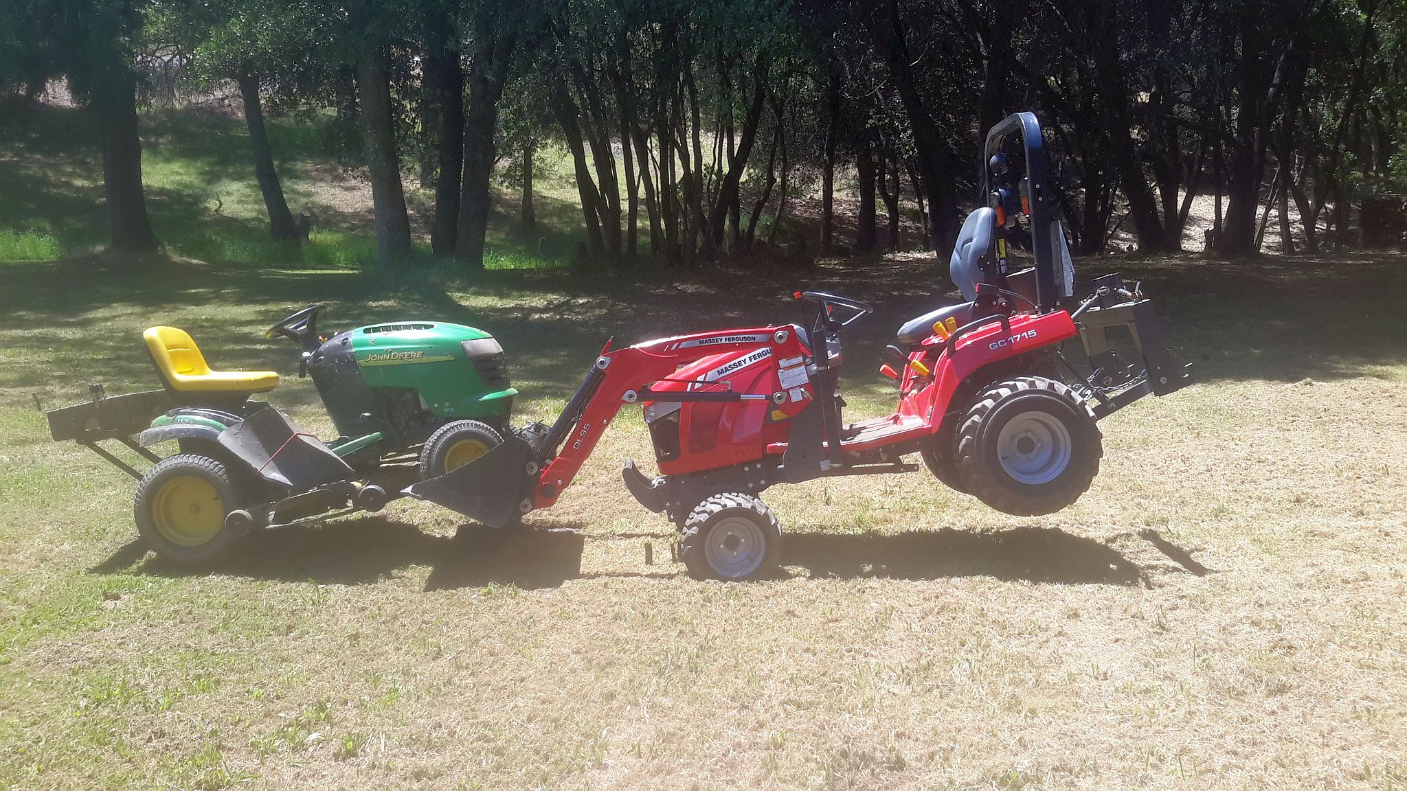

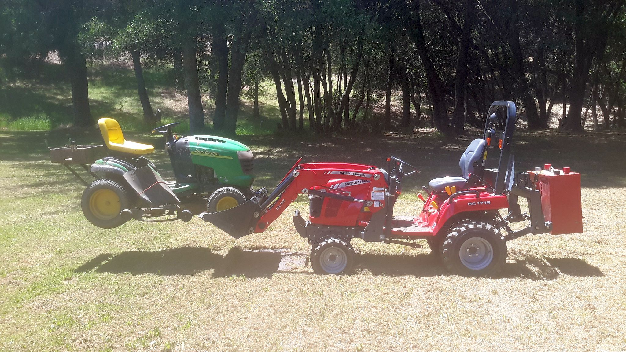

Have a SCUT, and its a "lightweight".... IF going to do heavy FEL work yes the 500-600 lb. ballast goes on QH..... IF no real FEL work ballast is off, did notice one time on awkward side hill turn (I know bad thing) front steering was a little "light" with empty FEL and ballast on..... ITs pretty much a judgement call on what work you are doing with FEL or just need more traction to drag something... At least in my mind (but that is a confusing place) .... Never subscribed to the loaded tire theory. but may suggest it...
The two pic below is why I decided to make ballast box, and it was fabricated by only materials I had in scrap bin pulse about 9 bags of sackcrete......
By the way "runs like a dead deer" weighs in at 520 pounds by JD manual....

This is what my manual says for my SCUT.... Might be a formula to go by if you can work with your numbers....
Dale

I've been searching the forums and it seems there are quite a few discussions about determining proper ballast, and they never seem to find an answer. I guess I'll keep reading and learning, but I do need more weight than I have.
I think my original question is answered, that if I'm going up a steep hill with no weight on the loader, the rear weights might put me at risk for backwards rollover. I would take them off in that situation. Otherwise, I'll leave them on all the time.
Thanks again to everybody for helping a new tractor owner.

Some of you might be wondering how he is able to pick up that JD lawn mower without it falling out of the bucket. I suspect since that JD has a steel tube front "bumper" that just so happens to fit and wedge under the upper lip of the bucket on the little Massey, that this allows the JD to stay "stuck in the bucket" as he raises it off of the ground. The poster can confirm or deny this, but it makes for a neat photo. :)

My Op Manual - RE: rear ballast. Paraphrasing here - "Be sure to use adequate rear ballast when lifting loads with the FEL".
JMHO - LITIGATION is the reason there are no definite recommendations or formulas in the Op Manual.
