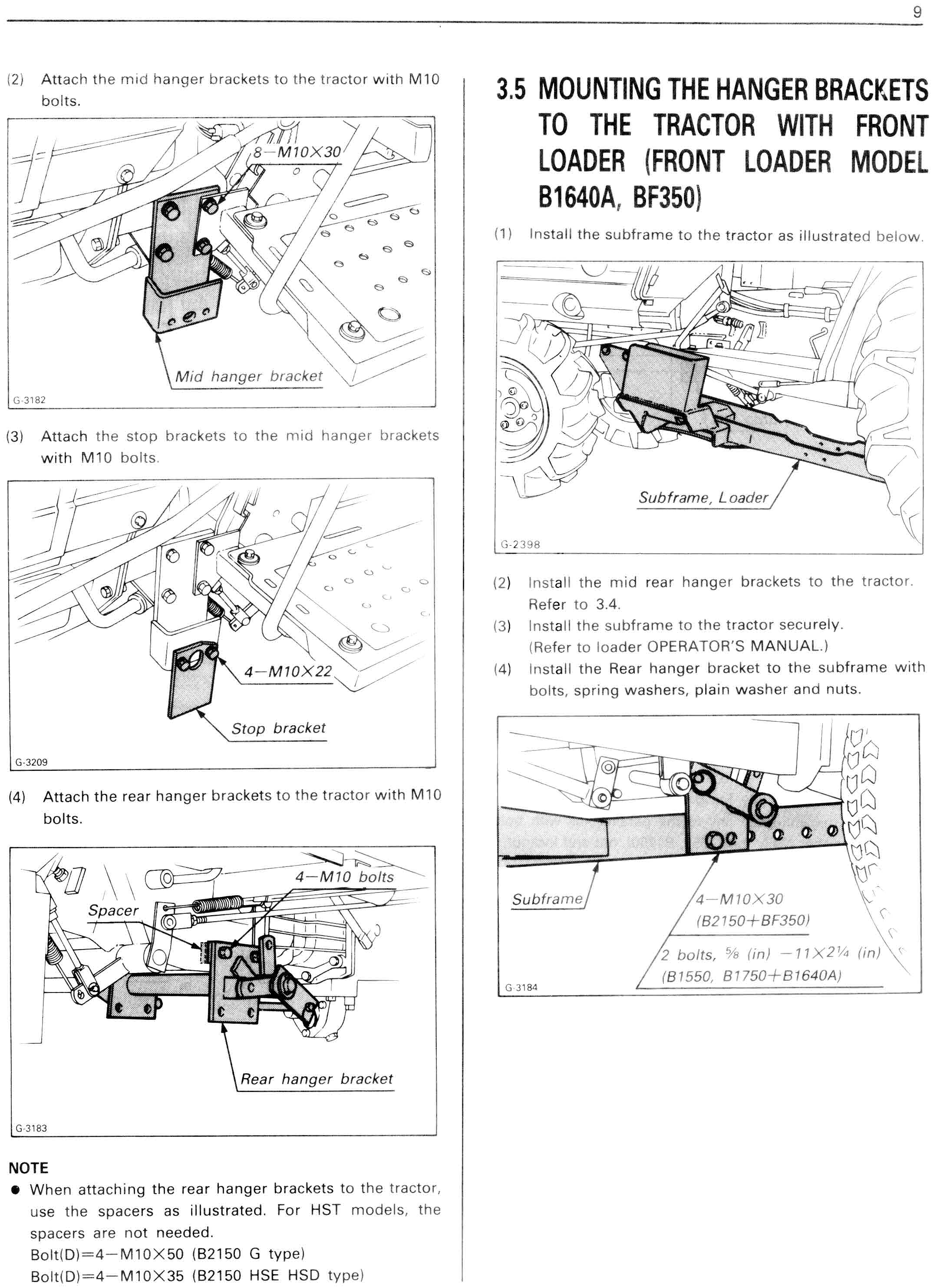

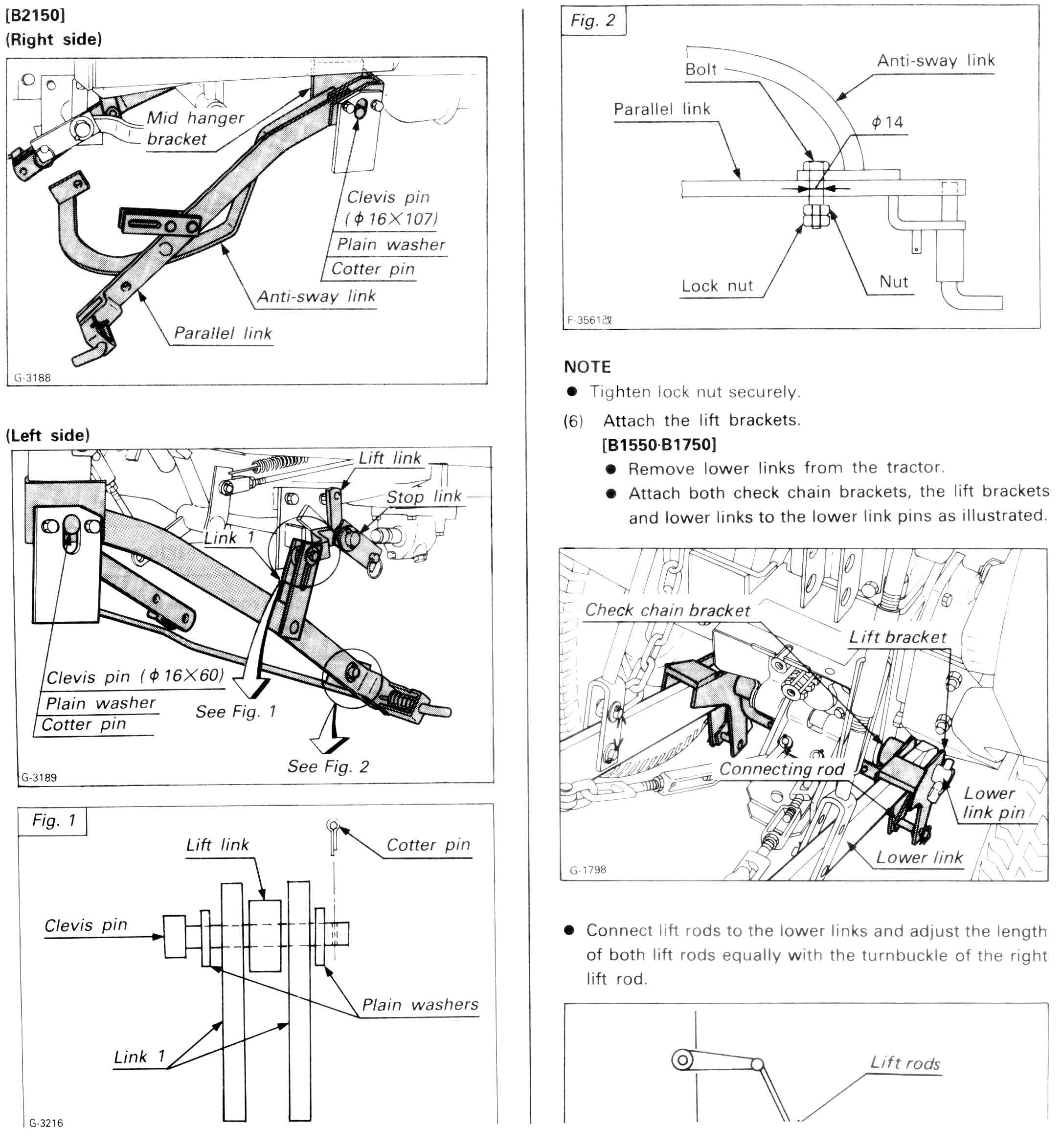

Could someone snap a photo of the left side B7100 MMM connections? I have all the owners manual, for the B7100 and the 60" mower RC71-60B.
I can't make sense of the connections for the mower to raise/lower on the left side (as sitting in the tractor). There's more connections on this side and they aren't as intuitive. The owners manual was a bit ambiguous.

See if these pictures will help. My mower was for a B2400, but I adapted to fit my B7100. I think the mounting brackets are the same.

As I recall, the inner arm on the right side crosses over and attaches to the left arm near the pin. The two are loosely held together with a shoulder bolt that allows a small amount of articulation. The snap pin from the deck only attaches to the left arm itself, not thru both.

WOW, thanks a bunch, that should do it. My B7100 manual sucks compared to that, it has no diagrams - just lots of confusing words that don't really distinguish between all the various rods, connections, bolts, holes, pins and stuff.
