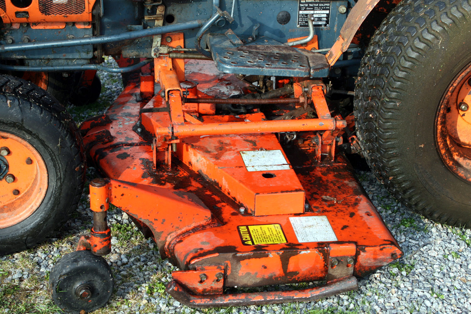

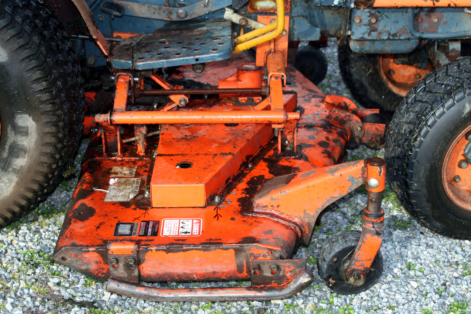

Here are the photos as promised...

thanks a bunch biffo, something is definitely up with mine. oddly enough it does "work", though i don't know how. the mounting hardware looks completely different than that, wonder if a previous owner just made something for it.

Grossgary -
I think Biffo has a different mower with a much different mounting system. My original B7100 mower, Model MR6000 used that mounting. I think they called it parallel linkage. I don't know the number of Biffo's mower, but the later B7100's had a RC60-71B, I believe. His mower appears to be a model they offered in between the MR6000 and the RC60-71B. I put the RC60-B on mine even though it was made for a later model tractor, I think a B2400 if I recall correctly. It was not too difficult to mount. The biggest problem was fabricating the rear mounting brackets. The front hanger bracket pretty much bolted on with only a few modifications.
The older parallel linkage mounting had a tendency to wear a lot. With it the mower was actually pushed by the parallel linkage, whereas the mower is pulled along from the front mounting bracket on the newer mowers. What I miss most from the old MR6000 was the height adjustment lever. It was much more convenient than adjusting each wheel separately as on the newer models. The newer mower cuts better also.
