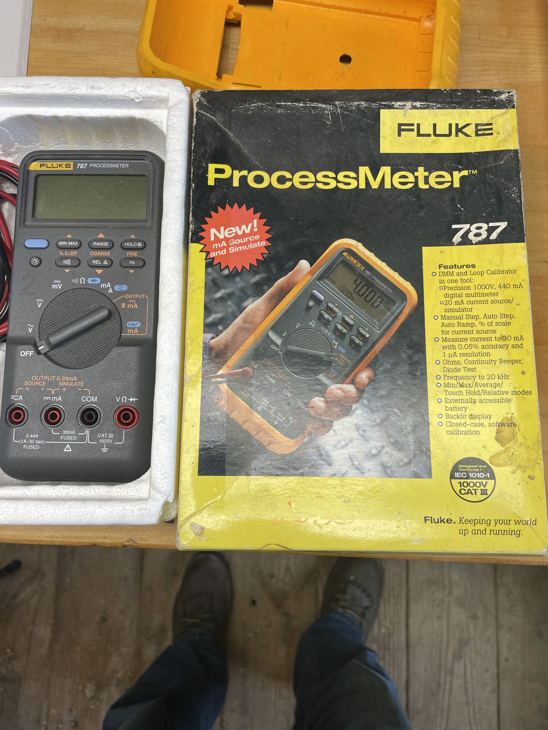

I have this 787 Fluke meeter that was left over from an industrial job. I think it can do most of what you were talking about including frequencies. It was mainly used for calibrations of instrumentation in a plant under construction.
