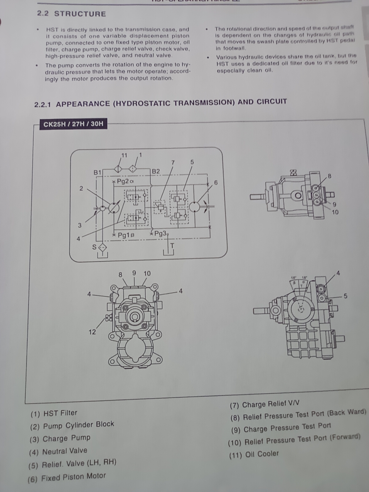

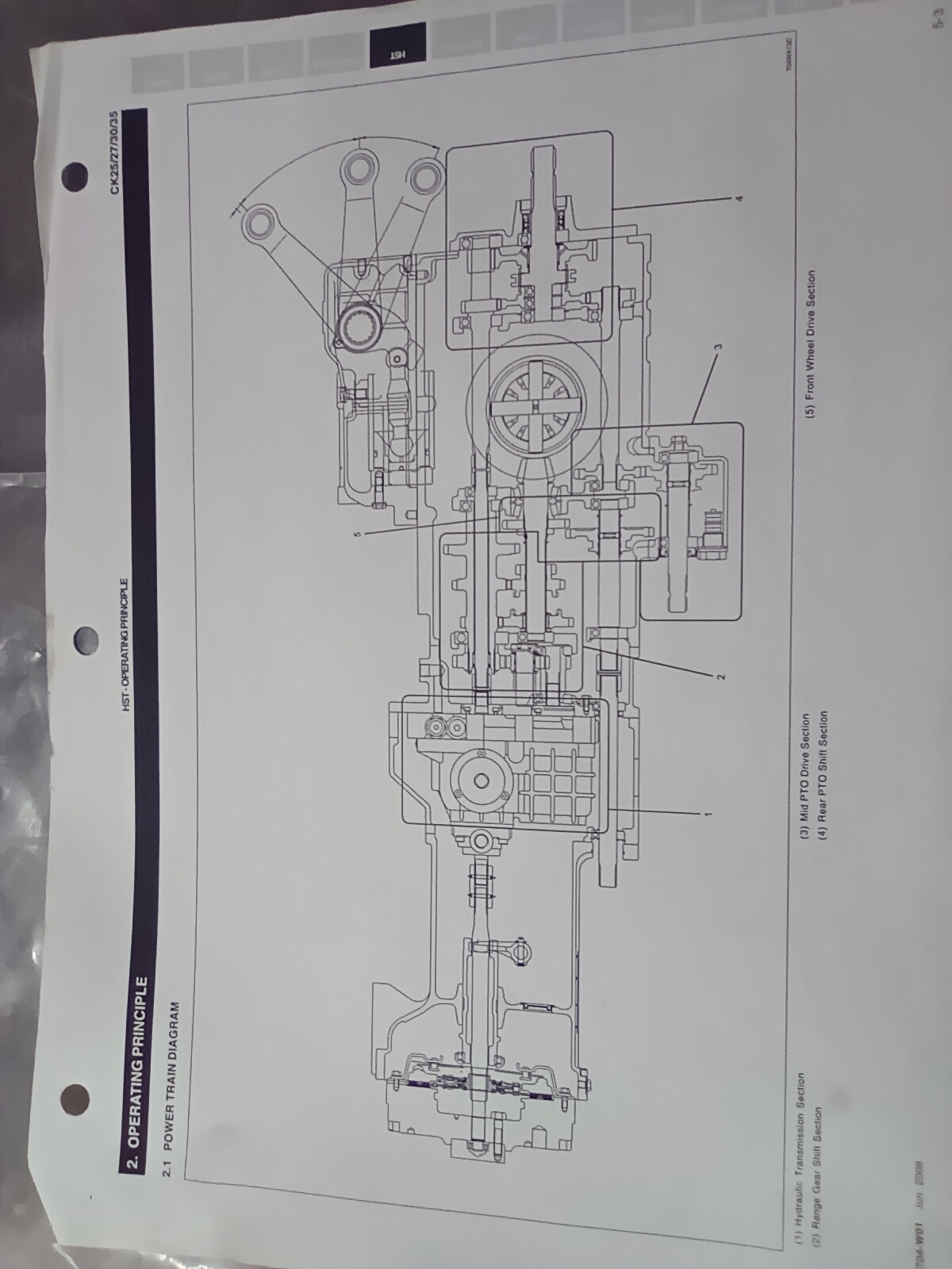

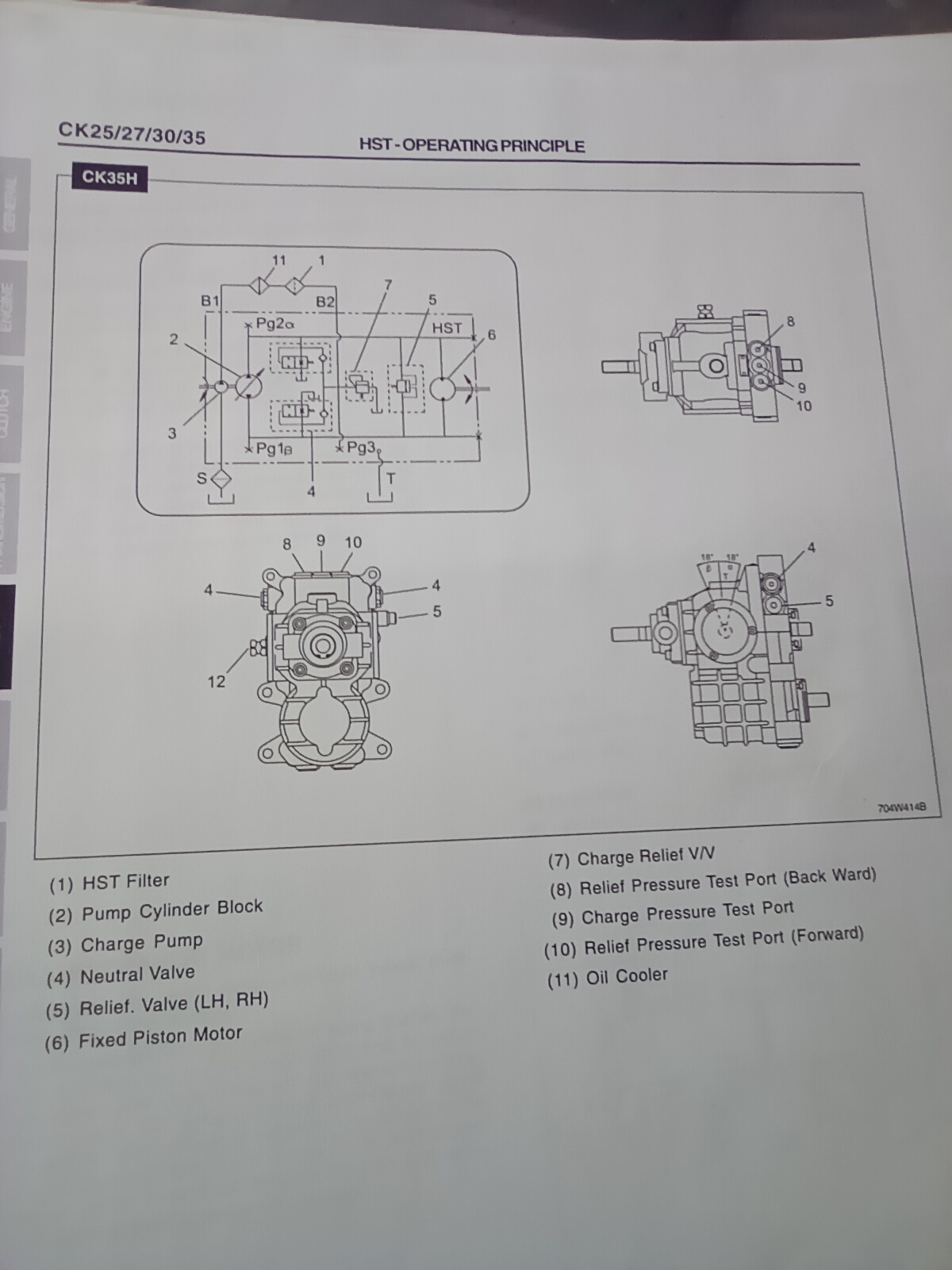

I'm posting some schematics . I have pages of diagrams on all the transmission components.
Those diagrams are great. Did you ever replace that hose and clamps back on Feb. 1?
Are you still trying to do this yourself or going to find some mechanical help?

Typically, a mechanic will want to check what the symptoms are and experience them himself.
Then he will want to go over what you did and see if anything there has contributed to a problem. If he can't find something - and he may not - then the the next step is to get out your shop manual and check the hydraulic pressures.
There are standard test ports that he will spot immediately for the main tractor hydraulics on the main pump and on the FEL control.
Then with the aid of your workshop manual and those pictures you posted he can also find the ones for the HST system. Pressure values should be in the workshop manual.
The pictures also show a schematic - the diagram with hydraulic symbols. That is very good, because with pressures and that schematic then he can probably find the problem.
To do this in the best way, one of you will need a hydraulic gauge test kit and adapters - better ask if he has one to bring it.
If it is you doing the work, Amazon has hydraulic test kits. Look under "hydraulic test gauge kit". They aren't expensive. The challenge is getting the proper threaded adapter to fit your test port. Most of the hydraulics on the loader control valve are universal, but with the HST getting the right adapter is always a gamble.
