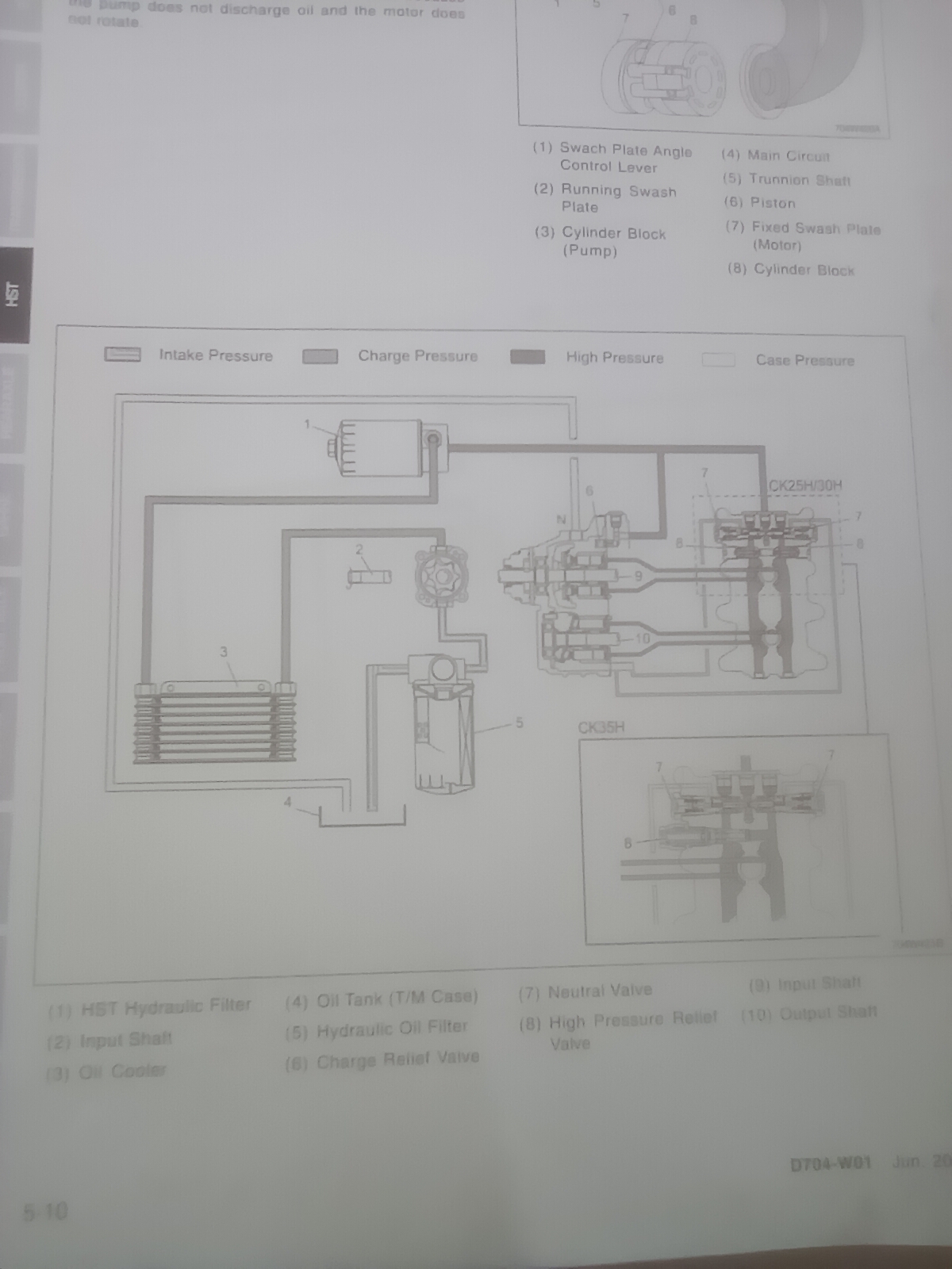

I think the problem is in the hydrostatic system.pump ,motor,relief valve or some thing . The main hydraulic pump is working fine. All implementation work as they should. It's the travelling that's a problem. It will move along for a short distance then stop. Both in forward and reverse. It like it is in neutral. Pushing foot pedal back and forth it will move again for a short distance. Any thoughts? Thanks,Len
   / Can the hydraulic system get air locked after a fluid change #45
Where is the charge pump on your tractor? Is it a separate pump or fed by the power steering? I would suggest checking your charge pressure to determine if that circuit is being fed properly.

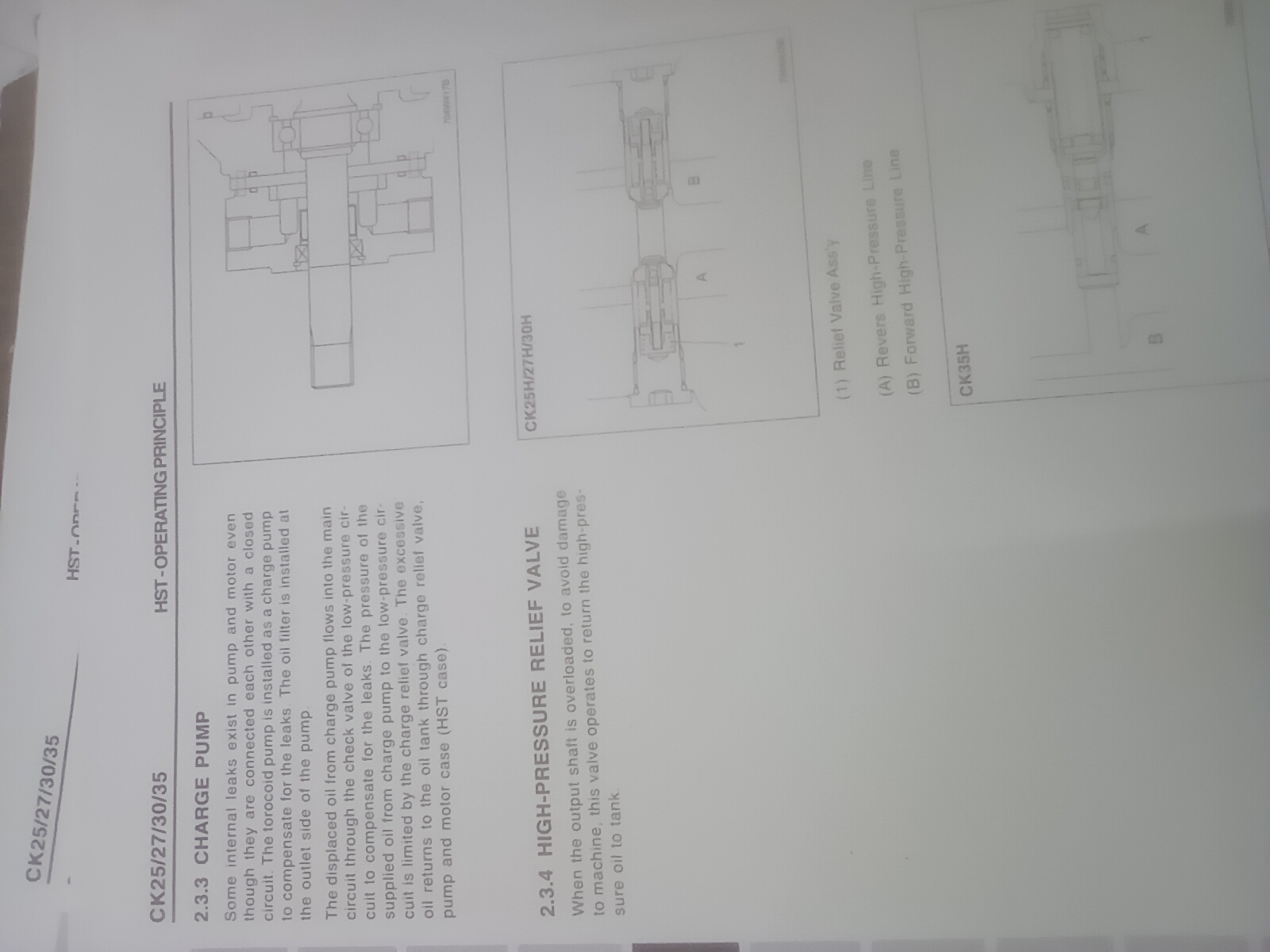

I think I am in over my head.I'm a carpenter trying to be a mechanic.
   / Can the hydraulic system get air locked after a fluid change #47
It looks like your tractor has a built in charge pump with a suction filter (item 5 on 2nd picture) Did you replace this filter? If yes did you use an OEM filter or after market?
Some models of tractors are very sensitive to what filters are used and non- factory (OEM) cause cavitation problems.
Also need to triple check that the filter seal is not compromised and allowing vacuum leak.

The filter is from the dealer. Looking back now I realize the problem started before the fluid change. When this first occurred I checked the fluid level and it was a little bit low so I decided I would just do a complete fluid change.
