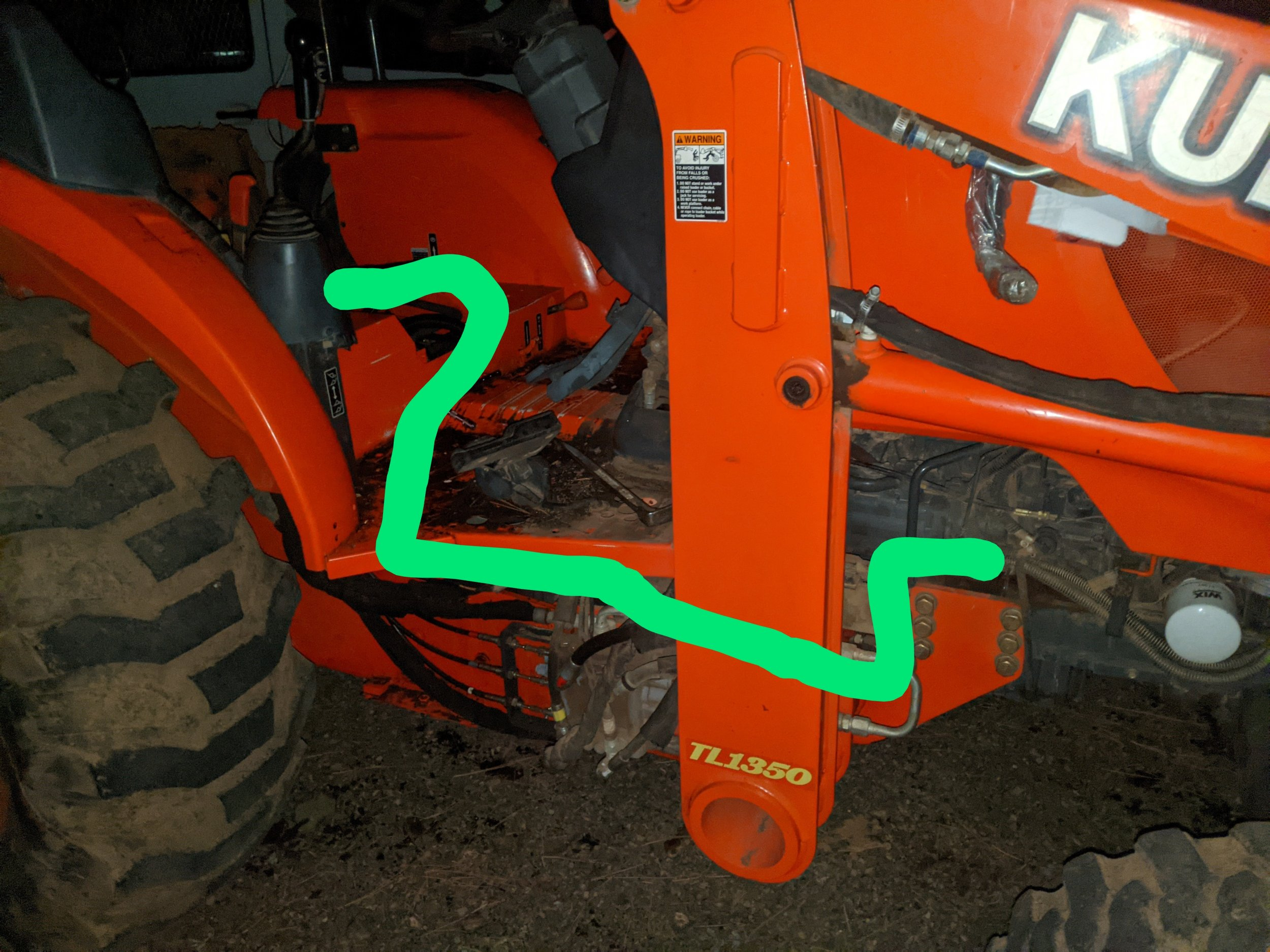

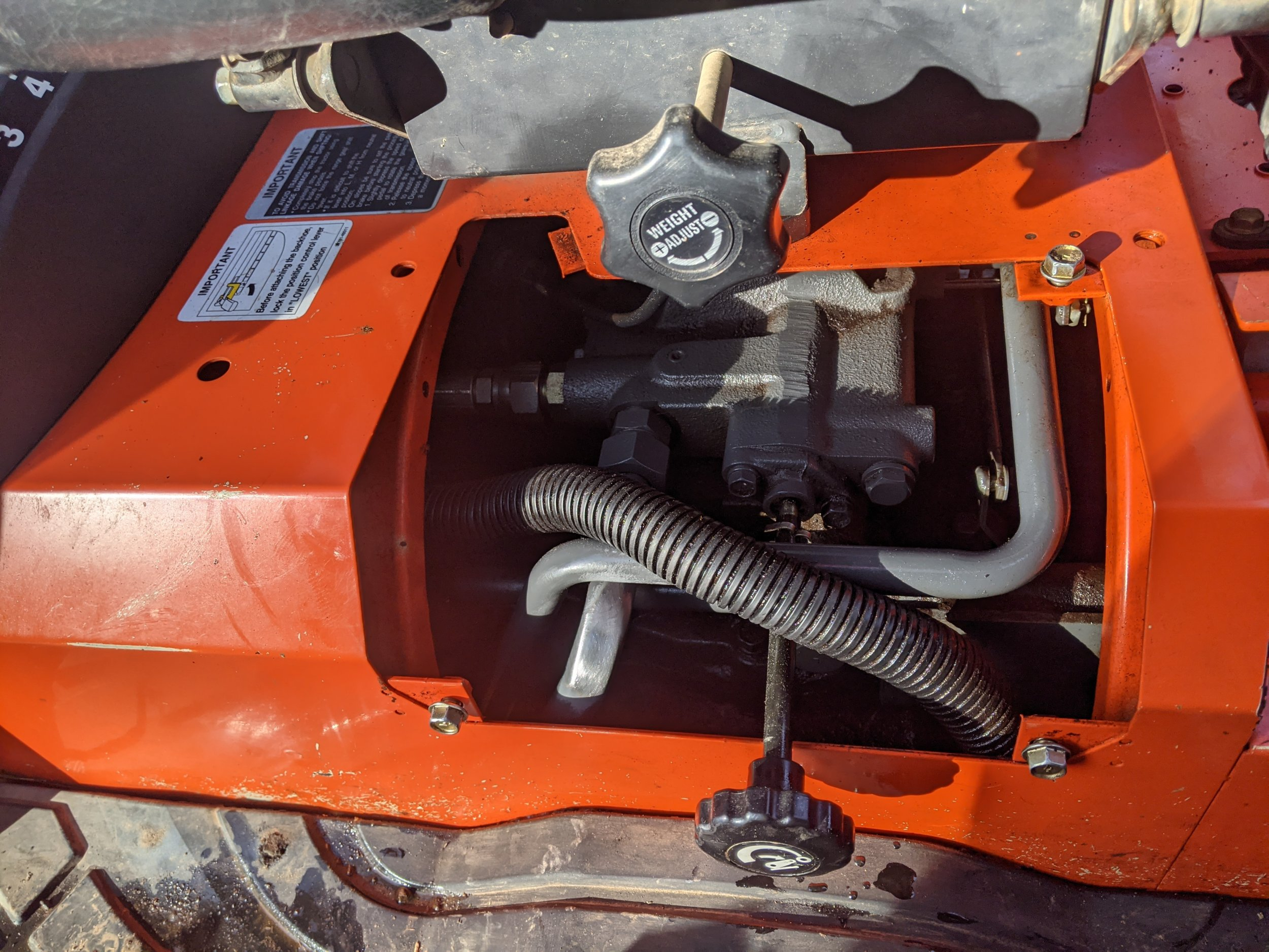

By the way, just to eliminate any confusion. I have the tube disconnected at both ends. It will move an inch or so but it is about 4 ft long with compound bends and angled sections on both ends.

It's definitely not going to be fun.
