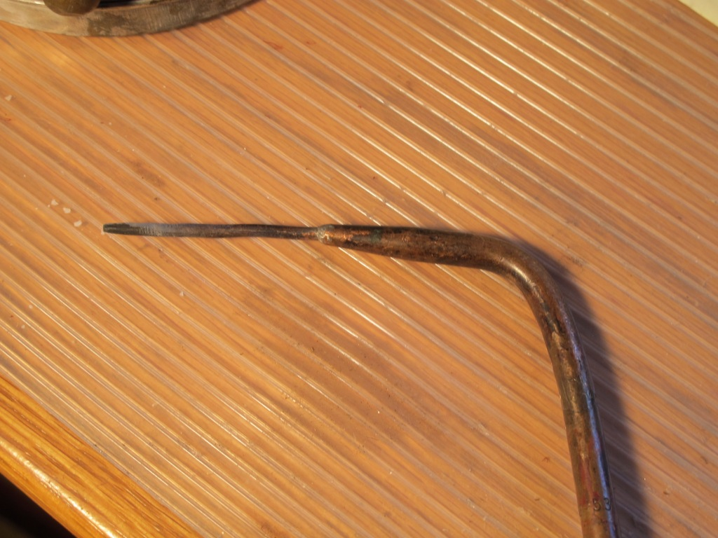

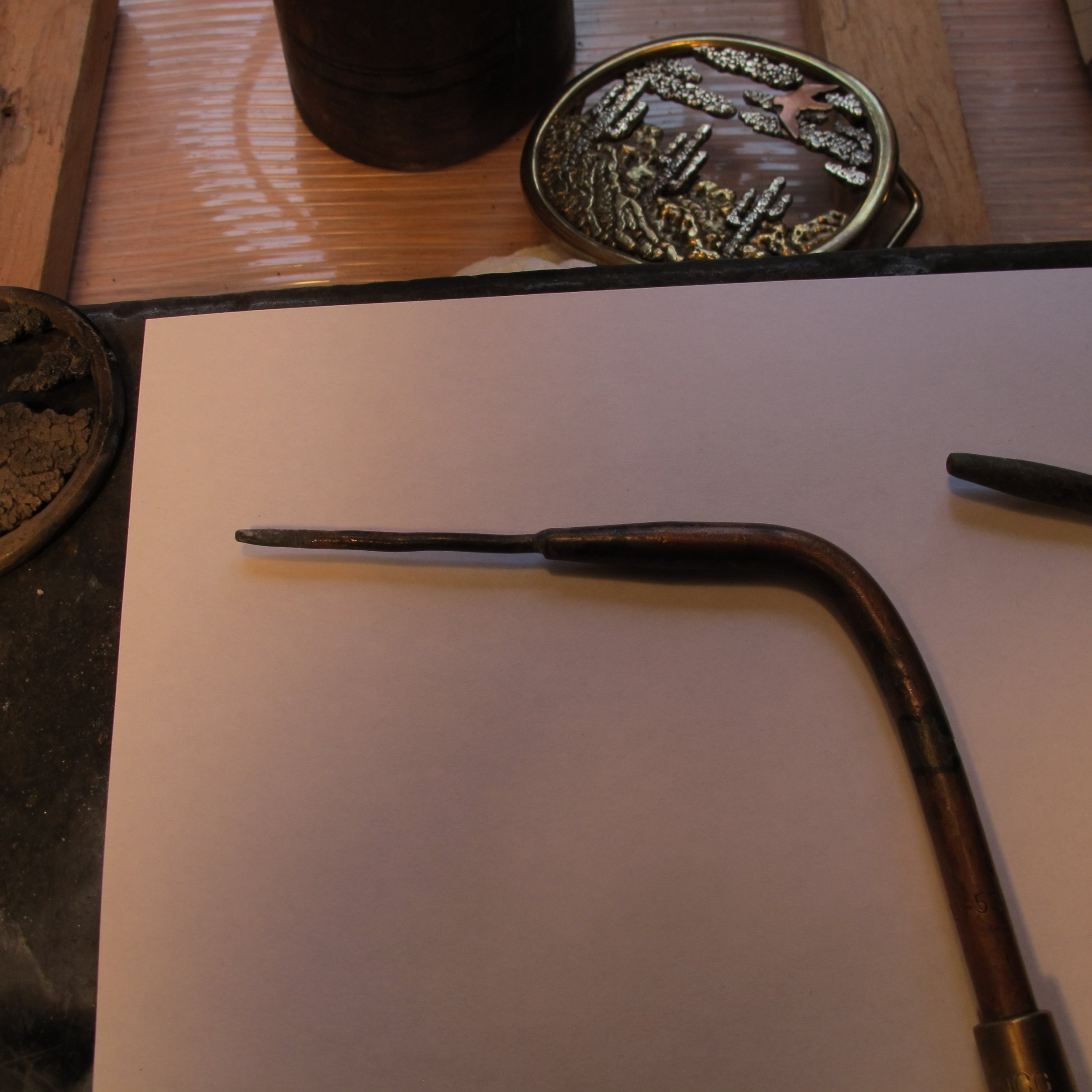

This is the tip I use for micro-welding with a big old funky Craftsman "bridge-building" torch. Old Craftsman torches had nice valves....
I don't do much brazing or silver, but it works well for that too.
This tip is basically just what you think it is... a piece of copper tubing soldered into a hole counter-drilled into a normal size welding tip and then the tiny flame orfice for the copper is made by annealing the end and hammering around the shank of a tiny number drill.
The resulting flame is about the size of a grain of wheat. I run it with 3 or 4 psi acet & 5 oxy.

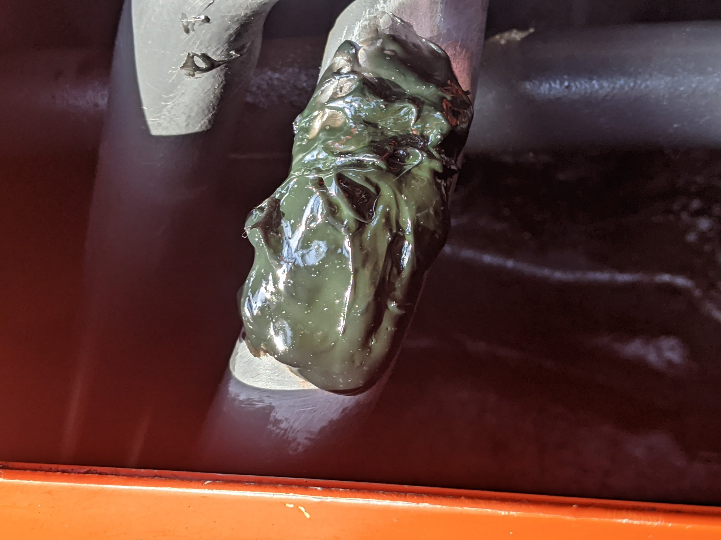

I am a refrigeration tech so I will be applying my practices and tools to this. I will be using an air acetylene turbo torch with a rosebud about the size of your thumb nail. I usually have no problem doing up to inch and an eighth copper with an MC tank. Most of my experience with steel is brazing copper lines into steel king valves on compressors. We use a paste flux on the mating surfaces and then a 45 to 55% silver alloy brazing rod. Or a hollow core brazing rod with flux inside. I will blast the oil out of the tube with nitrogen and then set my regulator to bleed a low pressure feed of nitrogen through the tube while I heat it up. Probably float the high silver and flux combo all over the top of the trouble area because it is runny, and then switch to the 15% silver alloy brazing rod to cap it because it will build up a patch better. Bleeding the nitrogen through the tube while I heat it will eliminate any oxygen in the line that could allow any residual hydraulic fluid to catch fire, and prevent oxidation and pollution on the inside of the pipe. My first challenge is a bit embarrassing, as I attempted to bubble gum the leak first, so I will have to get the epoxy patch off of the area and get it back down to clean metal. I will document what I do and report back in a day or so.

I highly doubt you will get enough of the oil out of the tube to not have a film where the repair is going to be. Is there any way you can wash the oil out of the repair zone? Maybe squirt some cleaner through the crack after you have blasted most of the oil out and then blast nitrogen through again to blow the cleaner out? I too use air/acetylene for soldering and brazing copper pipe. Get it hot fast, get it brazed soldered fast, and then get the heat away. That way the flux doesn't get used up. I'm sure with your experience you will make a good repair.
