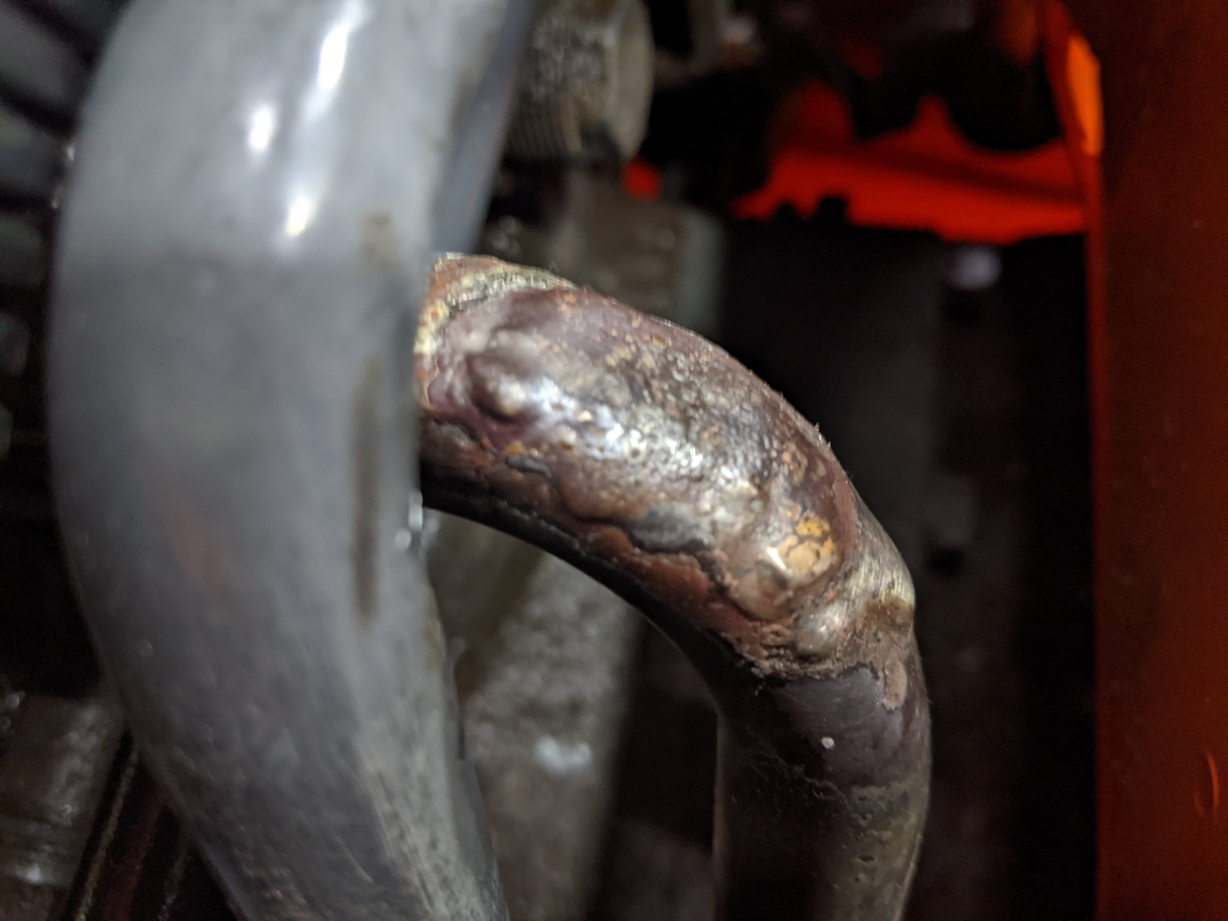

I didn't think much about it the first time someone claimed to gas weld steel hydraulic line with clothes hangers as filler. After hearing it again I'd like to ask (A) How many others here can and do gas weld steel hydraulic line with clothes hanger filler? (B) Foremost,will one or more of you expand on the proceedure? Does clothes hangers melt at a temperature low enough so there's a margin until line melts or do you melt parent metal as well? How do you prevent damaging or even collapsing line? Is any hanger suitable and if not,how does one tell? Is there filler available at welding supplies that is equal or better? Most everyone is impressed with OP's brazing repair which is a feat to pull off without contaminating inside line. Welding take's things to a higher level that would be good to know for a few other applications.
   / Can you braze a hydraulic line? #64
Using a clothes hanger ( done it many times ) is the same as using mild steel gas rods, I prefer to use the mid steel rods but clothes hanger are handy if you happen to be out of the other. Using gas is the same as any other welding you have to learn to read the metal to not get it to hot and burn through or not getting it hot enough to stick. Personally I REALLY enjoy gas welding and brazing, the biggie as with any welding is get it CLEAN if you want it to work.
   / Can you braze a hydraulic line? #65

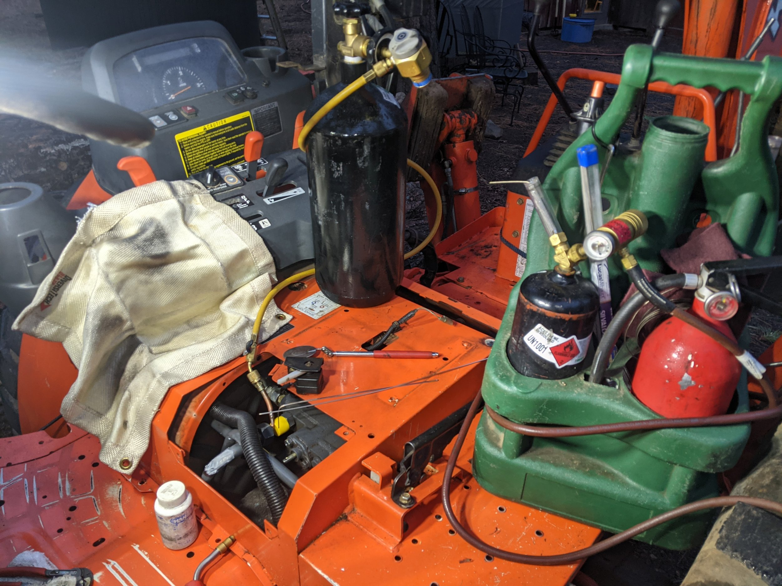

I am a refrigeration tech so I will be applying my practices and tools to this. I will be using an air acetylene turbo torch with a rosebud about the size of your thumb nail. I usually have no problem doing up to inch and an eighth copper with an MC tank. Most of my experience with steel is brazing copper lines into steel king valves on compressors. We use a paste flux on the mating surfaces and then a 45 to 55% silver alloy brazing rod. Or a hollow core brazing rod with flux inside. I will blast the oil out of the tube with nitrogen and then set my regulator to bleed a low pressure feed of nitrogen through the tube while I heat it up. Probably float the high silver and flux combo all over the top of the trouble area because it is runny, and then switch to the 15% silver alloy brazing rod to cap it because it will build up a patch better. Bleeding the nitrogen through the tube while I heat it will eliminate any oxygen in the line that could allow any residual hydraulic fluid to catch fire, and prevent oxidation and pollution on the inside of the pipe. My first challenge is a bit embarrassing, as I attempted to bubble gum the leak first, so I will have to get the epoxy patch off of the area and get it back down to clean metal. I will document what I do and report back in a day or so.
I have brazed a hydraulic fitting with flux coated silver brazing rods. The ones I have seen are coated with either red, white, or blue depending on the mfr. It worked fine
   / Can you braze a hydraulic line? #66
What kind of pressures can a brazed patch handle? I don't know much about brazing but hydraulics run such high pressures that I don't think I would even try to weld on them let alone braze. I would just replace the line with a flexible hose built for hydraulics. It would suck to have it break down "in the field" with no way to get it back to the shop.
   / Can you braze a hydraulic line? #67
Save your consumables and time. Buy a new line. You will never get the oil film removed from the inside. Procedure is correct, job is wrong.

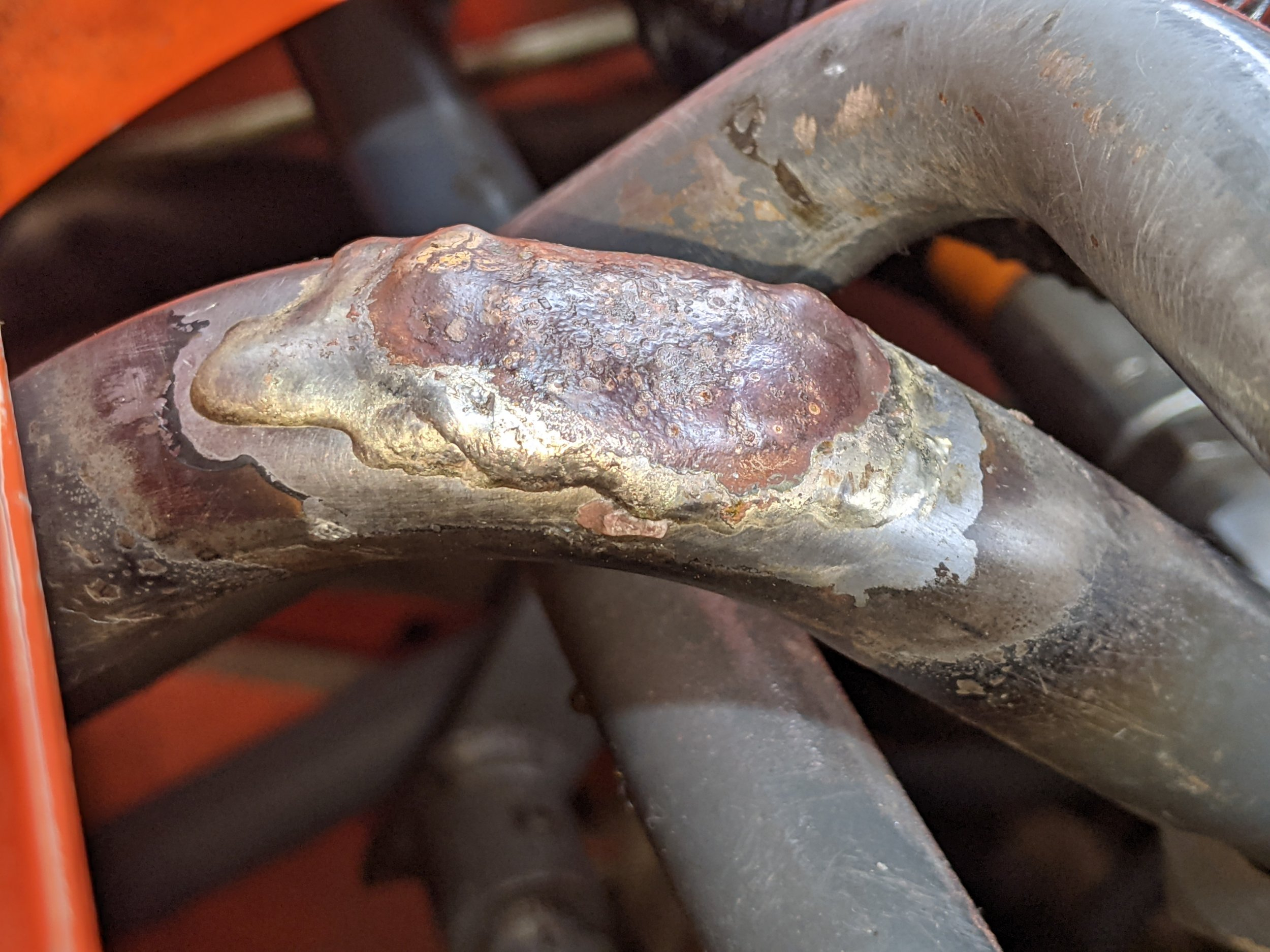

Regarding the issue of overheating the steel tube, my silver rod melts well below 1500° so the tube never even got to dull Cherry. It just barely got shiny.

My first choice (if possible) would be to cut a section out of the tube and make up a steel tube fitting that bridges the gap with a tubular lap joint at both ends - like an elbow fitting used in copper plumbing. If that won't work, then a patch that fits around the tube as close to 360 degrees as you are able to get it. Try to get the fit gap within recommended range - typically .003-.005 loose, but will depend on tube/patch and filler materials. You want the braze to be loaded entirely in shear, if possible. Also, keep in mind the system pressure in a hydraulic circuit is going to be high, if you're on the supply side. You also need to consider what type of shock load factor to apply, based on how flow is affected by sudden flow changes - pump "ripple", valve operating speed and system damping. In-other-words, over build it.
   / Can you braze a hydraulic line? #80
Need to remember wrapping with wire trick before brazing. SS safety wire?
I've got to remember that trick, too. It's a good one.
The resulting composite of steel and silver stands a decent chance of being better than either alone. I'd love to see some formal testing.
