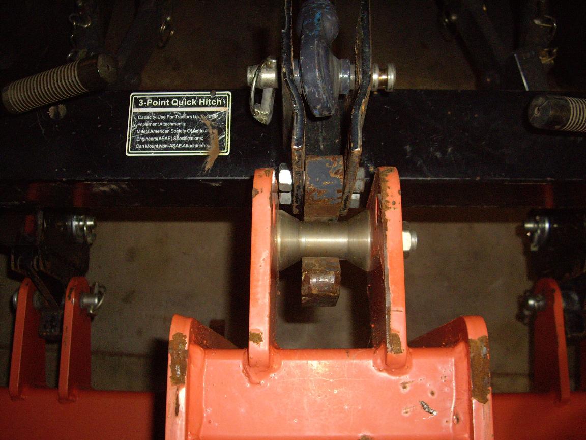

Ok, here's a picture of my box blade hooked up taken from the rear almost straight down on the top hook and the spool.
You can see that the flat in the center is a bit wide. The new ones are just a fit for the width of the hook on the quick hitch.
Seriously, I'm amazed at how much easier it is to hook up to my implements with this thing to center the quick hitch when I am off center just a bit.

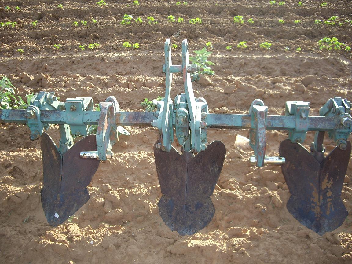

Also a picture of one of my tool bars with the old John Deere 3PT hitch. Just so happens that the bottom hole in the upper hitch where the old wore out piece of pipe is that will be replaced with one of my spools, is a perfect distance from the lift pins to fit a cat1 quick hitch and of course bottom parts are adjustable for width. I don't worry about bushings to turn the bottom lift pins to cat2 size for use with the quick hitch, I just buy cat 2 lift pins.
I have several of these old diamond bar implements and I'm rigging each of them for a different purpose. The one pictured is for bedding but of course the bottoms are much too large for the spacing of my beds. I'll rig one for cultivating, one for chiseling and I don't know yet what I will do with the last one. Anyway, I search the country looking for this type of hitch and so far, I've bought 4 and have two more located.
