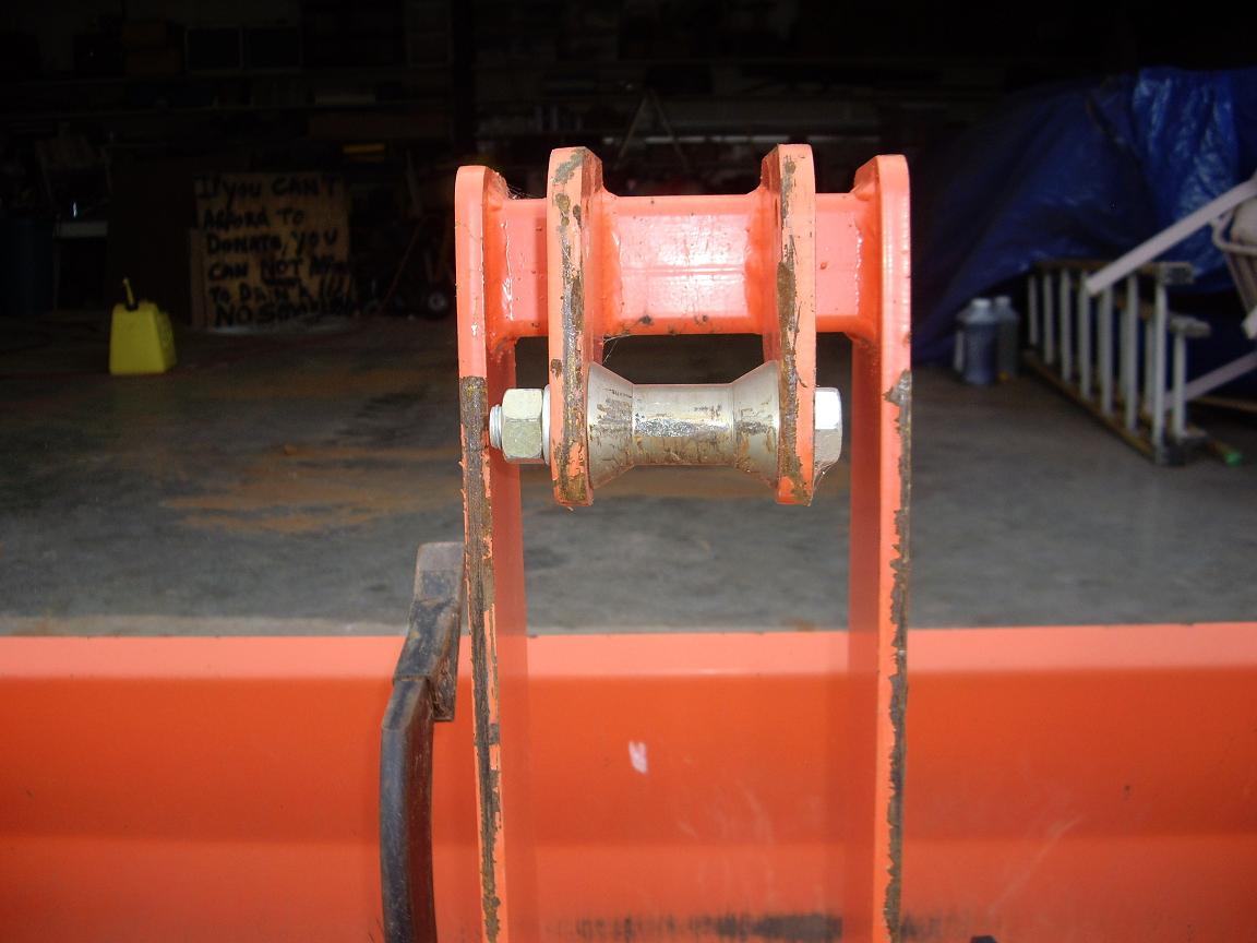

No bearing or bronze/Delrin bushing thru i.d. ?
   / can you guess what these things are?? #23
I actually turned out 3 pretty similar to these...mine have a deeper "vee" and fit into brackets I mounted on my car trailer...winch cable guides, in my case.

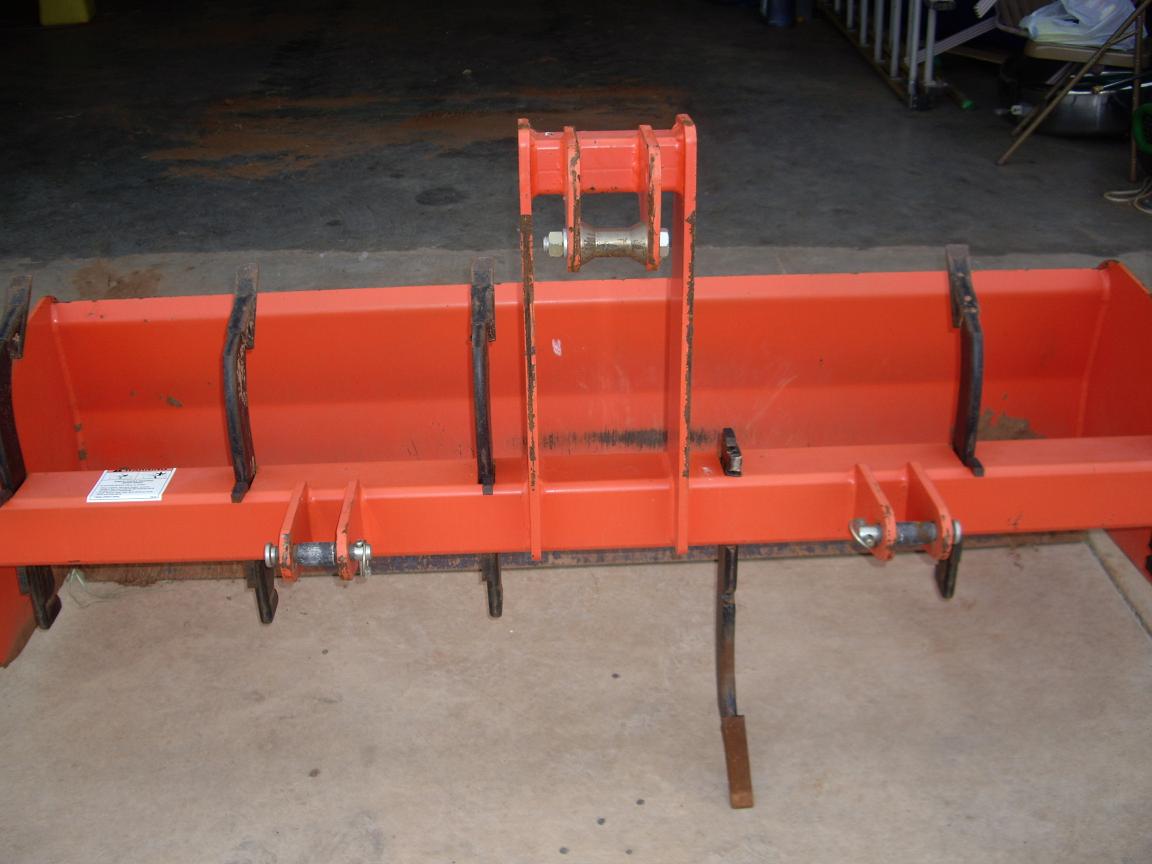

I use it for the toplink pin on my attachments and it helps to center my quick hitch. I'm outfitting all of my stuff with them.
I'll post pics when I get home this afternoon.
#28
Here's my box blade with the first one I had my brother build me. It works awesome. Now I don't have to be so perfectly lined up with my implements. Just get the hook close and this thing will center the quick hitch.
The dimensions are slightly different on this one compared to the new ones but this was a first try. The new ones will allow less side to side movement of the implement.
I have 4 other pieces of equipment that I'm going to equipment with these.

Your brother did nice work on them pieces:thumbsup:.
