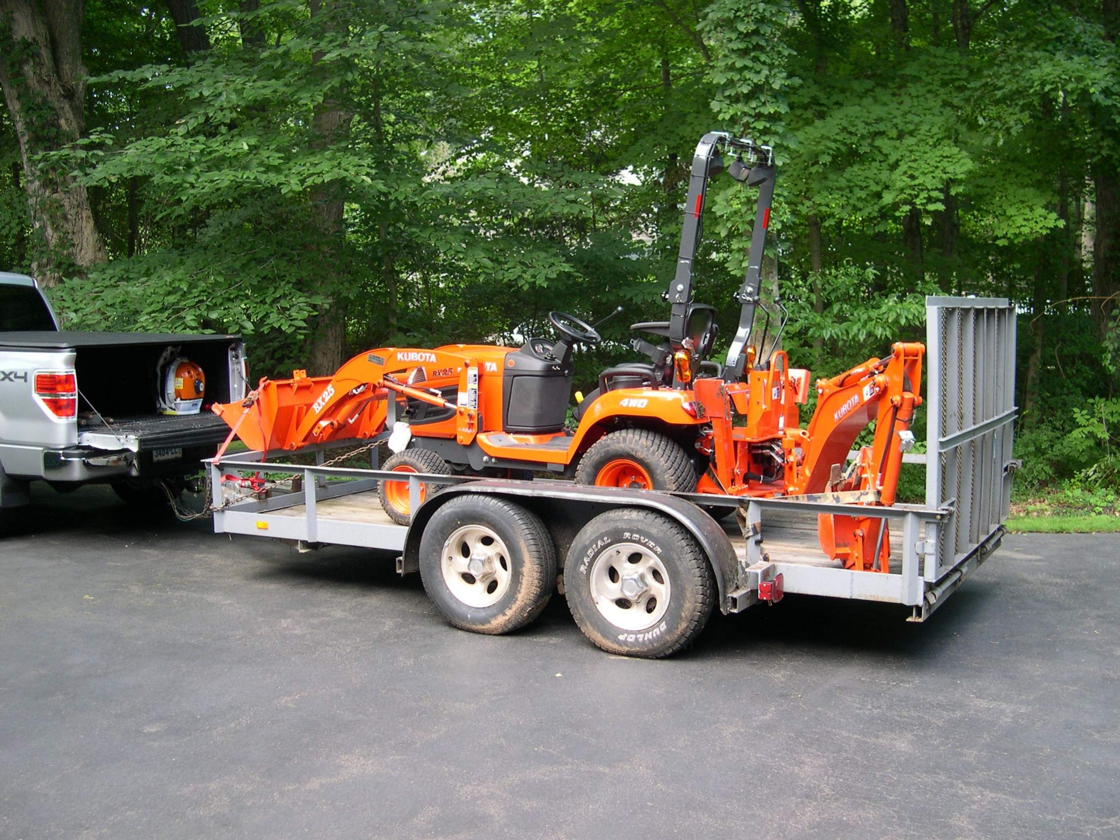

JB, can you tell me more about registering a home made trailer in CT - what forms are required? Sorry to jump in here but I have a home made trailer I bought used a year ago that has dual 3500 lb axles and is built like a tank. It is registered now at 2900 lbs but I think if I add brakes to both axles, it should qualify as a 7K trailer. I was thinking I would add the brakes and get it inspected. Just don't know how to go about doing that in CT. I can't find anything on the DMV website on getting a trailer inspected. Again, to the OP, sorry for the interruption. :) Here's a pic (and yeah, I was over the limit as it sits with my 2,700 lb tractor on it).
