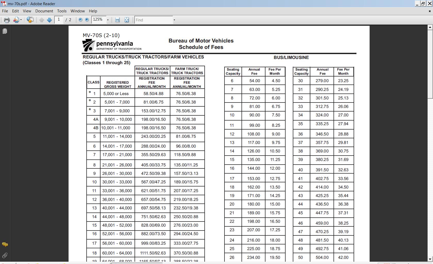

i still would re-issue trailer as homemade. Also, keep in mind the rating on the trailer is different than registered weight. i could put 16,000lbs of registration on a two axle trailer, that is "stamped" as a 12,000lb trailer. The "law" might pick up on this if you're stopped. Maybe not.
