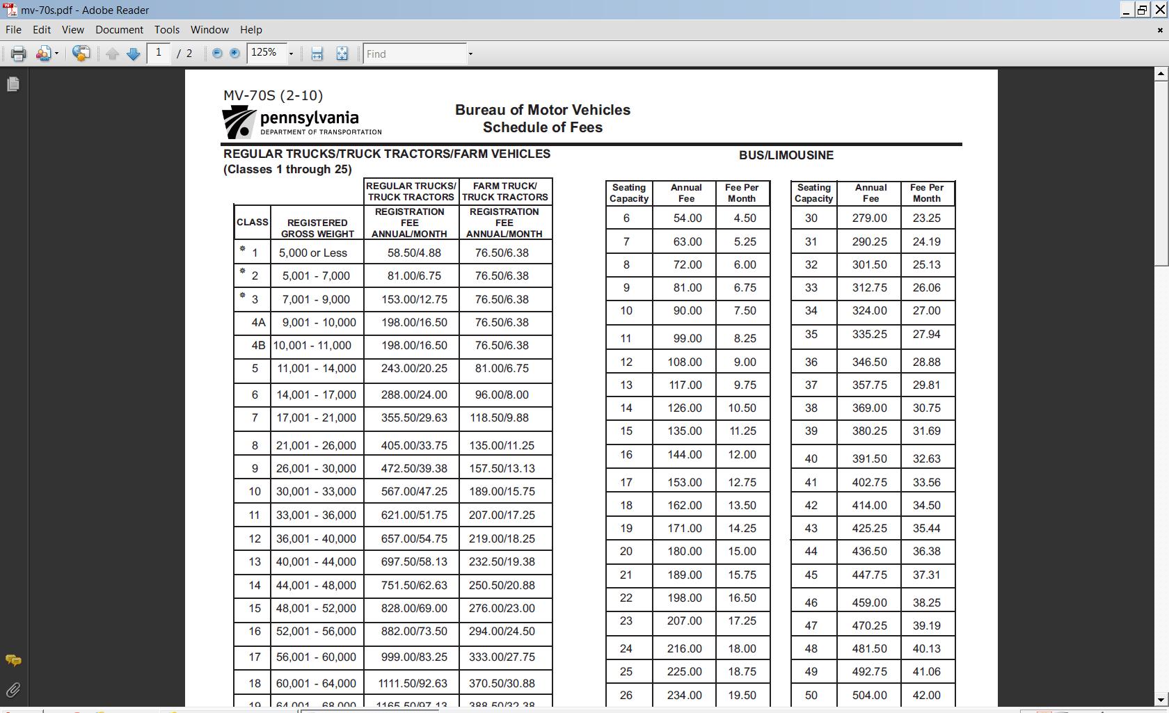

Here is the chart for the registration fees. If your trailer is over 10K it needs to be combined. So since my truck is 8800 GVW and the trailer is 14000 GVW I would need a class 8 registration sticker for my truck (21,001-26000 GVW). In PA big rigs have the class 25 sticker. I think the whole thing is confusing...

   / Can you "up-rate" a new trailer from 9,990# to 14k#? #42
I would say you could get away with it until you get pulled over by DOT. Then when they weigh you, you better hope it's not over 9990 GVW or you will get fined I'd imagine. The only reason I want to set mine to 9990 is to avoid combination plates.
In PA it would cost me $405 a year in registration plus Id have to inspect the trailer twice a year (additional $100).
Do they always look at the trailers reg? mechanically you would be safe.
I agree with saving money on the plates, my dump and flatbed are registered as camp trailers, which is what they give you if you are not using for commercial, huge difference in reg cost.
JB
Glad again I live in Indiana...
