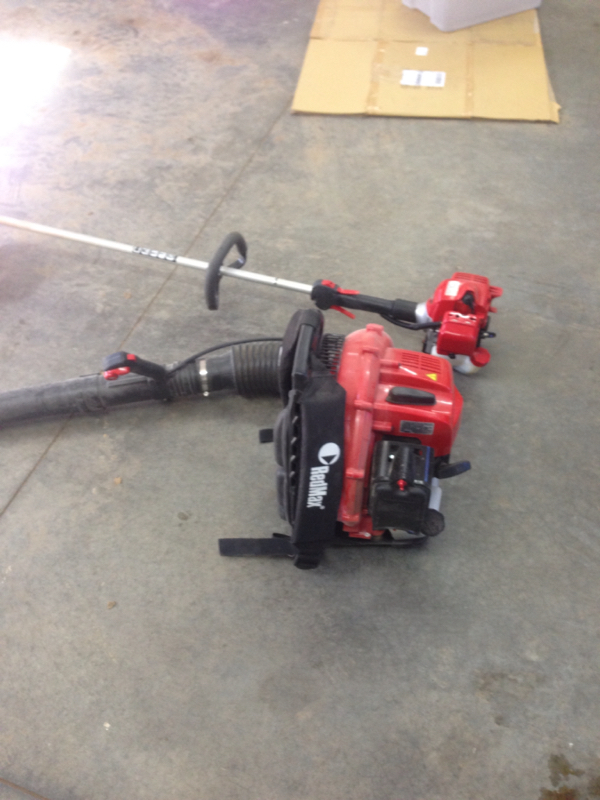

My blower has set since about November with E0 regular mixed gas. I needed it today and it fired right up. My weed whacker has sat longer than that. I started it just to see if it would and it fired right up. What would the canned fuel have helped?
   / Canned Gasoline? #118
