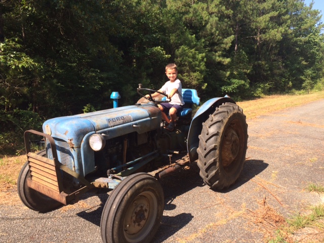

This tractor is so beat that the serial numbers are almost un recognizable. Due to the sheet metal, it makes me believe it is an early diesel (65-66 or so) but even then, I have looked through every part number for a Ford 2000 PTO shaft and none are correct, either too long or wrong input spline. Thank yall for the help and comments so far.

OP. post a picture / pictures of your tractor.
maybe you don't have what you think you have?

That is the one I tried. As soon as I figure this picture posting thing out, I will post a picture of my tractor. Thank you all for the help. I apologize if I was not as descriptive as I could have been. image1 (4).JPG

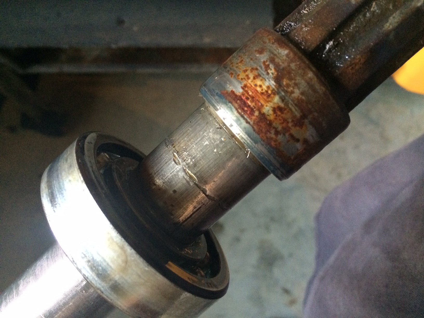

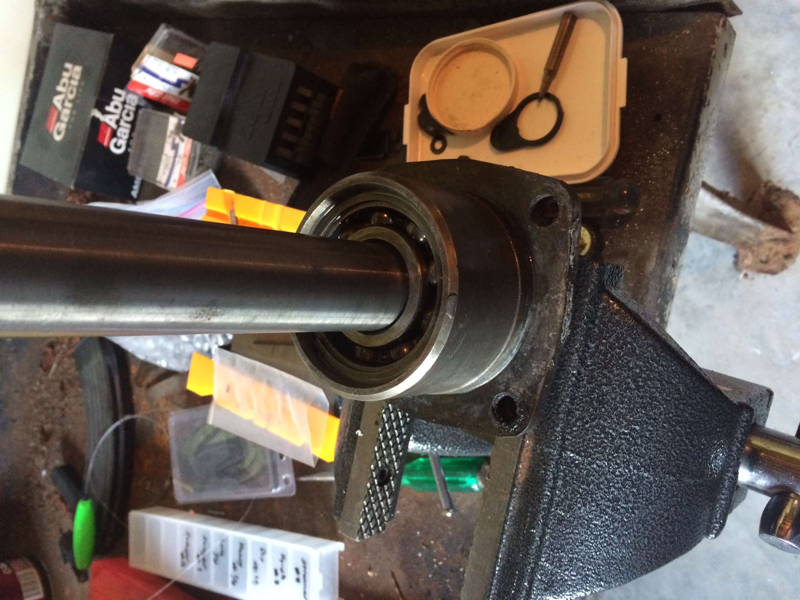

And yes my mistake, it IS a 6 speed. Here are the other pictures I have of the housing and bearing. I can get better pictures in a few days when I head back towards the farm. image2.JPG
Second picture shows how far back the bearing has come un-pressed and also Im guessing where the snap ring use to go.

Bingo... Figured it was going to be a dexta/SD

Based on the photo, I suspect this is not the first time it failed, the ding marks are likely a attempt to lock the bearing in place by peening with a chisel.
If this is the only issue with the shaft I'm sure a good machine shop could repair for a hours labour.

This seems to be my next course of action.
