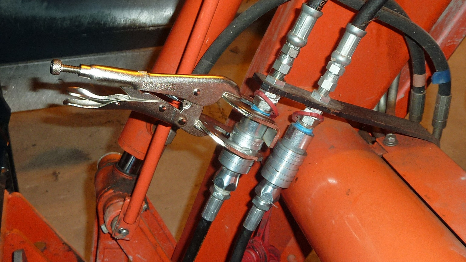

Have you tried just grasping the hose next to the elbow and GIVING IT A HARD PULL? I need to use 2 hands and try to keep the coupling straight as it comes out.
Just give it a yank, the collar stays still, the innards of the rear part slide toward you. Just give it a straight pull!!!!

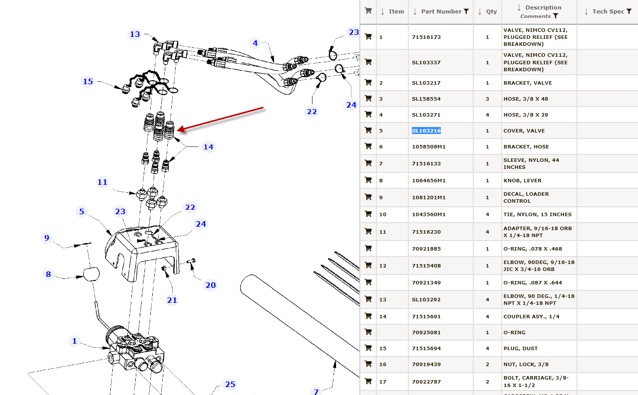

I have unscreew one hose one one of them. so I was left with no presure at all and only the elbo the male and femele. They will not come out.. one things I notice is that the Collar does not spin freeley. it does spin arond the male commection but the Elbow spin at the same time as the Collar. I think it's all rusted oout in there and the coolar kinds a weleded it self with rust. I have also tryed to heat it with a heat gun witout luck. I'll coninue to add more penetrating oil.
I feel that I will have to unscrew all 4 hose and cut the fitting with a angle grainder. that way I'll be eable to acess the Male Screw. I'll un screw the male and have to buy 4 new male and femele.

It's what I think as well I'll have to replace the male and female.the bearing in there must be welded by rust. I'm still hopping to be able to disconnect them so that I could maybe only replace all 4 female. other wise I have to cut the plastic to access the Male to be able to screw them or Cut the fitting with and anglle grinder and with luck I might be able to fit a socket in to access the Male Screw.

You could also maybe use some tin snips (or really heavy scissors, or a jigsaw...?) to cut away the plastic around the fittings so you could access the male parts of the couplers..? Just thinking out loud here. Or, work again at getting those four bolts & nuts off the plastic cover so it could be removed. (Like I said, I just permanently removed mine.)

I was eable to remouved the 4 bolt that hold it. I just don't want a break the plastic. I like things when they look factory... If I can't unclip those callar. I'll call the dealer for and estimate of the part to see what is cheaper. cutting the plastic or cutting the fitting. I might have to cut the plastic eider way...

I found the diagram on ACGO site but it still does not mention what kind of connector they are.
It sound if I want a remouved them i'll have to Cut part 5 and put a wrench on low 14 and 11 and I'll have to buy 4 new part 14 and part 5 but that will be my last step.

No, wait. Don't cut anything just yet. I'm trying to show video I took about noon here in a Wisconsin, showing how to disconnect the couplers.

Grasshopper, can you ROTATE the knurled collars? If so, rotate and blow compressed air in there, to try to remove dirt, rust and junk. After the collar is rotating and clean as possible, try to rotate the elbow, to twist the two parts against each other.
