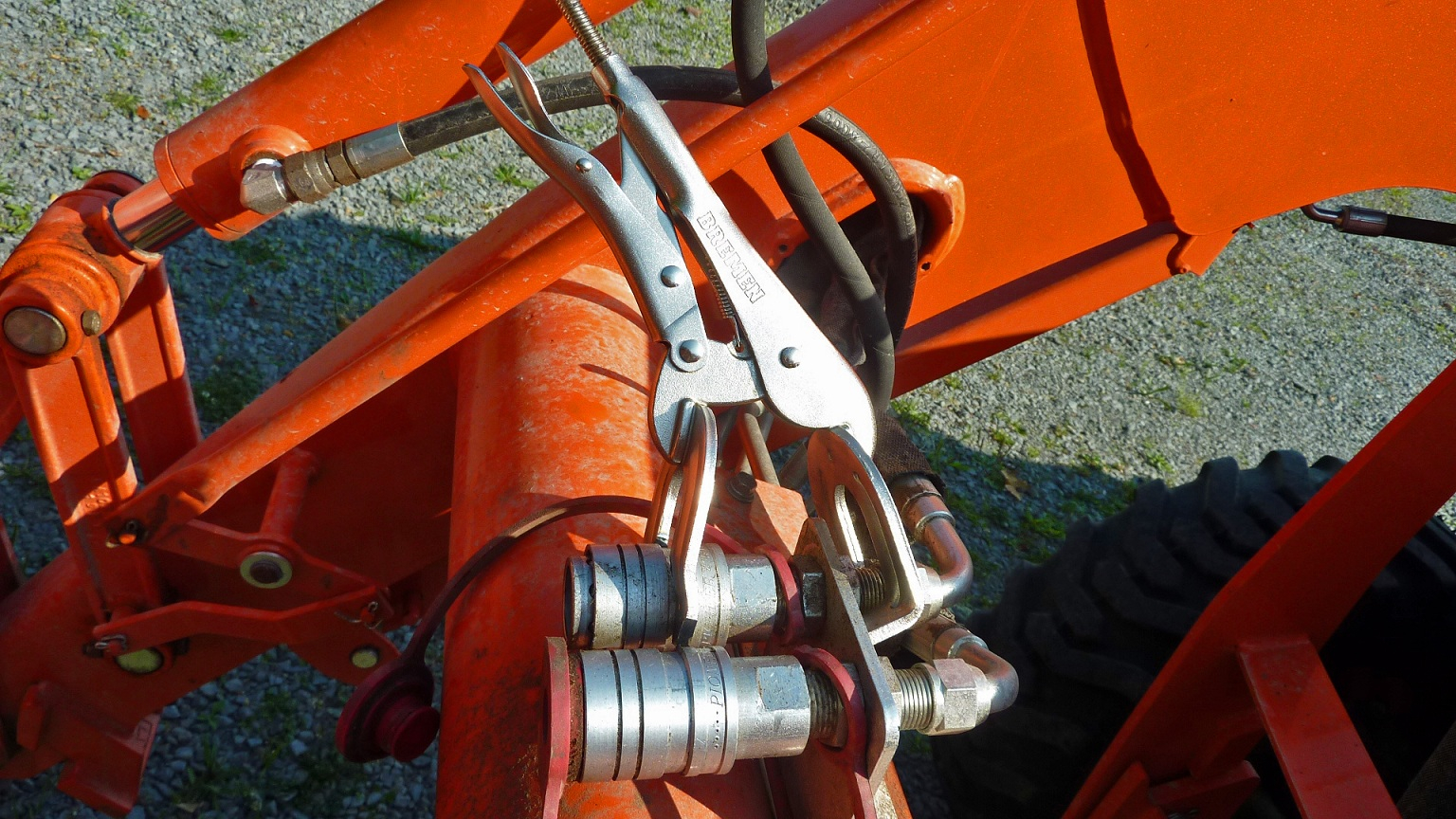

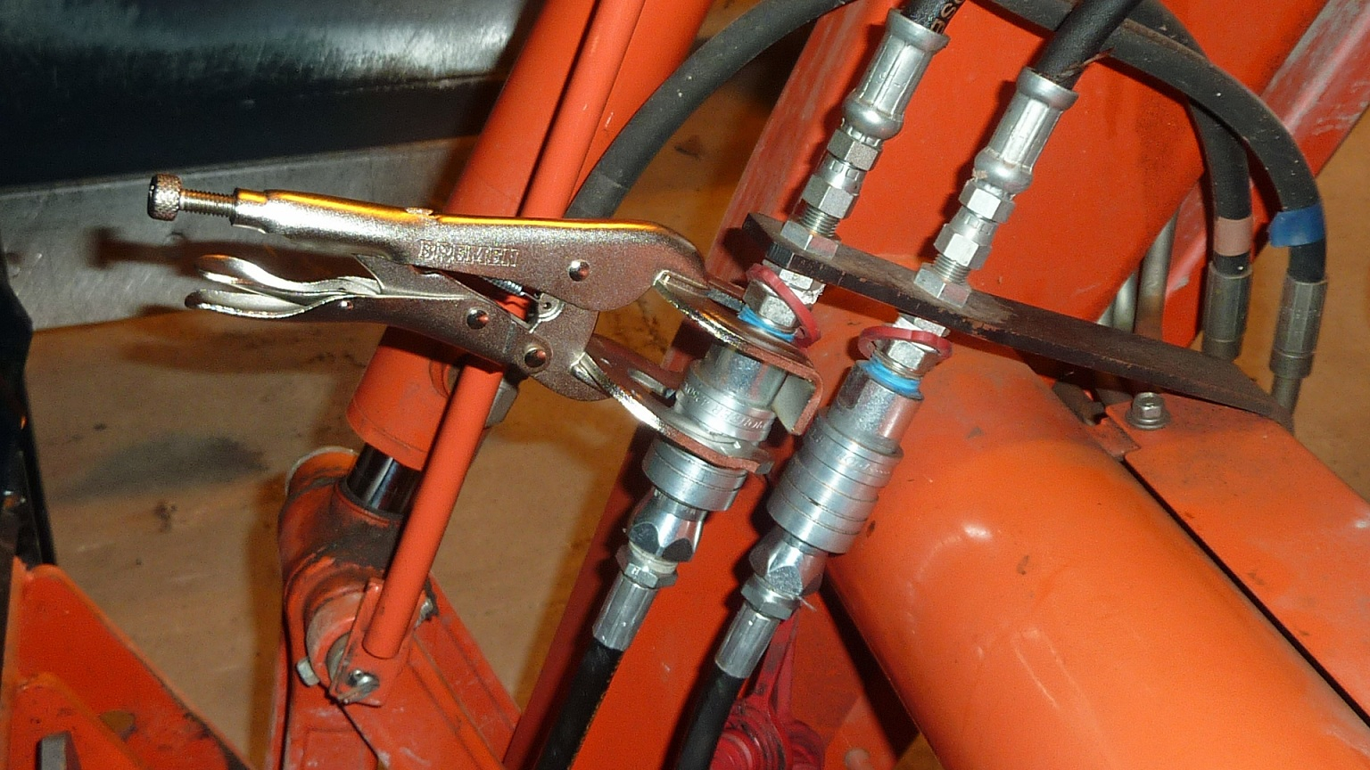

Grasshopper, can you ROTATE the knurled collars? If so, rotate and blow compressed air in there, to try to remove dirt, rust and junk. After the collar is rotating and clean as possible, try to rotate the elbow, to twist the two parts against each other.
yesterday I unscrew one of the hydrolic line. I was left with the Elbow,Coupler femele and male. I was eable to rotate the Elbow,and femele Coupler. I have tap,pry put oil and evrything I could think of. Then I try with somone else To grip on the Elbow and and collar to try to have only the collar rotate... No luck... the collar is sease...

Yeah, if the collar must be slided back to unhook, you need to get that collar loose first.
But with my style of couplers, that collar never moves. ALL the other stuff on either side of the collar shifts, but the collar is securely fastened to the bracket. It cannot move or turn.
I sent you a private message,requesting your email address so I can send you video of how mine unhook.

Are these couplers designed to pull apart if hose catches on something? On my couplers l have to push in then jerk outwards to disconnect.

Actually the couplers may be "Safeway" brand (S40 Series) (AGCO does use them on some loaders) , so check the name & numbers on collar..... [Correction] It appears on my installation the collars on female can go either way to release the male...
   / Can't disconect my Quick Conect Coupler Loader 1520 #37
Actually the couplers may be "Safeway" brand (S40 Series) (AGCO does use them on some loaders) , so check the name & numbers on collar..... Also its odd that the females are on hose and males on valve body puts a hole different slant on how to release them (per diagram in post #28).... Probably need to push down on collar and pull up on hose (elbow) at same time....
my gc2400 uses s40 series on the dl100 loader have to push coupler down then pull collar up to release but thats with collar being on the LOADER side vs tractor side.

Just applying PPlaster or brake cleaner and not rotating the sliding collar while applying it does nothing to dislodge the crud under the sliding collar. Have exactly the same issue with one of my loaders on one of my tractors, it gets crud (dust and stuff) between the sliding collar and the body and requires a flush with PBlaster to dislodge the crud but, the collar has to be rotated while applying the solvent and mine are extremely tight to get to as in no room to work at all.

Does anyone know if the forum will only accept pictures and not video? I have a good video of me pulling them apart and re-hooking them several times, but alas, I'm not smart enough to get them to post here.
I click on the paper clip, go to my photo library and I can attach any of my still pics, but no videos appear in my library.
Or would it have to do with file size, rejecting anything over so many MB?

The couplers would disconnect automatically IF the hose had a straight pull. Alas, the way we are set up with elbows, the coupling will bind up from the side torque and won't release. But yes, on a straight pull, the hose just comes out of the body with no damage.
