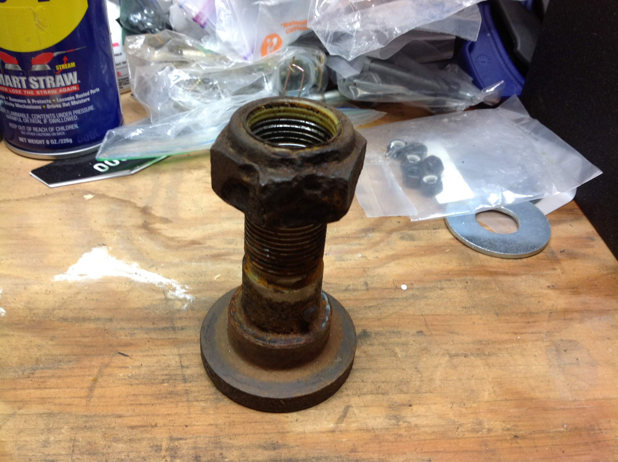

I had trouble getting my blades off at first also. The nuts had been on there for over 20 years and they were badly rusted. I couldn't budge the nut using the "T" handle socket tool supplied with the cutter, even using a 6' section of pipe as a cheater bar. The "T" handle was only about a foot long, so the tool was kind of a joke, considering the torque specs were 350 ft-lbs.

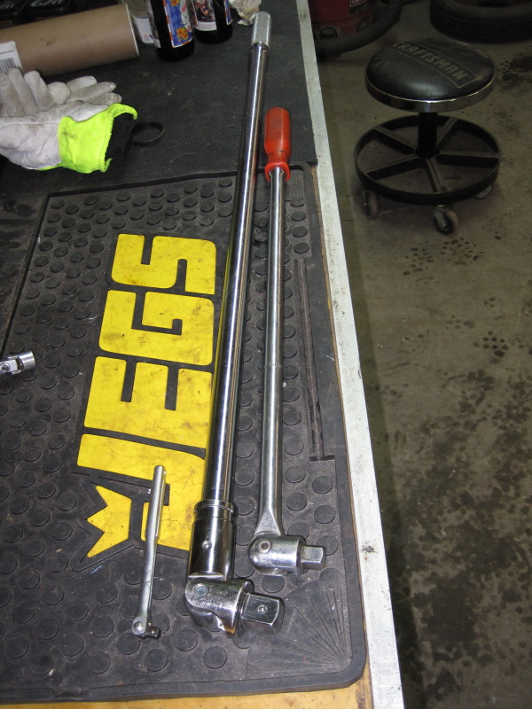

I bought a 40" long 3/4" drive breaker bar and a 3/4" drive impact socket that fit the nut. I heated the nut a little with a propane torch, sprayed some PB Blaster on it while it was hot, and let it sit for a few minutes. The nut came off with no problem. I had to pull hard on it, but with that large breaker bar you can put tremendous torque on the nut. I used this bar:

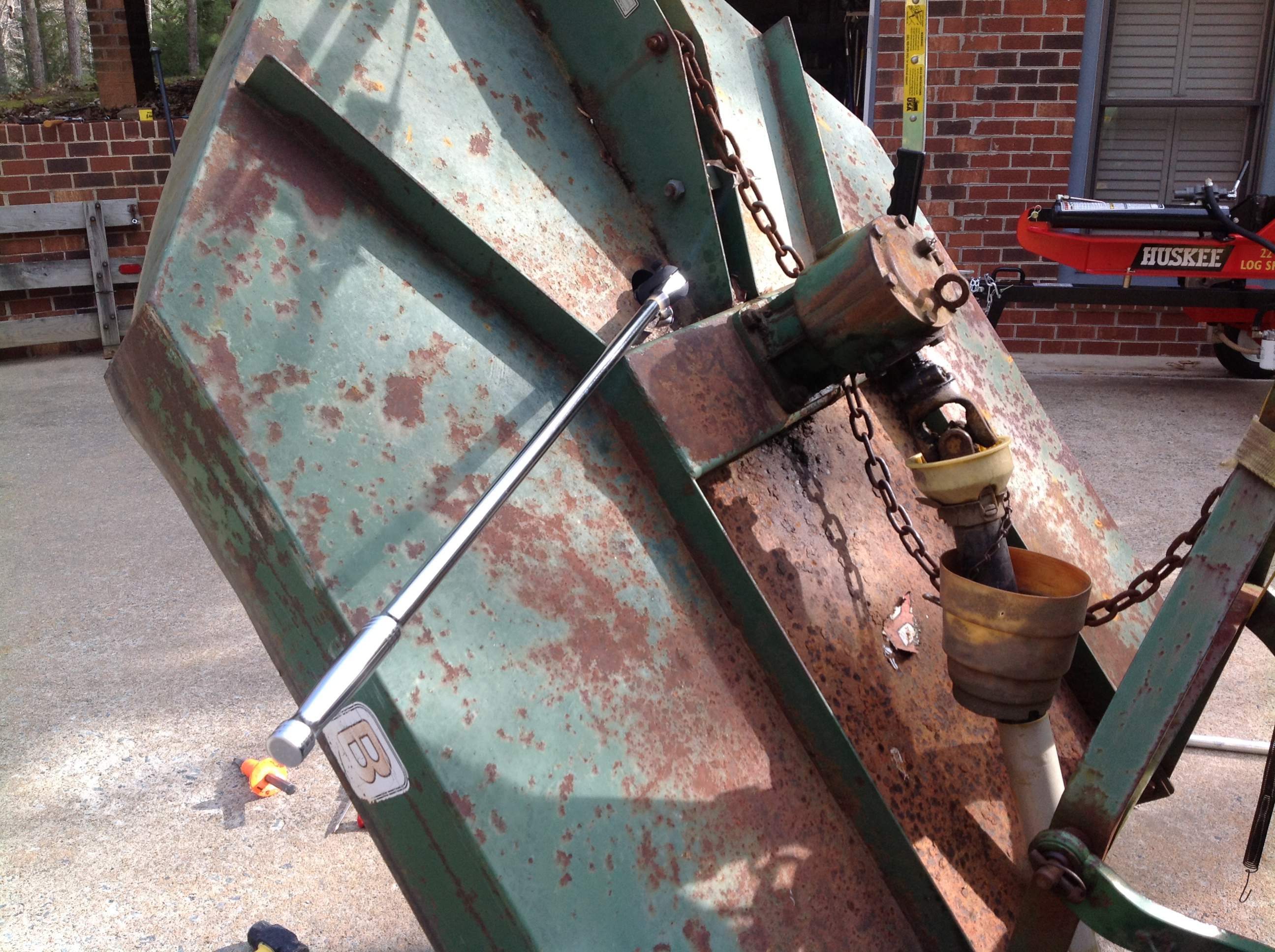

The most important thing was probably getting everything secured so I could bear down on the breaker bar without anything bending or shifting. I attached the cutter to the tractor and used a strap puller to lift up the deck so I could access the blades. I used a pipe to block the blade carrier from turning. Before I did that, things were kind of loose and it was impossible to transfer all the torque to the nut.
Here's a picture of the setup and the old nut.
