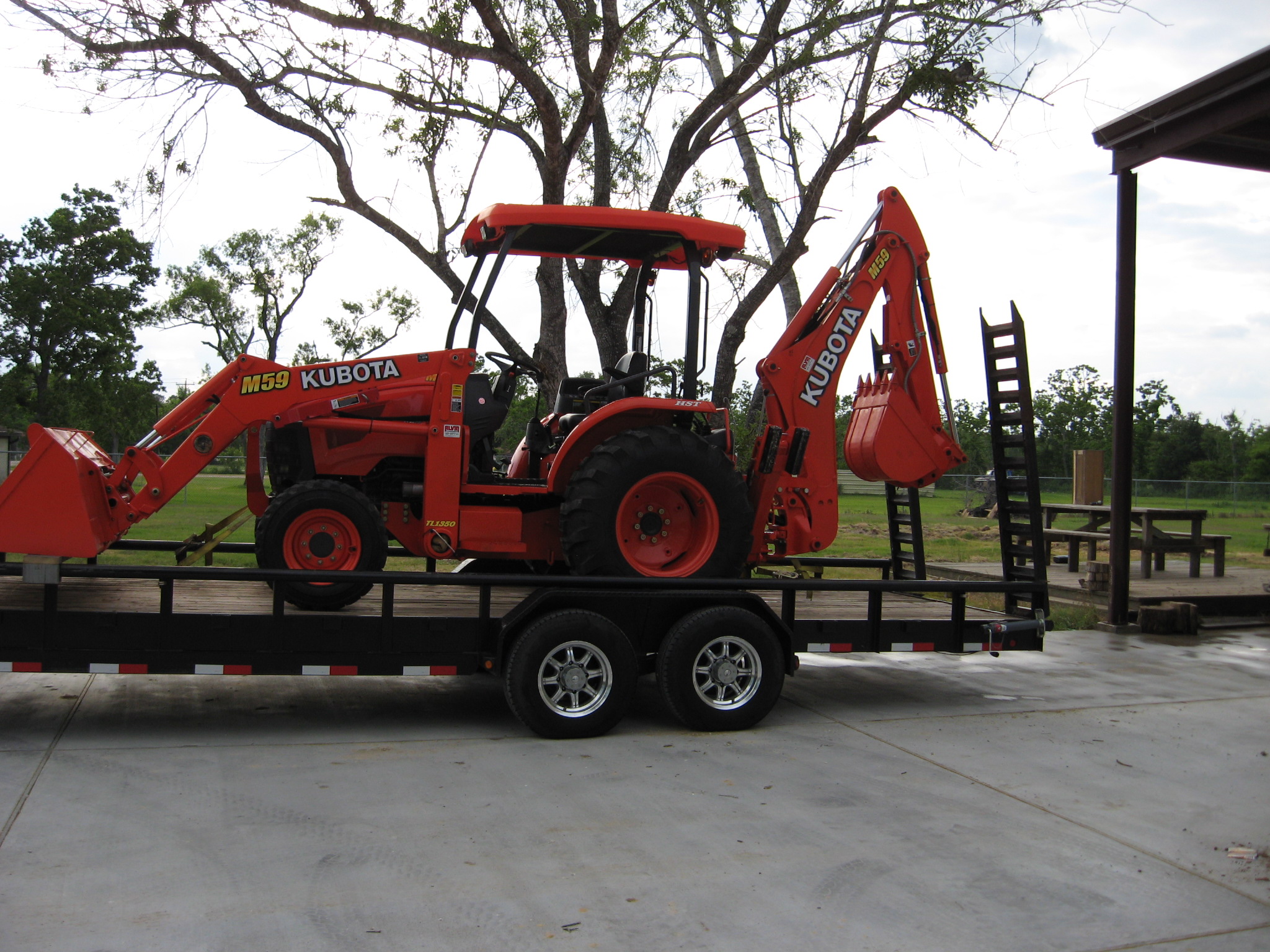

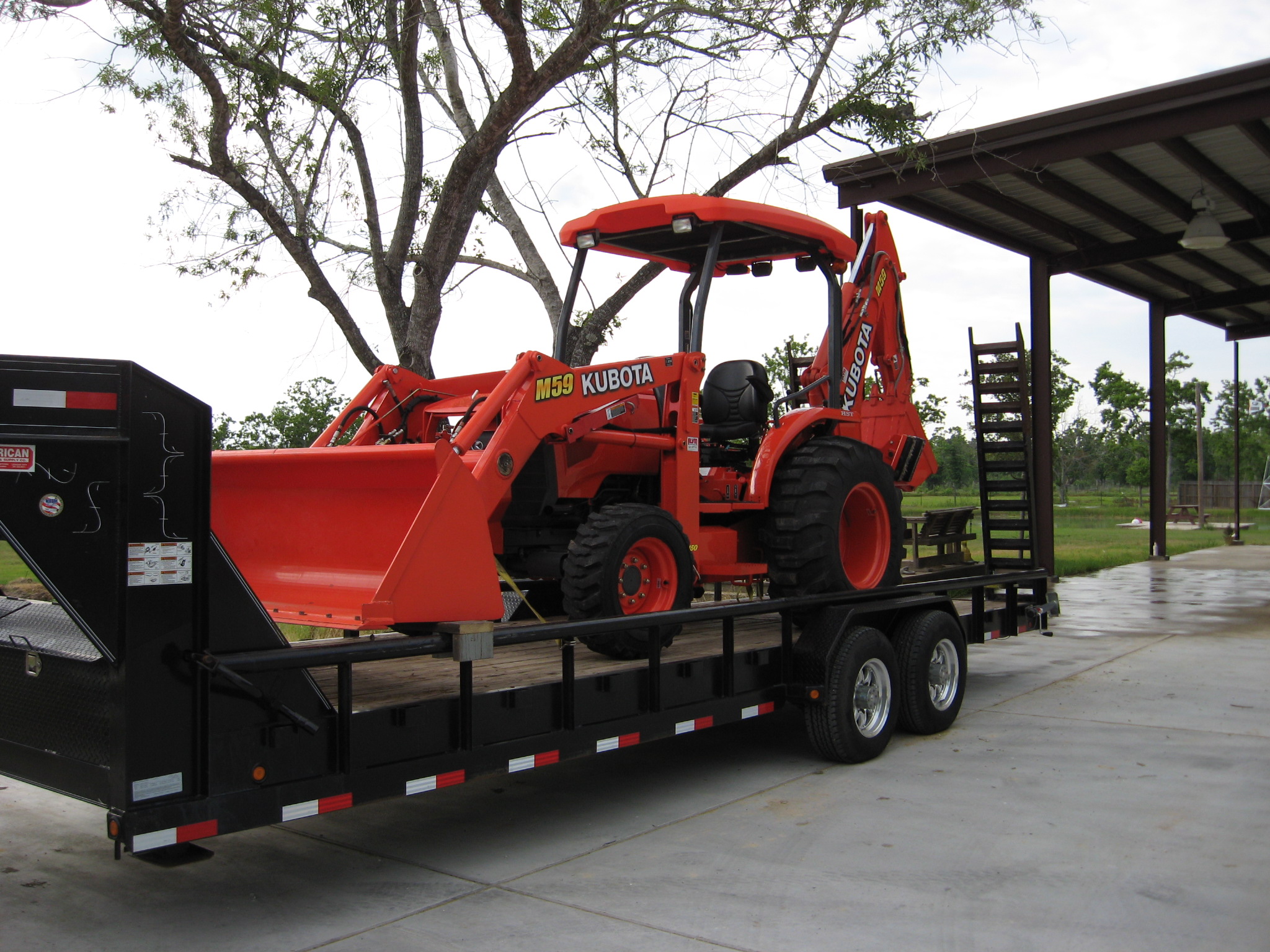

OK, guys. I said it once before...I'm not a fan of speculation.
So I built a simple replica of the situation in AutoCAD to demonstrate the problem and a couple different solutions.
I used fairly conservative parameters based on the OPs input and information available online. I put the deck 24" off the ground (Hudson says 23"). I assumed stock ramps are 5' long. The wheelbase of his tractor is 71", but I put in 72" (even 6 foot). I made the rear-most tip of his backhoe 3 feet behind the rear-most point of his rear tire and put that corner a mere 6" off the ground.
From my model, you can see that even if the stock ramps were extended to 10 feet long (which I wouldn't want to lift or have sticking up during transport), it wouldn't come close to working. I don't even think 12 foot long ramps would work IF they are hinged at the trailer deck.
He needs "sub-ramps".
By my calculation, sub-ramps that are 10' long (properly positioned) or 8' long with a "ledge" at the lower end at least 3 inches tall will allow the point of the backhoe to swing harmlessly in the air as the tractor is loaded.
As I stated before, I have the identical problem, albeit on a smaller scale with my little BX tractor/backhoe, and this is how I solved it. But my sub-ramps are only 8 feet long and could be a little shorter.
I hope everyone finds this information helpful to the discussion.
Even more, I hope the OP tries it with a few 2 x 12s and tells us that it works!!!
Very nice work Keith. The issue is I said he would have to back up the ramps and onto the trailer. Can you run some models that way with say adding 2' to 3' to the factory ramps. Remember that the BH will fit in between the 2 ramps so all that will be a factor is the trailer deck.
I could see in my head that pulling on forward was just not going to work without mile long ramps since his BH extends 3' and is only 6" off the ground.

   / Can't load my tractor! #88
Hmmm, How much lower can he get the back of trailer down? with trailer still hooked up to truck and jack it up, wouldnt the back go down at leat 2 to 5 inches? I still think using hydraulics to do the work for you is the best thing to do.
Why not drive the truck rear tires on couple of 2X12's? jack up the trailer still attached to truck as far as you can . put a couple 2X12X12 under the ramps. Drive tractor up. I betcha by this time you might only need couple more inches more to get tractor on trailer. Just get outrigger down, use the BH bucket to push up 2" up and in. done!.
This seems so perplexing that it can't be that difficult to get it on. perhaps the OP can take a video and post on youtube ?
   / Can't load my tractor! #89
I dont have auto cad or even a manual cad :D.. Seriously I had the exact same problem with my Kubota L5240 and woods BH95. I had removable ramps I think they where 5' I made some redneck ramps out of 2x6's with a 4x6 stacked they had rope handles and work fair. By ramps I mean they laid flat on the ground the added height of the 2x4 and 4x6 atop each other.
I found myself trailering my tractor more and more after a few near misses with the board cribing a buddy offered a fix easier on the back and safer.
He added 3' and mounted the ramps to the rear of the trailer with a spring assist. It is the best thing I have ever done to the trailer the approach and departure angle very much better and no more b/h dragging.
Digging a hole is a great idea if you are seldom going to have to trailer it. I dont advise loading with trailer disconnected done it once did not like it.
Anyhow they do stick up rather high and are somewhat fugly but they work great..
Good luck which ever route you take.
   / Can't load my tractor! #90
Chuck your fix is just what I am proposing. I still think he will have to back on but we did the spring thing also on the trailer ramps I modified using stock garage door springs. He can put the ramps up with a single finger.
Chris
