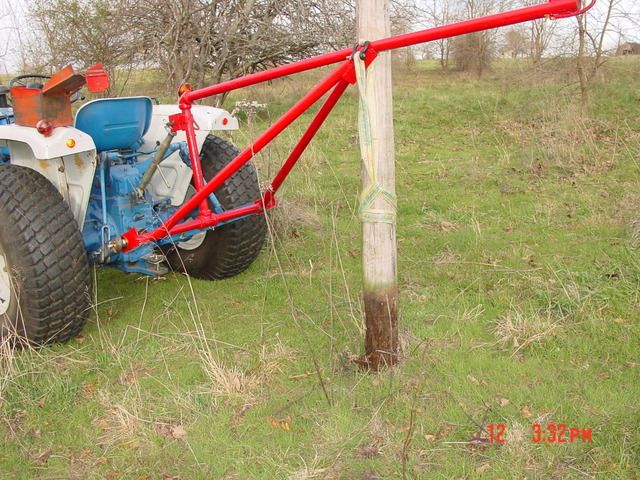

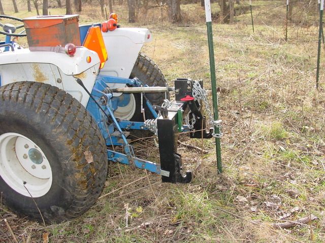

A minimum attachment would be a drawbar:
CountyLine® Cross Drawbar, Category 1, 3/4 in. dia. - Tractor Supply Online Store
or a lever:
Rocking Seven Mile Ranch: Ranch Work and Calving
or hire a caber picker:

I have an attachment made of 3x3x.25 tubing that attaches to my 3 point hitch. More complicated than a drawbar but I attach a chain to that frame of 3x3 and loop it around the fence post. Sometimes I have to rock the post to loosen it up. I do try these tasks after a good week of soaking rains. The loader never works for me unless termites and rot have helped eat away at the buried part of the post.
