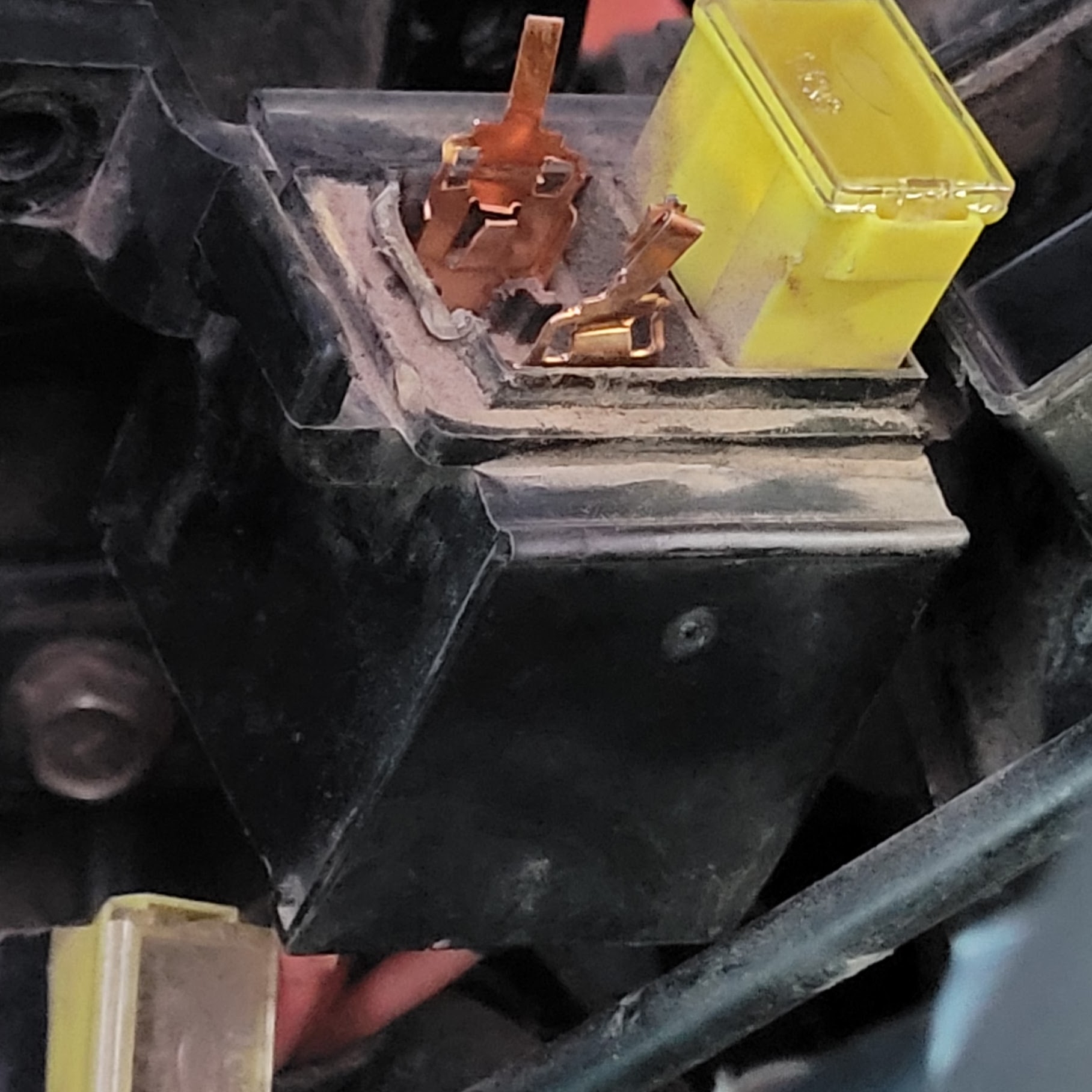

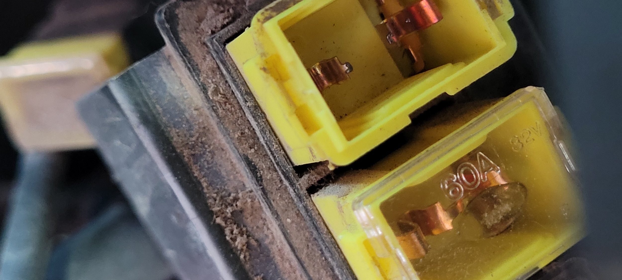

I blew a 60A slow blow fuse on my DK4210SE, embarrassingly I cannot pull the fuse out of the fuse box. I tried for almost an hour to pry it out, wiggle it out, pull it out etc. It will wiggle like it's ready to come out but I cannot get it to pull out I eventually pulled the yellow casing out and the stabs are still in there (came right out of the casing). I don't see any nuts holding them in, it's on the right hand side closest to the loader arm (there is another yellow slow blow fuse beside this housing). The housing holds 2 60A fuses, all I think of is the fuse stabs have "welded" themselves to their female holder. Anyone else removed one of there? I think I'm going to have to solder in a different type of 60A fuse cause this is ridiculous. Suggestions?

I've had those type of high amp fuses blow in vehicles, and they are mounted from underneath with screws. You'll probably have to disassemble the fuse block to get to the screws.
I can't see what type of fuse you have but some of those are held in with a "bolt" that goes thru a hole in the bottom of each fuse leg. It sounds like that's what is going on for you because the other style that just pushes in, shouldn't have the amount of resistance that you are describing.

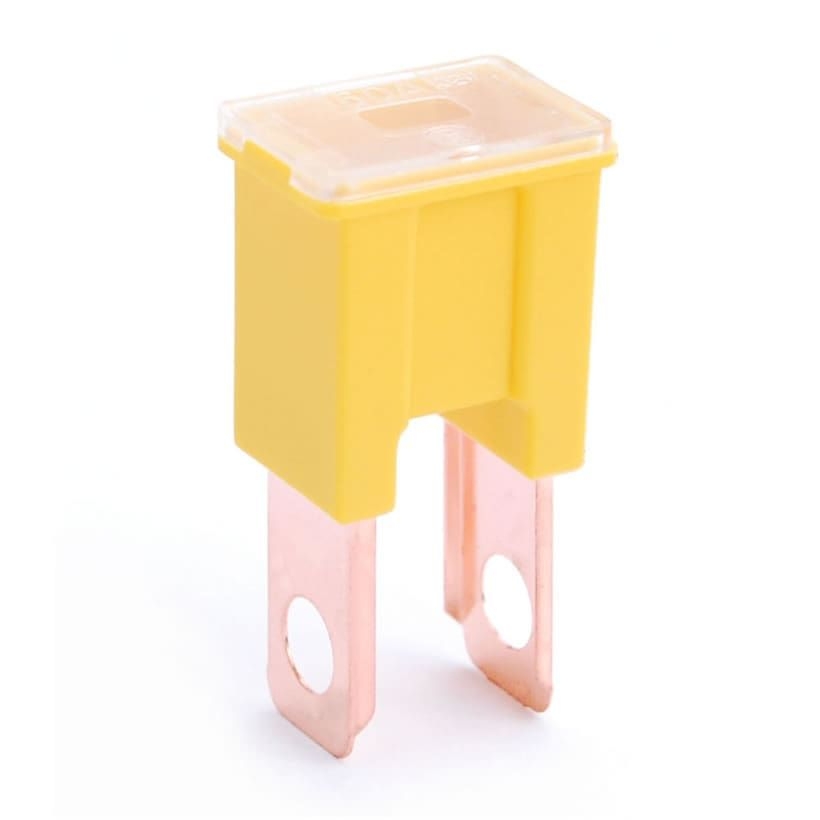

Is this the type of bolt in fuse that is being described?

That's the one I was trying to explain. In the link I posted, you can see it and the bolts in the fuse box. It is not easily accessed. PITA!

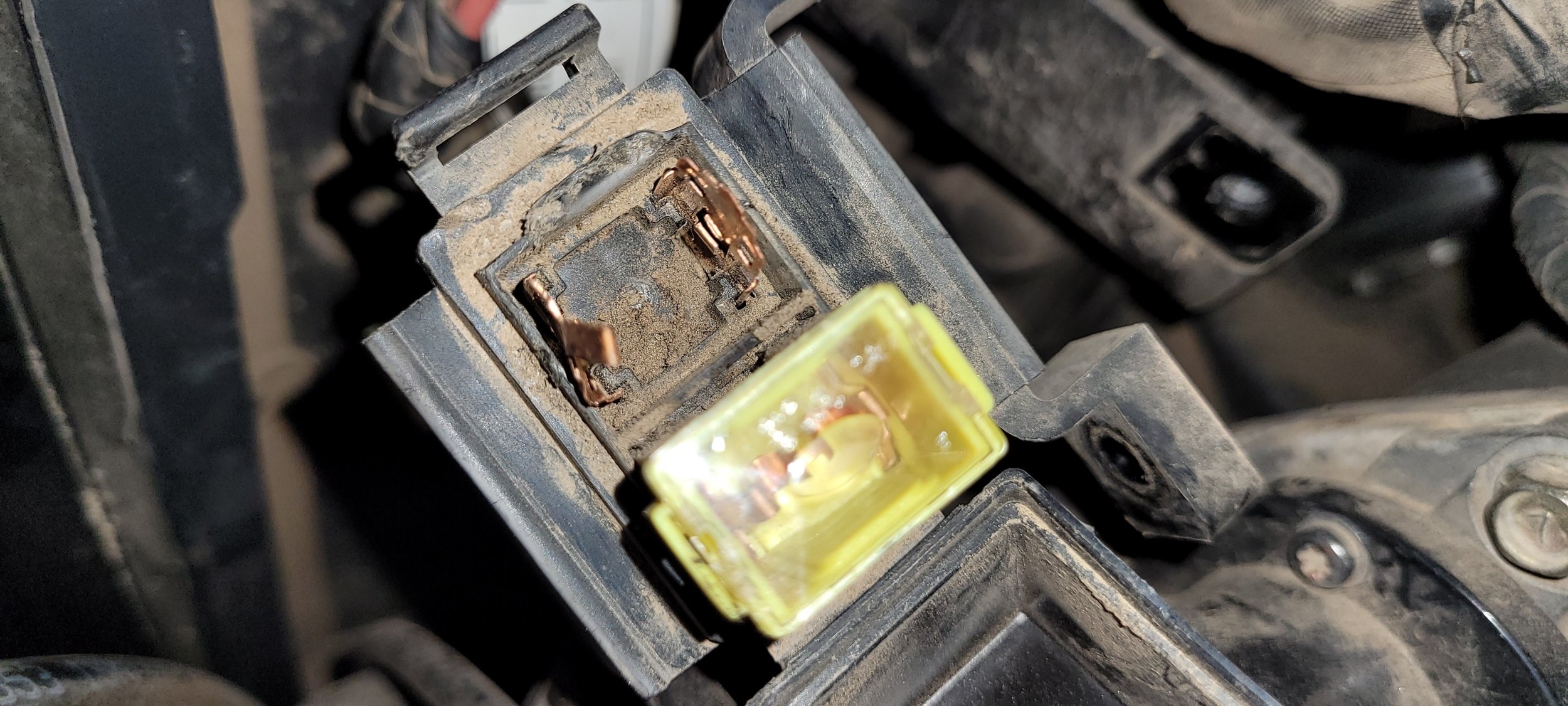

Thanks for your replies, as I was farting around with it again today I accidently hit the bottom on the fuse box, and it snapped open, from the side (eventually the box opened 3 ways... revealing the screws to take the fuse out, it was hidden and not visible at all pure accident, but thank you all!

Yep, the first time I personally encountered one of those myself, I struggled with it a long time before I discovered that it was bolted in!
