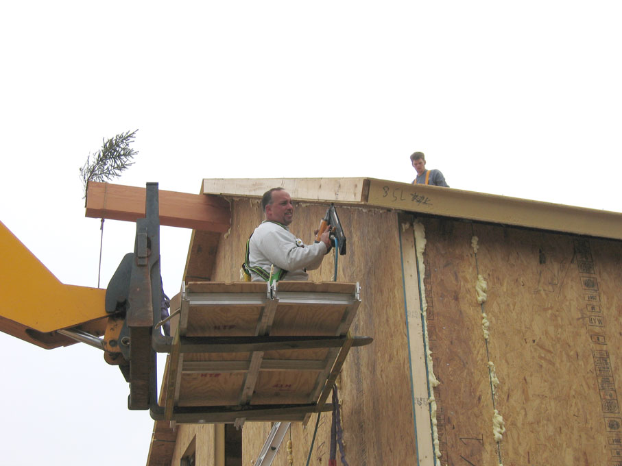

#144
With this side of roof panels on, it's time to install the 2x6 edge framing. Also helps lock and align the adjacent panels on the gable end. Note the clever little work platform on the site fork lift.

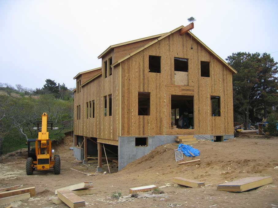

#145
Here's a photo of the barn with all the wall and roof panels finally put on.

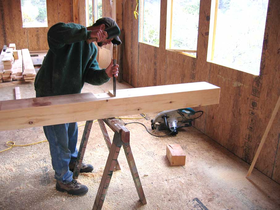

#146
Now that all the panels are on, it's time to tackle a few touch up tasks. One of the joist beams for the loft floor was cut incorrectly, so here it is being recut and the mortices finished off by hand.
