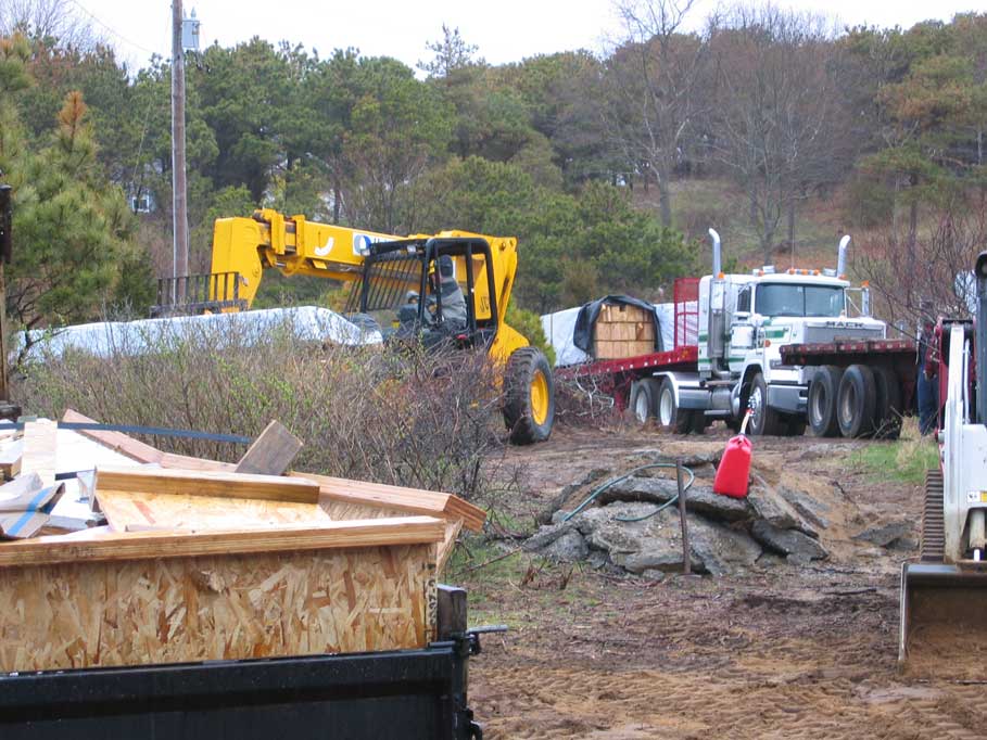

Second course of roof panels going on, with assistance of the crane. You'll notice how the outside edges have been routed out to accept a 2x6 for edge framing.

bebster, I noticed a few pieces of waste SIPS on the ground. Did you cut out the windows on site or have them precut according to your plan? The SIP distributor to whom I was talking said it would be more economical to cut them ourselves -- I think he mentioned something like $35 per cut to have the factory do it. He had a nifty attachment for a skill saw on display; looked like a small chain saw, and was designed to cut the OSB and foam.
Same question for the angles under the gable ends -- pre-cut at the factory or did you do it?
I guess what impresses me the most is that you essentially have TWO structural processes -- the SIPS are structural in and of themselves, and you have them mounted on a structural timber frame. I guess that thing's not going anywhere soon...
/ Cape Cod Barn
#152
The final exterior will be pre-dipped white cedar shingles. Pre-dipped to make them look a little weathered and gray as well as to preserve them better (and no need to paint). The trim is cedar that has been pre-stained with preservative before applying. I'm hoping to avoid painting this thing during my lifetime! Hopefully we get it done before the cold weather sets in.
The SIPs were originally planned to be factory cut, but they screwed up and were late. So I had them shipped on site uncut. We proceeded to cut them for window/door openings, but that wasn't too bad at all. BUT, you need to route out around the openings 1 1/2" so a 2x4 can be nailed in to provide a frame for the windows to nail to. This routing is the worst job I've ever seen! The panel company sells a grinder with a paddle like blade the routes out the foam, but it gets everywhere! It will be a year before I can get it all out of the bushes, etc. It will be short money to have it done in the factory, and I'd have it done that way again if I had the time.
