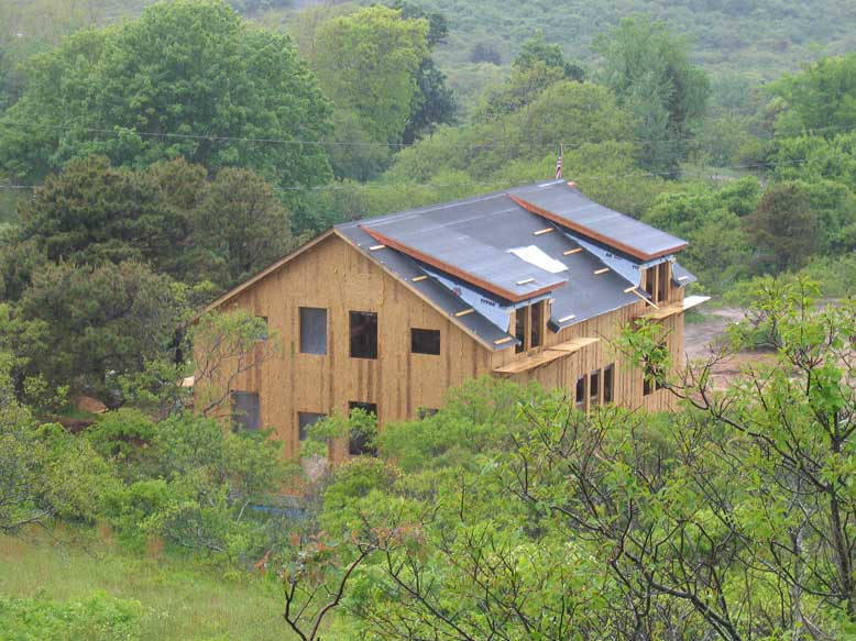

A few more photos.... This one is of the roof with "ice and water" shield applied all over it. Finally no water coming through the roof and it stays dry inside.

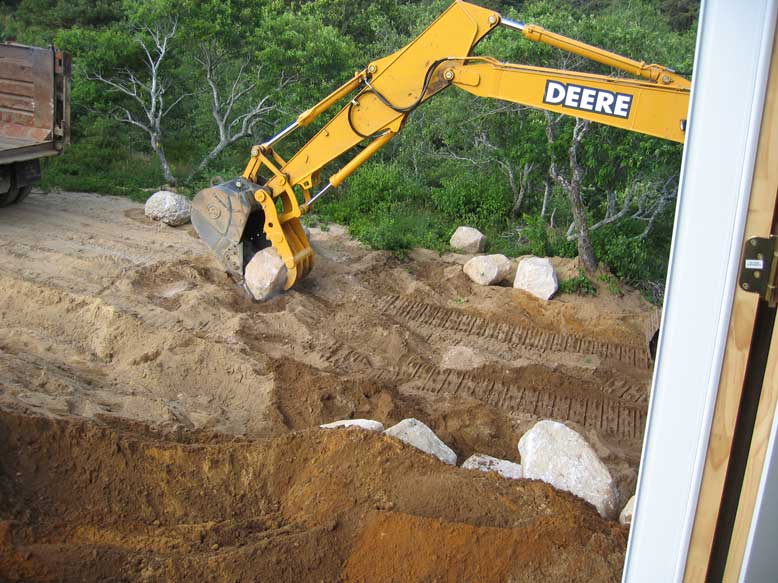

Needed to put in a retaining wall because the grade drops down from the main floor level to the drive out garage level. The excavators used their machine to build a wall out of boulders. The operator would pickup a big rock with the bucket and thumb like you and I would a 5 lb one, spin it around and set it in place.

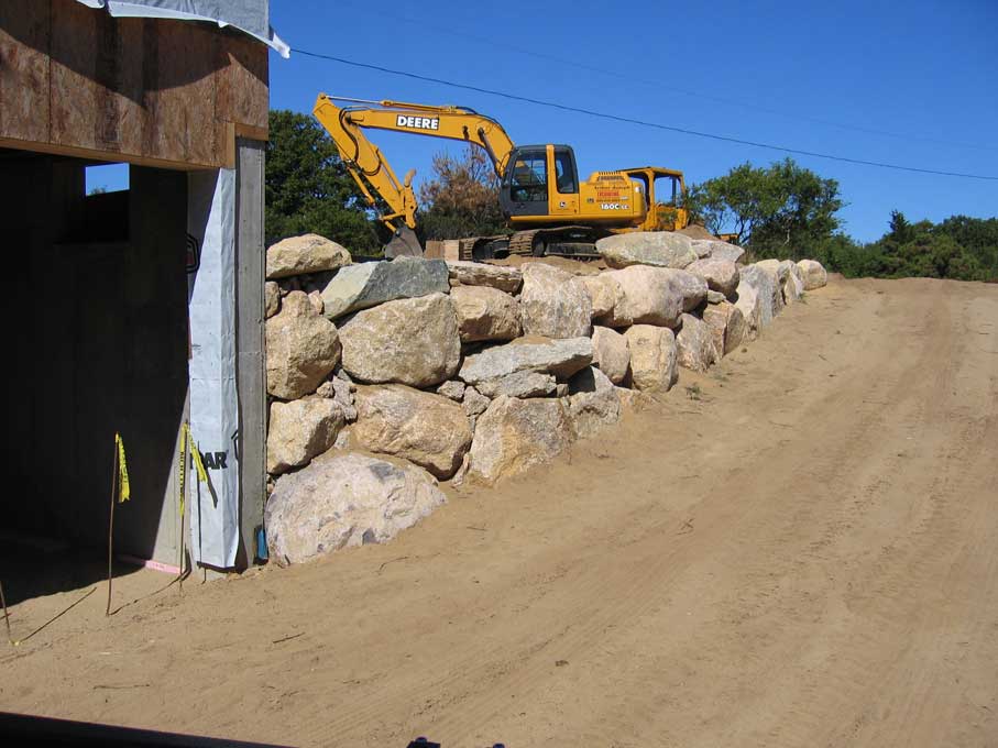

   / Cape Cod Barn
#159
Placing the boulder onto the NE corner wall...
   / Cape Cod Barn
#160
NE corner boulder retaining wall completed. Took less than a day. Very cost effective and the look goes great I think with the barn.
