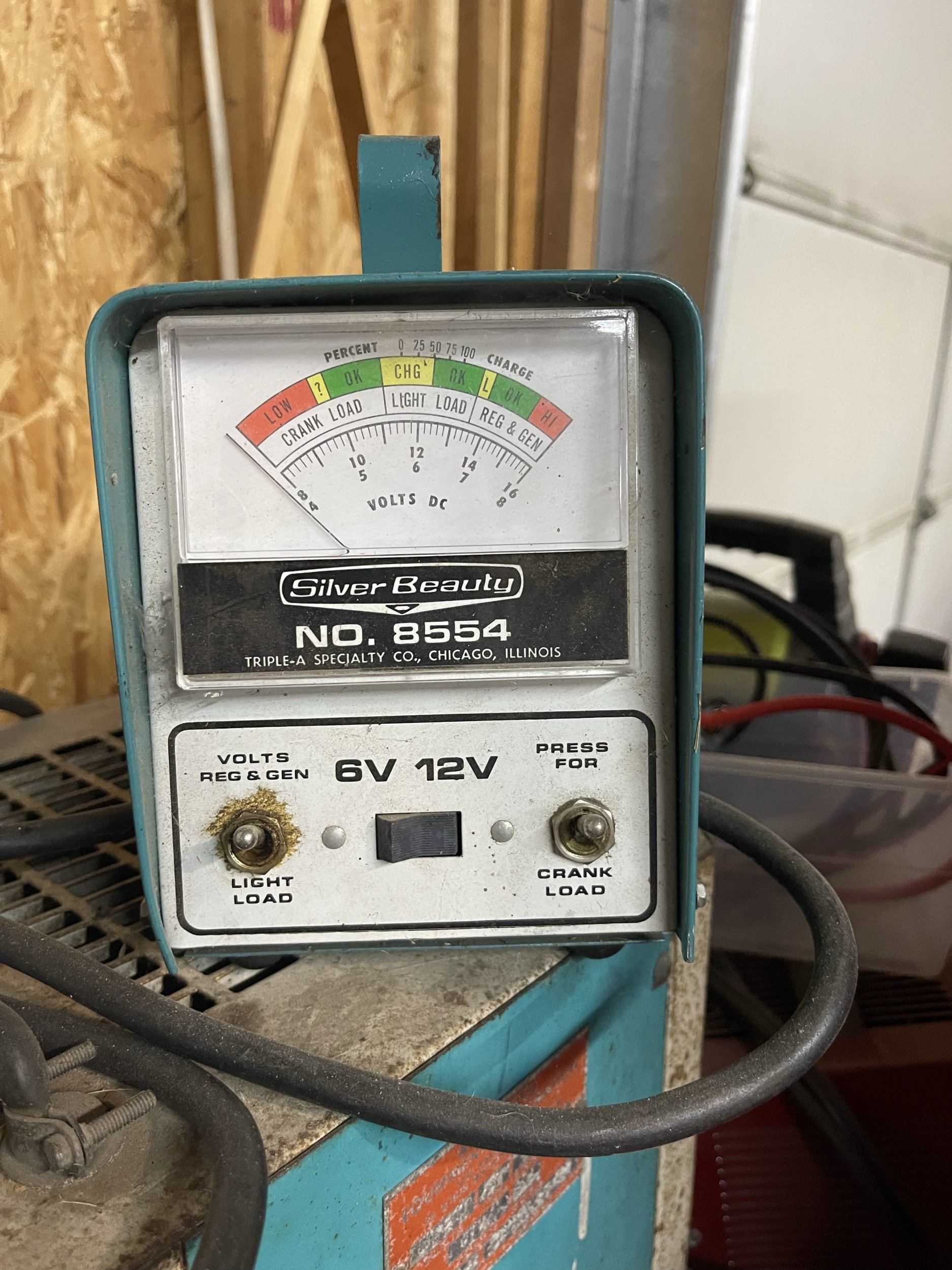

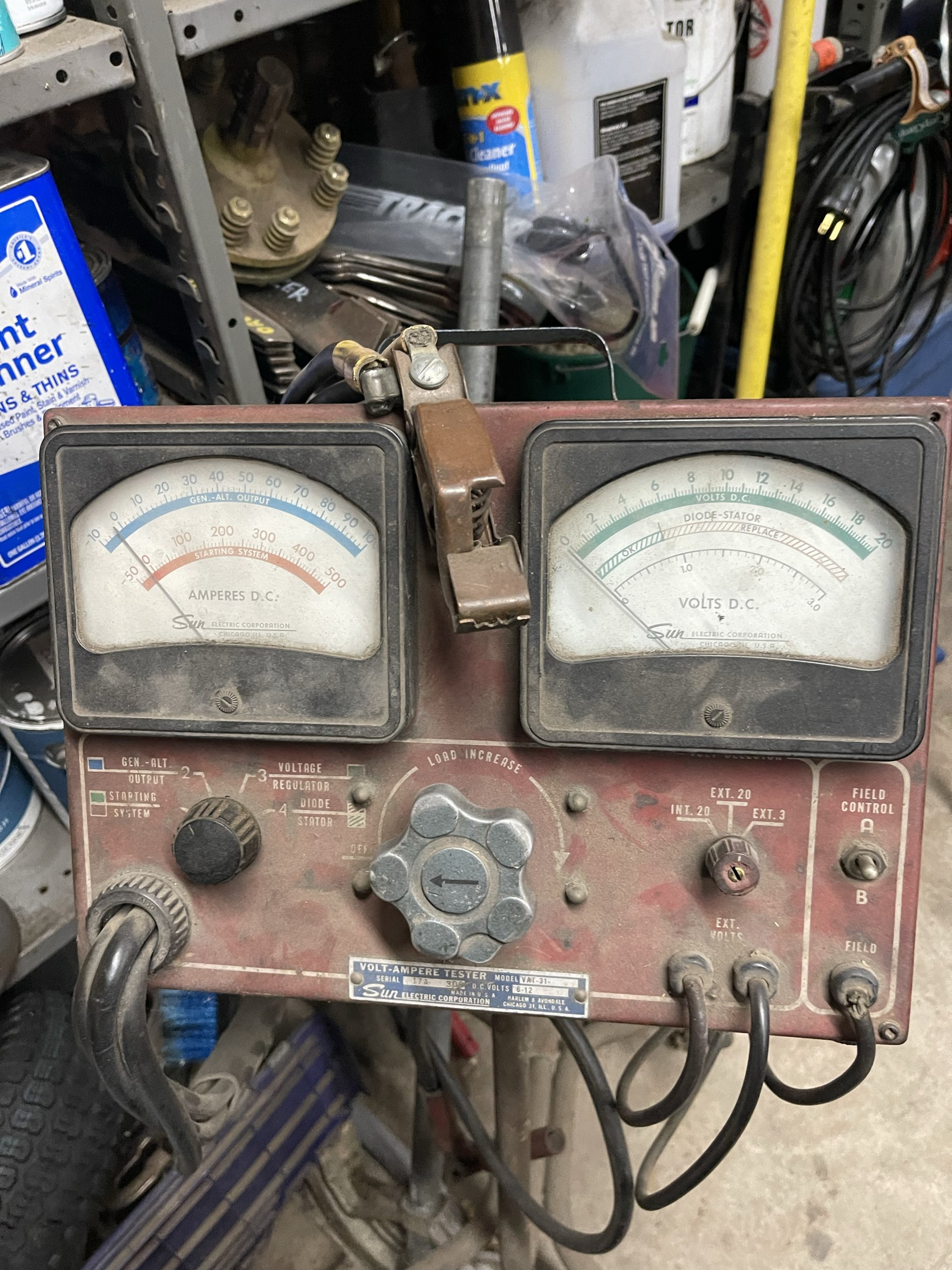

I have an old school load tester. It will ferret out a dead battery every time.
