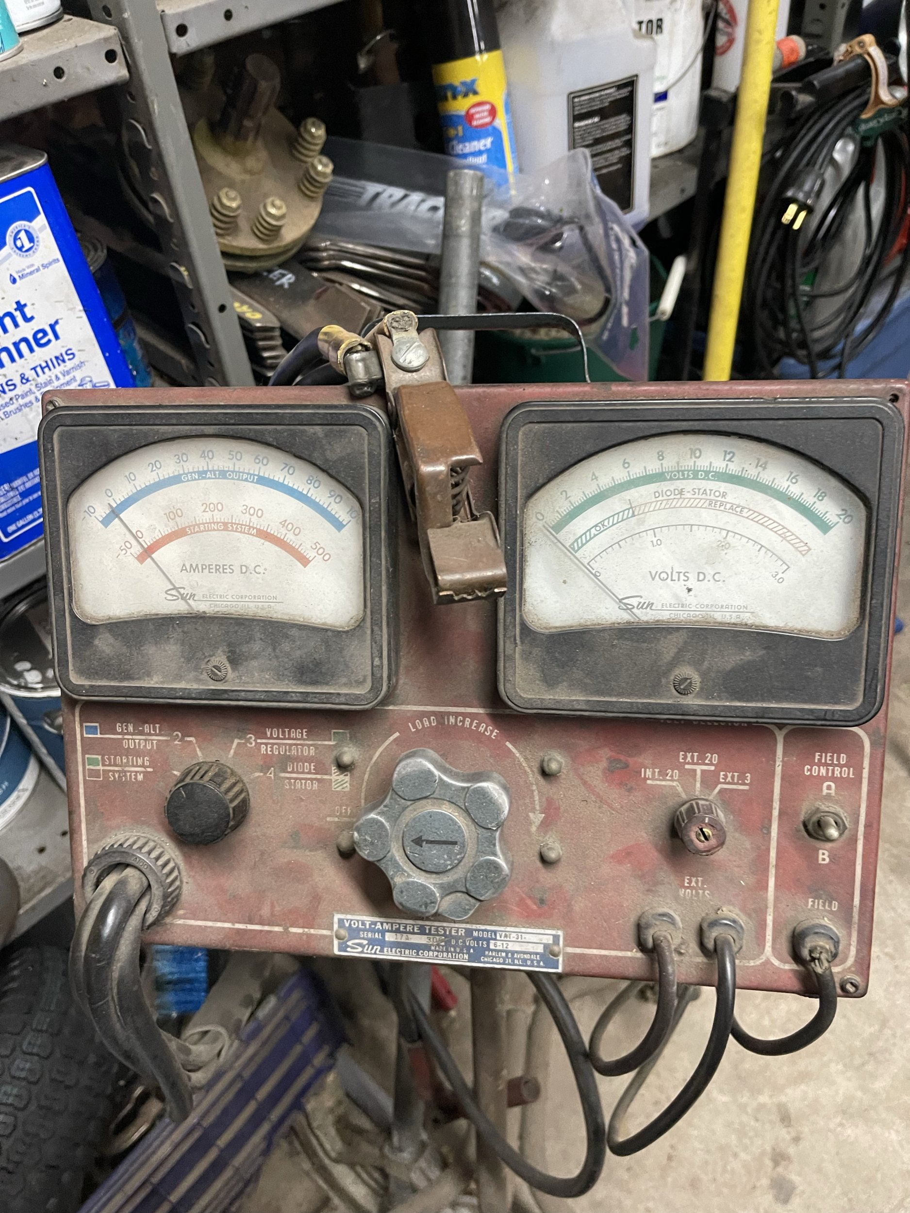

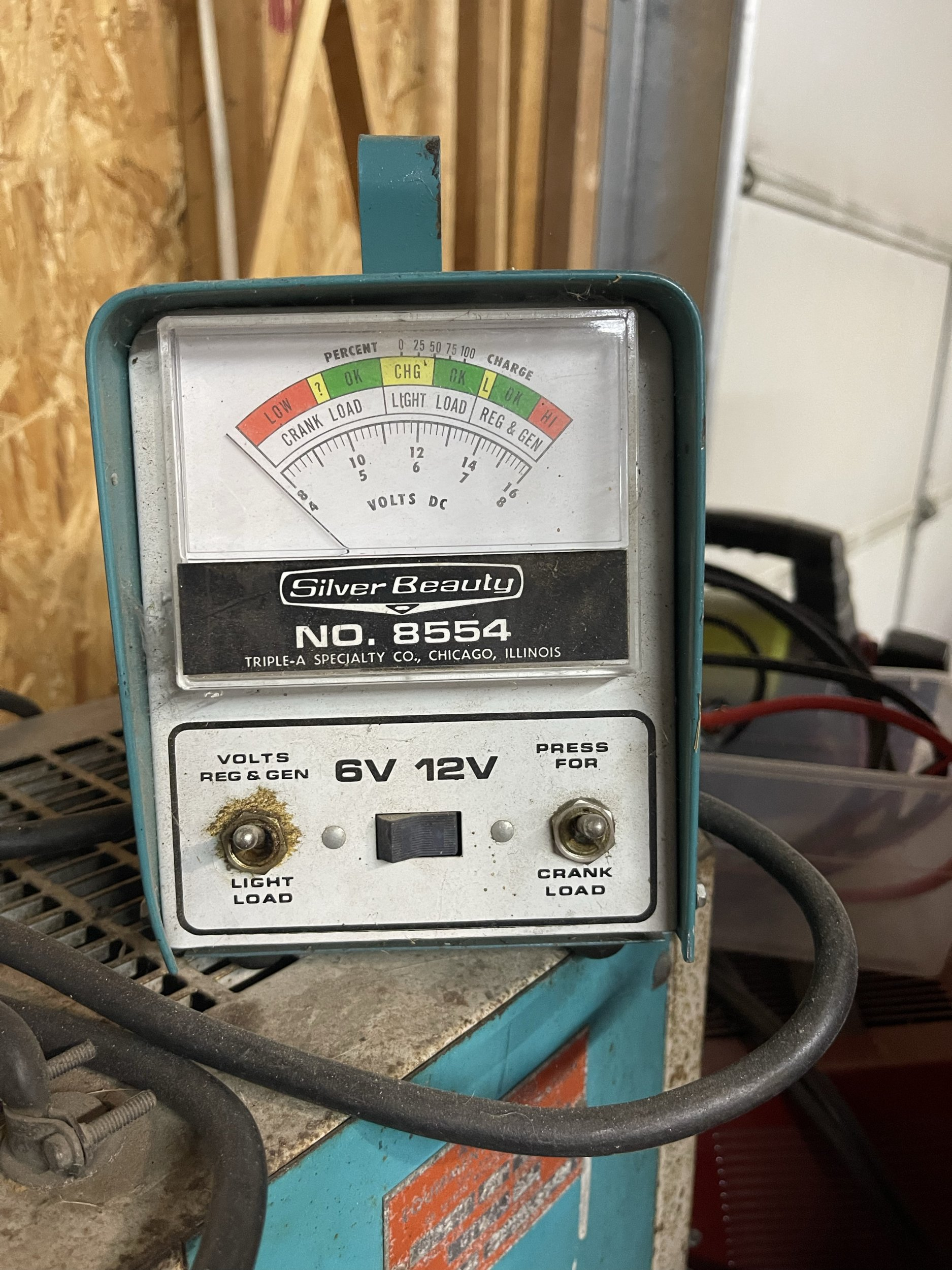

An old school load tester is definitely viable, I have two of them.
But the impedance tester that I linked to is far better for testing a battery, isn’t as dependent on state of charge and is much cheaper. So for someone without any way to test a battery, it definitely would be my suggestion.

That Sun is one old piece. I remember using the old Sun that rolled from a steel beam in the shop, timing, points, rpm, emmisions, coils, plugs etc. Boy, things have changed.
Yes, I have had it for probably close to 50 years, but as it’s a carbon pile load, it works as good as the day I got it, just doesn’t get used as often!

I have an old school Sears auto analyzer that checks point dwell, timing, RPMs, and battery. The only thing I use it for now is testing batteries. It would be useful for someone who works on classic cars. On the battery issue, I have found that the dual batteries in my Dodge/Cummins truck last many more years than a single battery in my gas fueled vehicles.
