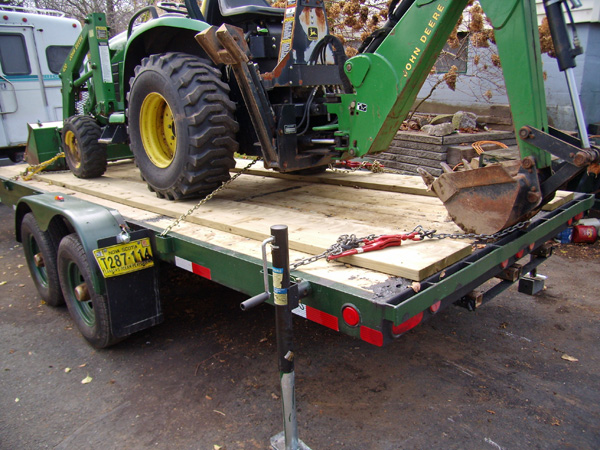

What's with the extra planks under the tractor?
   / Car hauler or Equipment Trailer for my Tractor? #22
what extra planks are ya seeing? are you talking about the nh with the hoe on it?

Someone may notice the blue floor jack up front of the trailer. I loaded the tractor and was preparing to disconnect the trailer from the truck. I then used the jack to lower the tongue onto the ball weight scale to take a reading of actual tongue weight. I did put the ramps up in place before I did that.

The jacks are removable, They slip over a piece of pipe and are held in place with a pin. I just pull the pin and spin them to the horizontal position. I think they are rated at 5000 pounds. [ At least I hope I spin them before starting!]
If you look at the other photo you will see a piece of stub pipe welded to the top of the rail. This is for holding the tongue jack and is the same for the rears.
The extra planks are for a better distribution of the load. I thought this type of thing was quite common??
:D
We always called those planks - "scab planks". Sacrificial lumber that saves your trailer deck from the beating that equipment will dish out over time.
