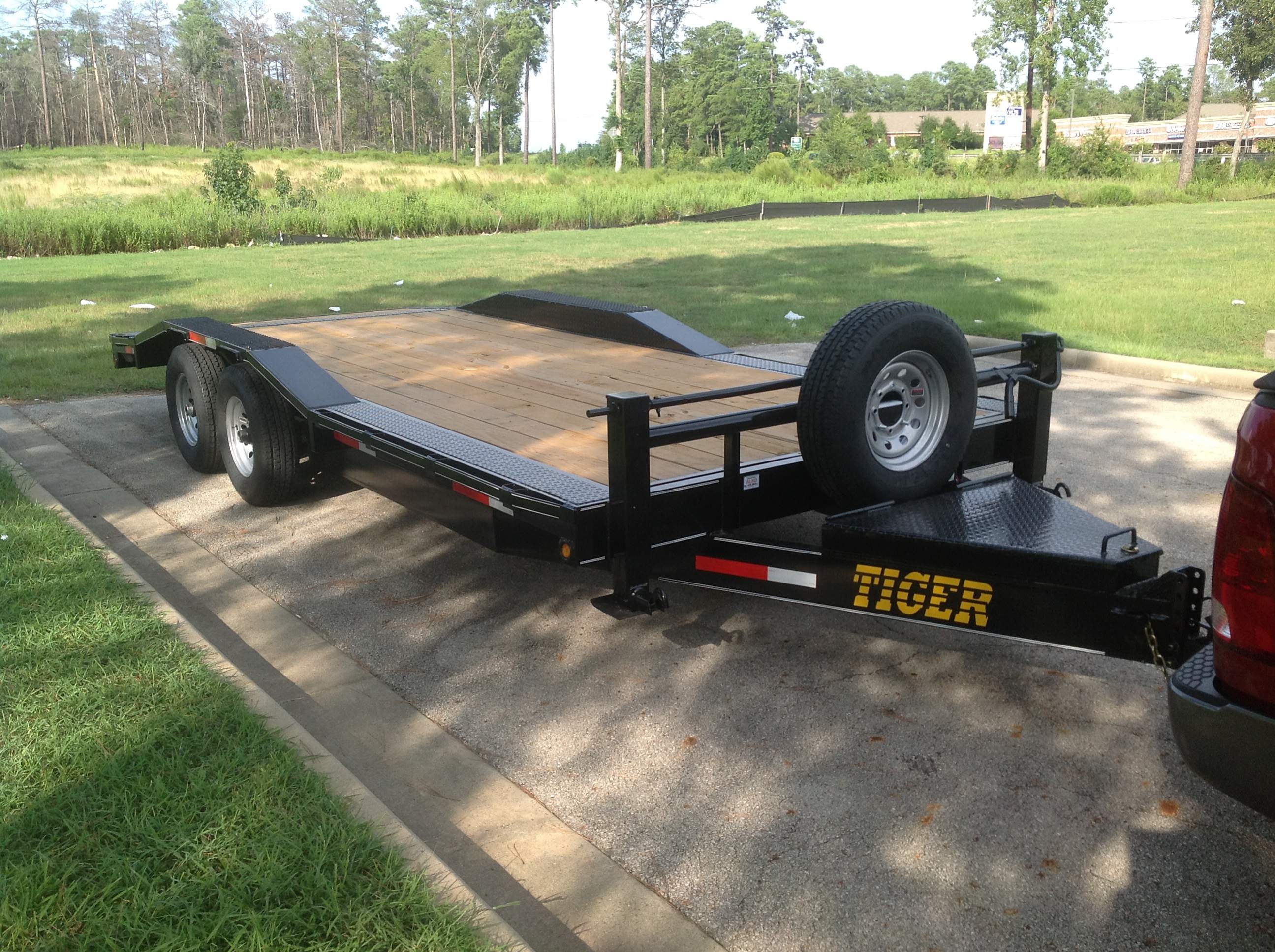

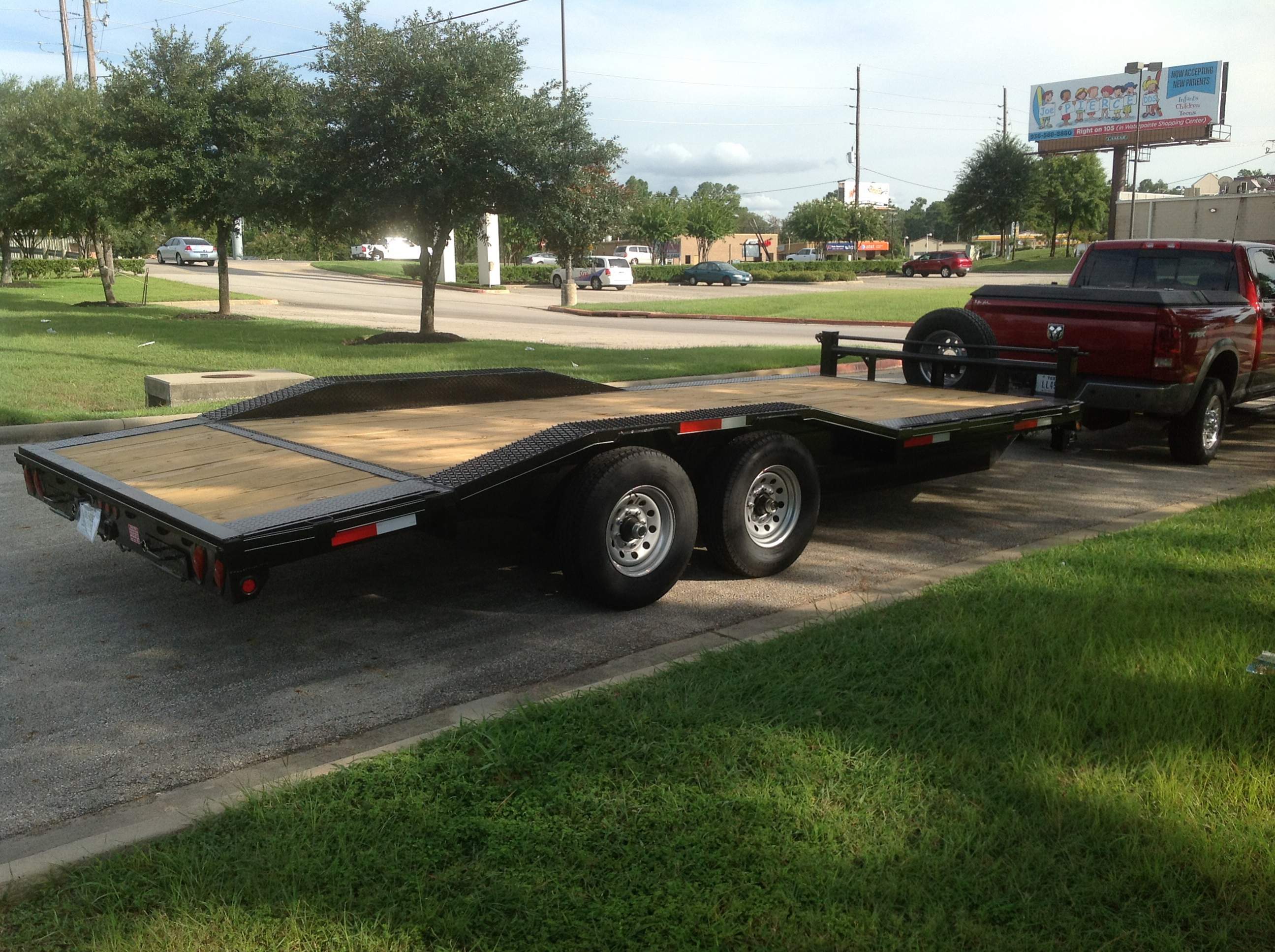

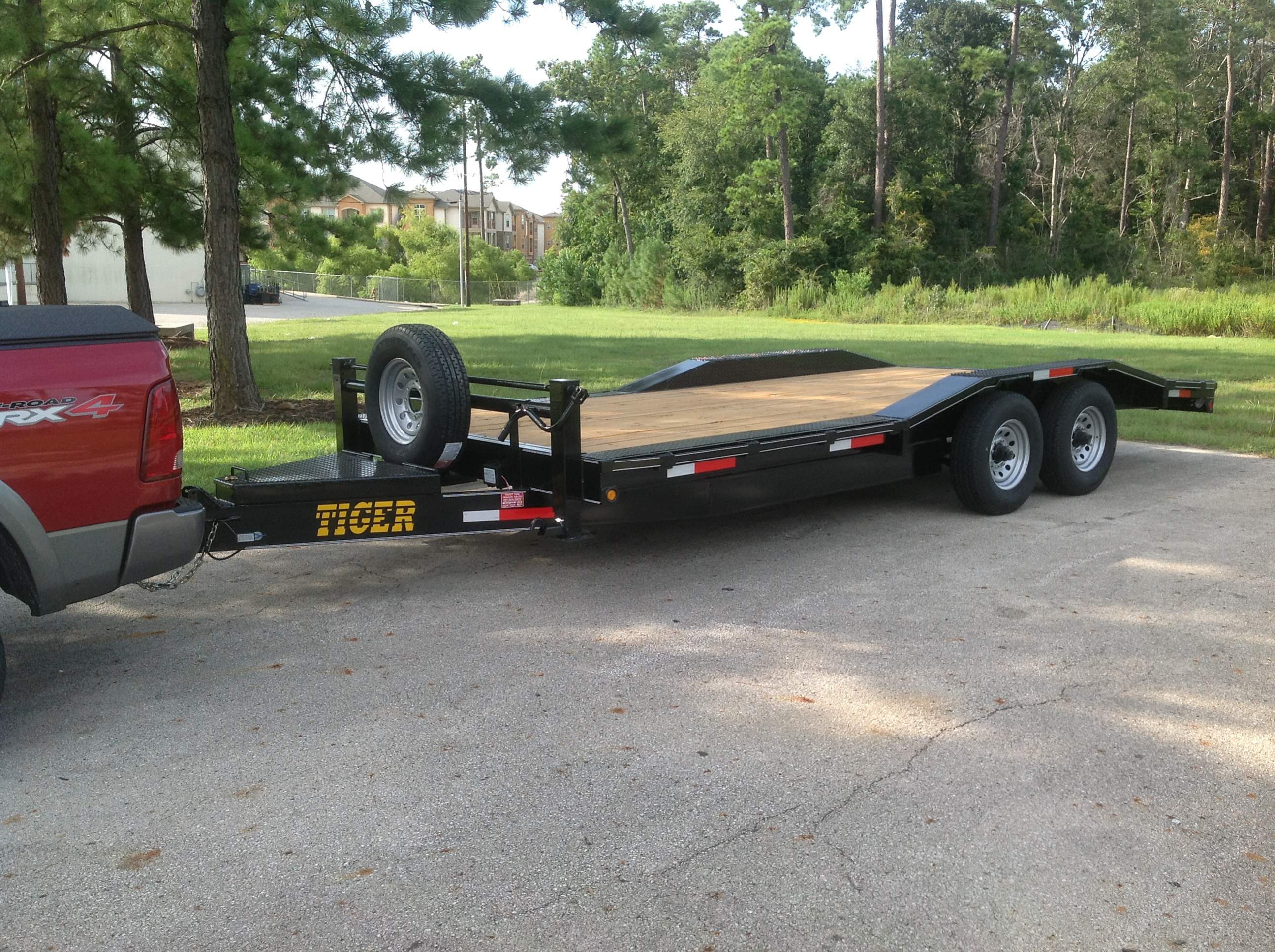

I wouldnt buy anything until you talk to Tiger Trailers. These are the most overbuilt trailers I have seen, and thousands less than Big Tex for what you get. My flatbed will haul anything that will fit on it. Its literally a 20K deck on 14K axles and it has two 6K gooseneck jacks on the nose. Trout trailer Sales in Porter Texas is where I got mine. They have prices on their website.
/ Car Hauler vs Regular Flatbed
Ii believe I have a tiger dealer in town here. How heavy is that beast? Currently only have a 1500 dodge to pull with.
/ Car Hauler vs Regular Flatbed #10
I believe its in the 3000 to 3500 pound range. That being said, its the best pulling trailer I have ever pulled. I dont feel it back there at all.
