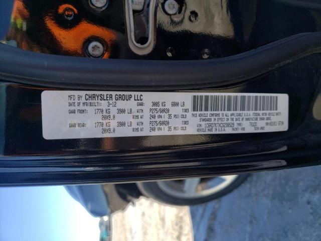

Being overweight and exceeding a "tow rating"* not listed on the trucks GVWR door sticker are very different. While I believe some newer trucks have started listing a towing capacity on the door sticker, a quick search indicates his truck likely does not have a tow rating listed.
As such a dual axle 7k GVWR trailer properly loaded would not overload his rear axle and there would be no overweight issues. Yes he might be slower going up hills than a similar half-ton truck with a larger engine, but as long as he has a good brake controller stopping will not be an issue.
*Unless a "tow rating" is listed on the door sticker it is not something for which you can be ticketed. Hot-shot drivers have been using 3/4 trucks to pull 20k and 24k dual tandem gooseneck trailers for over 20 years with CDLs, going through scales, etc, and as long as you do not exceed any of the numbers on your door sticker you are legal.
I am unsure what would happen if someone tried to bring a civil lawsuit if you exceed a tow rating listed in some kind of supplemental document published by the vehicles OEM but were legal on all axles and the numbers in the trucks door sticker.

This is very bad and dangerous advice. A 7k pound trailer (no matter how loaded) would very severely overload this particular pickup.
   / New to tractors and trailering them #19
This simply not true.
A quick search shows a 2012 Ram 1500 pickup will have a payload somewhere between 1,100 and 1,900 pounds depending on the configuration. A fully loaded 7k trailer (2x 3,500 pound axles) will have approximately 700 pounds of tongue weight (8-10% target for bumper pull trailers, 15-20% for gooseneck), leaving at least 400 pounds for the driver and stuff.
Depending on the hitch ratings a weight distributing hitch might be needed and a working brake controller is required for safely towing this weight.
