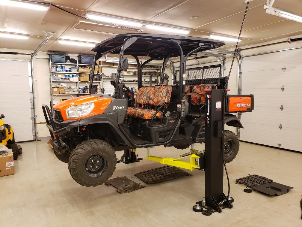

My son just put this in his shop. He knows his stuff and did a lot of research. Mostly for working on his old Bronco and GTO.
