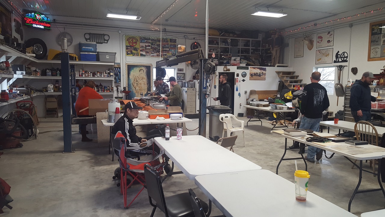

I have a Forward 12K 4 post with two air jacks. My three Sons each have 9K 2 post.
For them they prefer the 2 post. They do a larger variety of work than I do. But they still sometimes come and use my 4 post.
For me I prefer the 4 post. So much easier to load/unload. Great work bench for parts and tools. If cramped for space I can park on it, raise max height, and park another vehicle under it.
But the best part is that it makes a great Buffet table for family gatherings.
