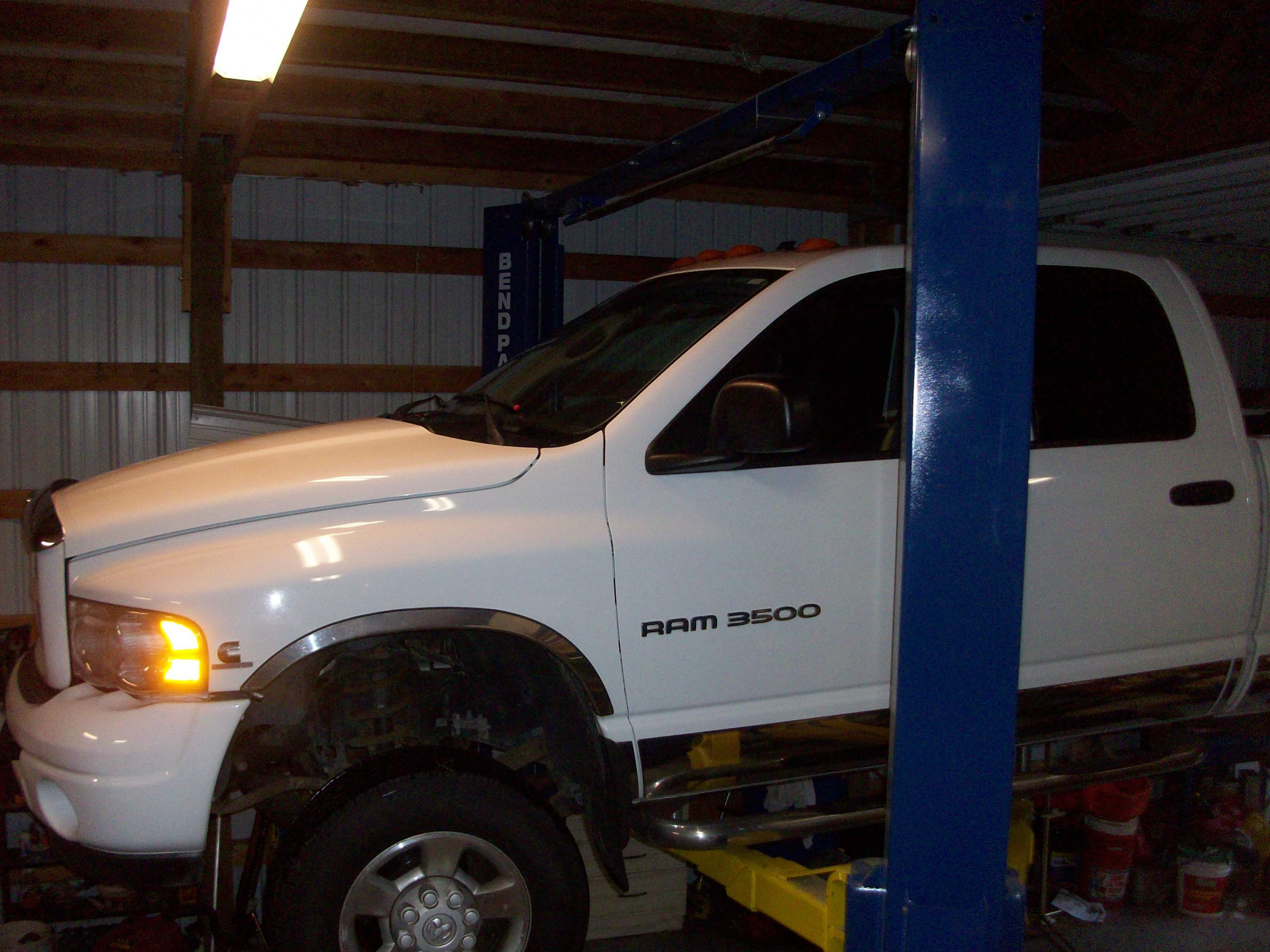

My son and I work on a lot of cars and trucks and went with a 2 post asymmetrical 10k lift.
If you anticipate the need to
remove a body from a frame-2 post
change a lot of tires and wheels-2 post.
front subframe removal -2 post
front or rear axle removal -2 post
There are attachments to get some of these jobs done with 4 posts.
If you can't change the concrete, A 4 post seems to make more sense.
For changing oil/filters or exhaust work in high production shop -4 post all day, no need to get on the ground and set lift points just drive on.
Very happy with my 2 post lift It gets used far more than I ever thought it would.
