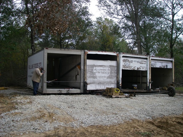

I agree with Eddie Walker....nothing fancy...
I just moved 4 containers (old truck bodies) on to a packed gravel bed at my property...used treated 2x6 "sleepers" layed flat under the boxes to maintain alignment and allow me to slide the boxes into position...
This keeps them a bit higher than the surrounding ground, promoting drainage and air circulation, allows easy routing of utilities and gives the skunks somewhere to live...
