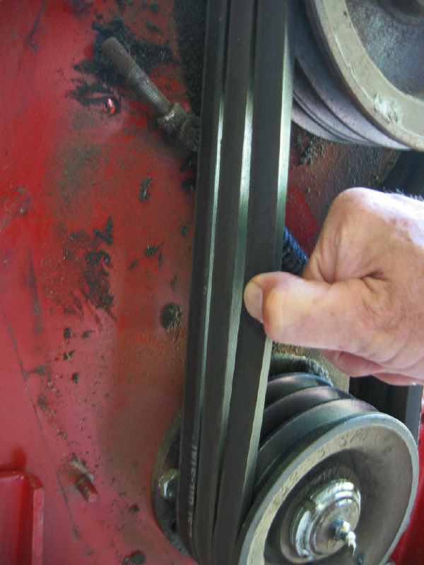

   / Caroni Flail Belt Failure #180
If I recall correctly I just loosened the tension idler completely then levered the new belts on. No problems doing so if memory serves. This is about how tight I got them. This photo was with the Caroni spring controlling tension.
(Note: during the hysteria about weak tension idler springs I replaced mine with a solid piece of heavy gauge wire/rod. I never went back to the spring though I was convinced that the rod made no difference as measured by tension (thumb test) or heat build up. If you are interested in details I posted those temperature measurements somewhere in one of these threads a couple of years ago)
