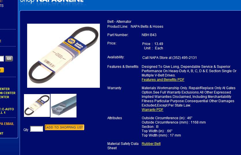

   / Caroni Flail Belt Failure #223
Here is what you need:
   / Caroni Flail Belt Failure #225
That link doesn't take me to a specific item.
Gates B43 single belt x3 is basically what you need.
   / Caroni Flail Belt Failure #226
3 Gates B43's, $50, and about 10 minutes later, I'm back in business.....
The belts were a bit tough to find, but I found 'em eventually.
Big thanks to whoever figured out the Caroni to Gates conversion, and to Island for his pic!!
I cranked the tensioner almost all the way, is that OK??
-Jer.

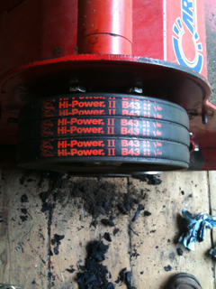

   / Caroni Flail Belt Failure #228
Here's a snapshot. I don't see Gates mentioned is why I'm asking.
attachment.php
   / Caroni Flail Belt Failure #229
There are a lot of companies that make B43 belts. I don't know who NAPA uses. Gates is a premium brand and given the issues with belt failures with the original Caroni supplied belts, I would recommend paying a couple of bucks extra (each) for the Gates. If you look at the photo I posted I think you can see the distinctive name (power something or another). These are just basic good Gates belts. They make even fancier types but I haven't had any trouble with the plain vanilla Gates.
