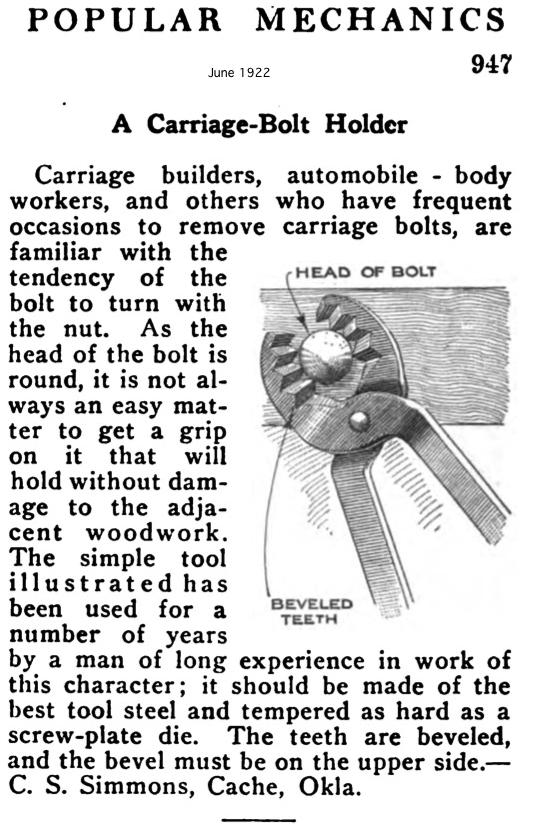

Nov 28, 2018 / Carriage Bolts. #21 bcp Super Star Member Joined Jul 8, 2009 Messages 14,988 Location SW WA Tractor Kubota BX2360 Here's a possible answer from 1922. Bruce
Nov 28, 2018 / Carriage Bolts. #22 Fuddy1952 Elite Member Joined Apr 17, 2018 Messages 4,332 Location South Central Virginia Tractor 1973 Economy and 2018 John Deere 3038E bcp said: Here's a possible answer from 1922. View attachment 580862 Bruce Click to expand... That's an amazing tool. You could modify an old pair of cutters like that. Interesting.
