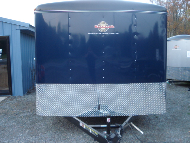

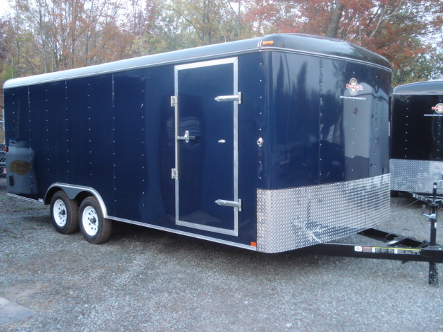

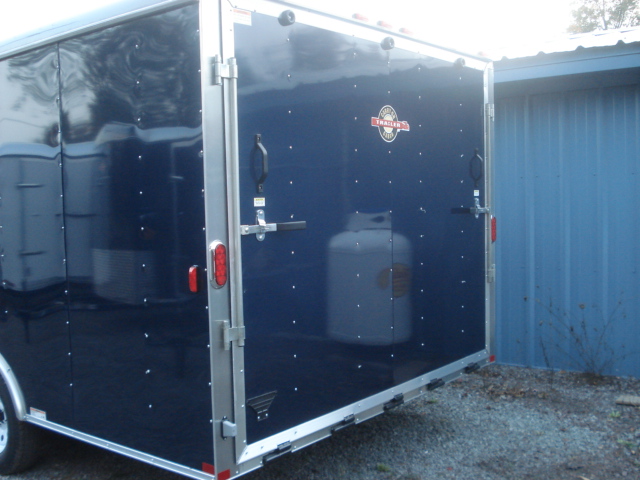

I am a Carry On dealer.
With that being said Carry On is a entry level trailer. (you get what you pay for)
They make a decent cheep trailer.
If your looking to haul across country get a higher end trailer such as a Car Mate or Wells Cargo.
You may also want to look into getting torque flex axles and maybe even bonded sides.
For a price referance....
I have a 20' 10k with beaver tail car hauler in blue for $5,695
