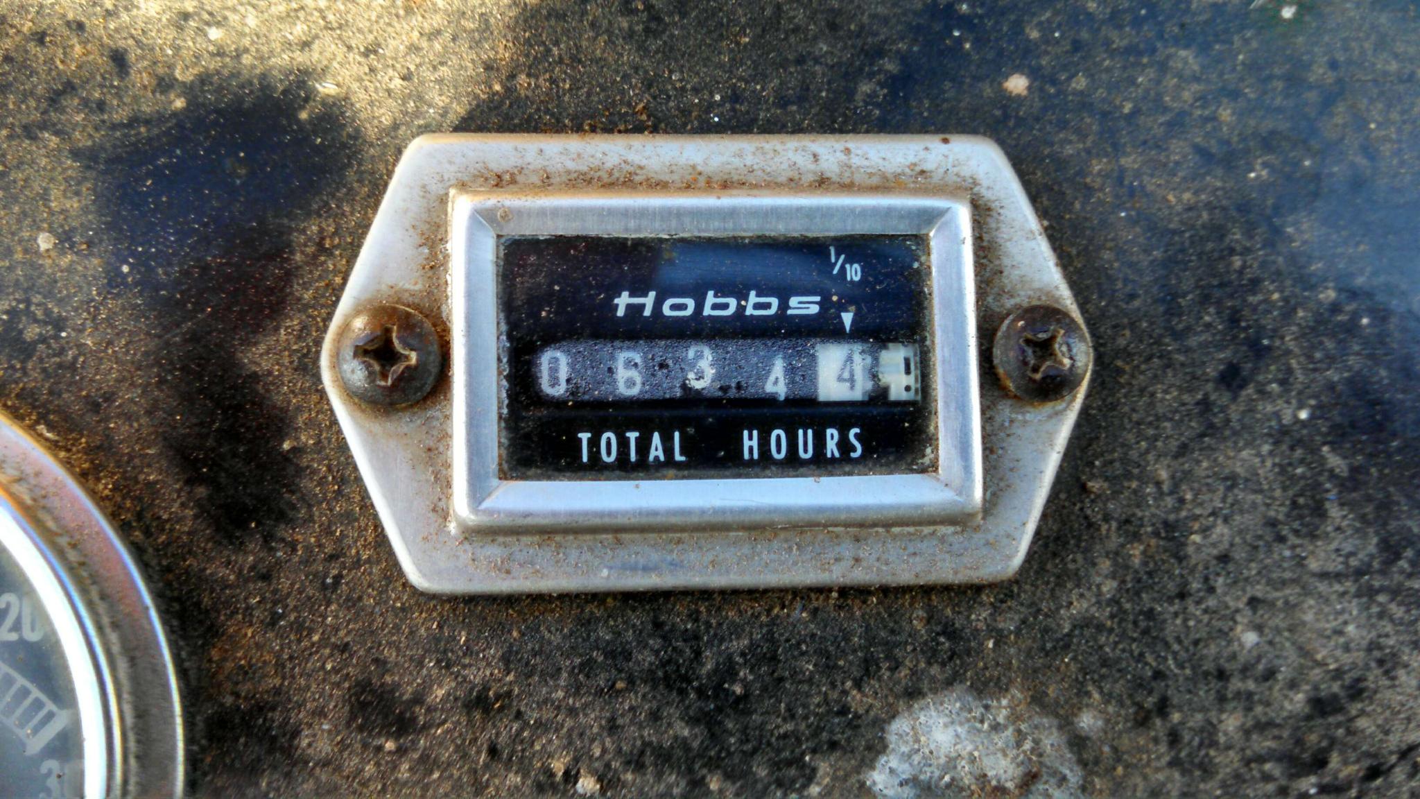

I have an opportunity to go look at a Case 648 that's for sale kind of close to me. The hour meter is showing 0634 hours (it's a 4 digit meter). The person selling it says it belonged to his father-in-law who passed away a couple years ago and he just doesn't have a use for it. It has 3 point hitch. back blade. Back weights. Chains back tires and he thinks it's a 1988.

IF...... the hour meter is accurate, then 634 hours on a 1988 would be exceptionally low. After all, this is a 27 year old machine. Are we to believe that it only saw an average of 23 hours of use each year?

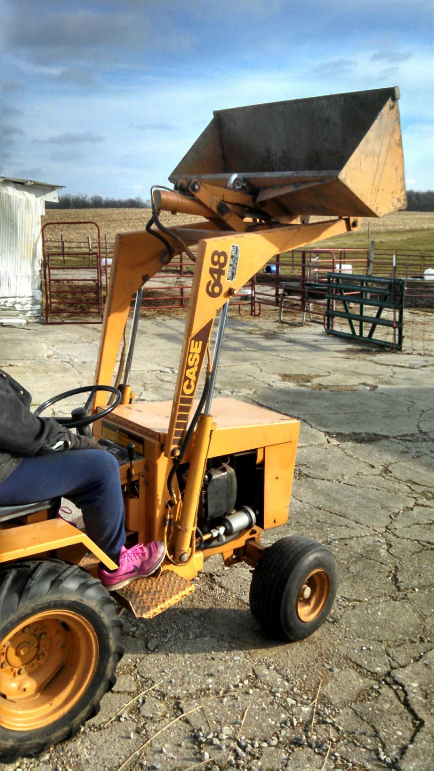

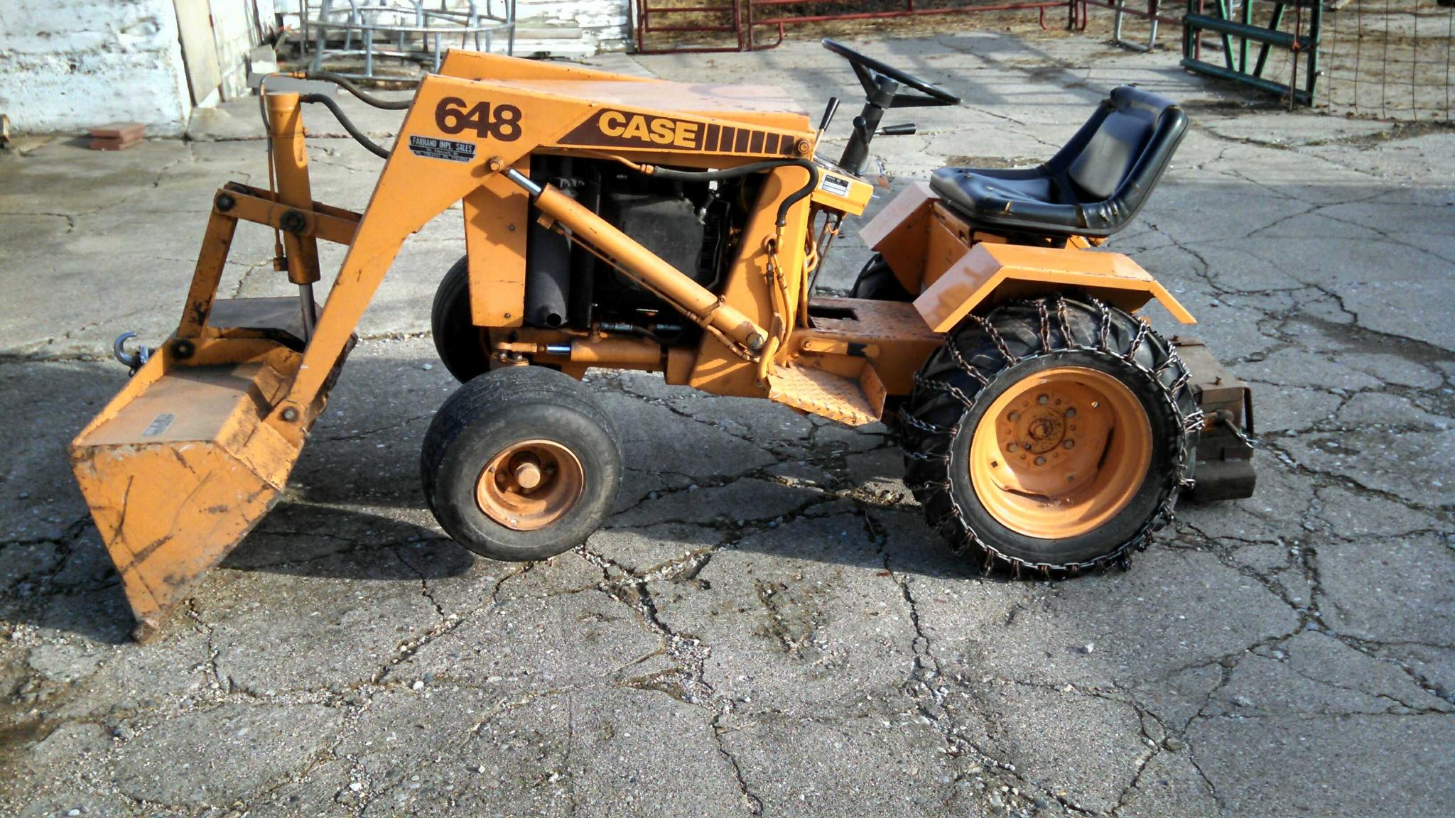

Anyways, here are the pictures that the owner sent me. He said it belonged to his father-in-law who passed away 3 years ago. And the he and his father-in-law kept it in the barn
   / Case 648 #6
I have a 648, and it happens to be a 1988 model. The one you pictured is not an 88'. If it were it'd say Ingersoll on the arm, not Case. It does look to have been well taken care of. The dash cover is missing, but that's very common on these hyloaders. I agree $3900 is too much money. I paid $2500 for mine a few years ago. They are tough little units though, and you wont regret buying it, as long as the price is right.

IT would appear that this tractor still has the original paint. Overall the condition looks pretty good. Hopefully, he has the dash tower panel that is missing in the 3rd photo. I cannot tell if this tractor is equipped with the rear PTO valve because of the poor photography cutting off the left side of photo 2. As I said before, it all comes down to how bad you need a loader of this size and how deep your pockets are. In my opinion, you will be paying a premium price at 3900 and I would offer him 3000 cash and wave it in front of his face in 100 dollar bills so that he knows you are serious. All he can do is say no and try to get you to raise your offer. Where you saw off is up to the two of you.
