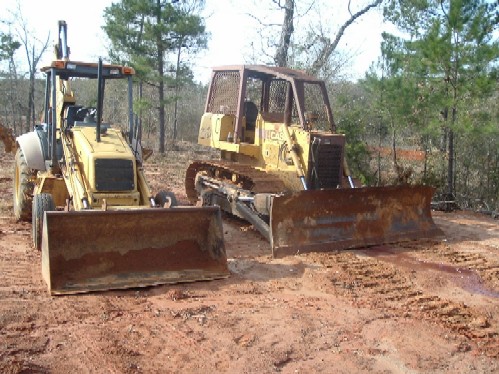

Everything is in it now and connnected. I primed the pump and motor with hydraulic oil and I'm ready to start her up.
Getting all those hoses back together was more of a nightmare than I had anticipated.

I didn't want the engine to start up right away in order to purge the lines of as much air as I could. Then when I thought I was ready, it wouldn't start.
My dad was in town helping me when I took out the pump and motor, so I called and asked if he had any ideas. It took him a day to think about it, when he remembered turning off the fuel petcocks.
Of course the batteries were drained and it took the night to charge them. This morning she fired right up. I ran her with the tracks off the ground for awhile and everything seems to be working.
I have one problem. The preasure warning light is on for that pump. It's what told me I had the original problem with the pump.
Could air in the line cause the sensor to read low preasure?

#29
Latest update.
I got about an hour into using it and all of a sudden I had a massive hydraulic oil leak. I filled the tank and couldn't find the leak. It had to be moving for the leak to happen. I got a friend to come over. He climbed into the small area that the pump and motor sit and I drove really slow forwards.
From the oil spray and wet hoses, I was sure it was a fitting on the pump. Nope. It was the main return line off the bottom of the motor.
I pulled it off and saw that the O-Ring had been crimped when I installed it. I replaced it and everything is dry and no more leaks.
I still have the warning light on for low preasure on the left track. Everything is working perfectly and it's running really strong. I worked it about 8 hours yesterday without anything coming up.
I'm out of ideas of why that warning light is on. Any suggestions?
Thanks,
Eddie

In your original post you said "My LH Drive Idiot light is on, but its always been on without any trouble."
Would it be possible (and not too diffucult) to swap the RH drive idiot light unit with the LH unit? At least that would tell you if the problem is in the light unit.
You also mentioned some paper and shavings in the hydraulic system. Could some of that have gotten into the pressure sensor or line to the pressure sensor that runs the light and be keeping it from reading the pressure?
