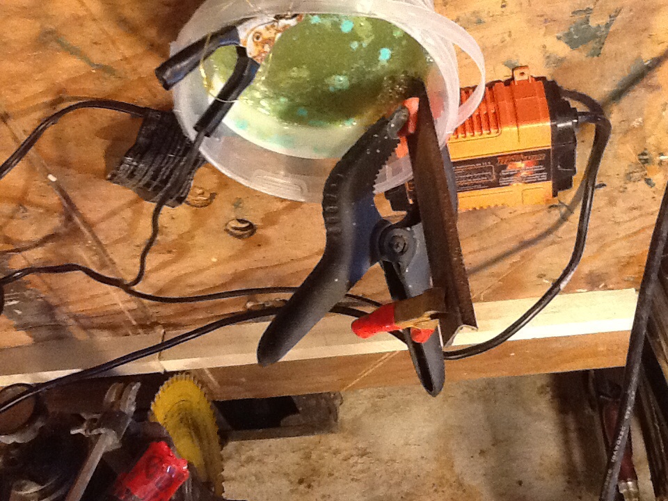

If it is rusty and not covered with caked on fats then electrolsys is the only way to go.
If it has a lot of cooking rime them lye first then electrolsys.
20 % to 30 % by weight lye to water and always lye into water never the other way round

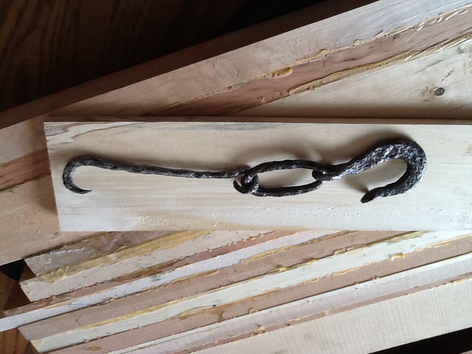

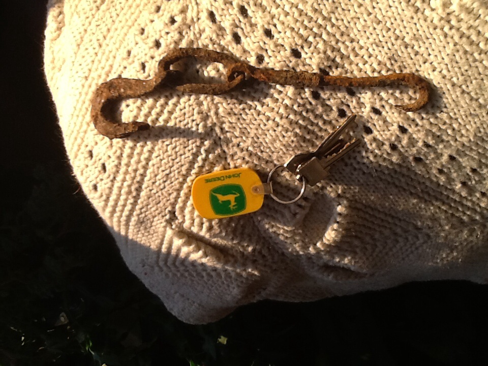

I did the electrolysis method and they came out looking pretty brand spanking new but for a scuff here or there. Did an excellent job.
